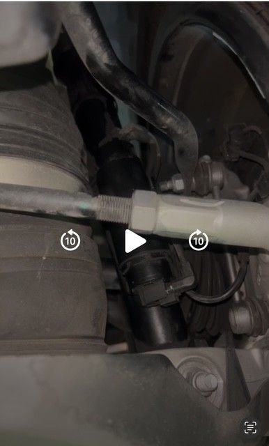

During my scheduled 40,000-mile service at Mercedes-Benz of Pleasanton, the technician documented the following issues:
  • Rear right shock absorber leak/film
  • Charging-port arcing
Both issues were documented within the 50,000-mile New Vehicle Limited Warranty period.
At that time, no repair was recommended and no warranty claim was initiated.
Later, at approximately 52,000 miles, Mercedes-Benz of Fremont re-inspected the vehicle and confirmed that:
  • The rear shock absorber leak had progressed
  • The charging-port arcing condition was still present
When I requested warranty repair, Fremont advised that Pleasanton should address the issue, since it had been documented while the vehicle was still within warranty.
Pleasanton then stated that:
  • The shock absorber was considered “normal wear and tear,” and
  • The charging-port arcing was “not abnormal.”
The dealership, Pleasanton, also verbally suggested that Electrify America charging equipment is the cause of the arcing but declined to provide this explanation in writing when I requested documentation.
When I asked where the Mercedes-Benz warranty defines shock absorbers or charging ports as wear-and-tear items, I was told that the dealership does not interpret warranty policy and that Mercedes-Benz USA (MBUSA) would need to clarify.

Shock is leaking
Shock is leaking

I also have had a charging port damaged at about 25000 miles that was not covered by the warranty. Since the damage is caused by a third party, not a failure of the design nor an issue with the manufacturing, it is not covered by the warranty. It would be the same if your fueling port was damaged by a pump.
The shocks are definitely a wear item, and while 50k miles is a bit soon for one of them to fail, it does happen. You might ask if you can get some sort of prorated expense on that, though you might have to contact the shock manufacturer for that.
I am not surprised that they are not going to give you a written claim that EA's charger damaged the car, they really have no way of knowing where you charge the car or when damage happened. All they can say is they see damage that was caused by a third party as arcing does not happen in the socket on its own. EA's lawyers would have a field day if they wrote something like that down. You would have to be able to say under oath that you charged the car at an EA station and observed that a) the car was fine before charging, b) the car was damaged immediately after charging, and c) you observed signs of arcing while charging. In my case, I have no idea when the arcing happened. Might have been an EA station, could have been some other charging station too.

I can't add anything profound here, but will say that the charging arc thing is tough. EA will point the finger at MB, and MB at EA. There's likely no way to know who caused it, when, or where. Always look inside the charger before you attach it to your vehicle at public charging stations to look for damage. As a customer, I understand how frustrating it is to be stuck in the middle holding the bag for both of them.
In general, a shock going bad at that mileage is not unheard of. Should be covered under MB warranty though. Many aftermarket warranties do not cover air suspension shocks--surely the reason is they go bad often.

This is original shock from MB. The problem is not wear and tear items and should be covered under warranty. However, I am being denied without any explanation from Corporate.
I would agree that a shock that is not explicitly excluded by the warranty is included in the warranty, in that it is a full bumper to bumper warranty with specific exclusions...

Air shock should absolutely be covered under warranty. Its covered by the MB extended warranty too.

Front struts are air spring and damper combined. Rear dampers are separate from the air springs.
