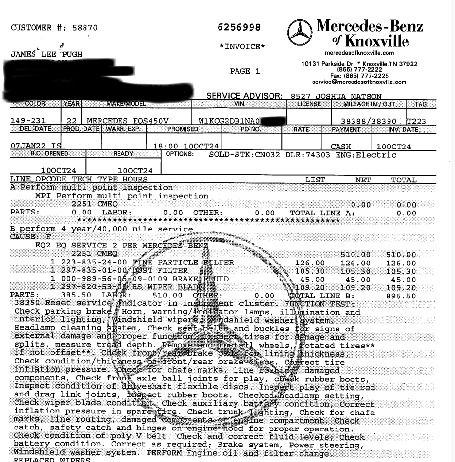

Parts wise, it just adds replacing wipers. It seems to include a more thourough inspection.

Generic description, lots of IC items. Expected to see door hinge, latch and sunroof lube nor any HV connections.

Well, you wouldn't want that door squeaking now would you?

Unless you have money to light on fire...anyone can do this service with the possible exception of the brake fluid which likely doesn't need doing anyway (checked mine in both EQ cars--still at 0% water). The filters and wiper blades are super easy to do. I'm skeptical that a tech on production did any of the component checking.

That's my sentiment as well.
Curious, did you test for any copper content in the brake fluid?

Not everyone can service a vehicle, but I'm happy that you can. I'm curious about the filter prices. The prices for my W213 filters were $24.50 (dust) and $65.00 (fine particle).

Service completed was slightly higher priced than above. One issue I had prior to servicing was a parking brake error that was random seemed to be gone. Way too pricey labor is insane.
