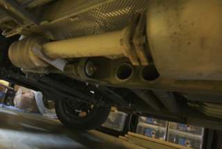

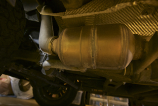

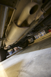

KJ6IRM's Avatar
Joined: Jun 2014
Posts: 24
2023 Rivian R1S (Sold 2011 G550)
Originally Posted by hubert
If you just changing the tips you won't need this adapter but if you want to change to G63 mufflers you will need this.
I don't think he'll need the G500 adapters. The G550 I believe has the same exhaust mounting points both the flange and the hangers as the G63. The best way to confirm this is check the catalytic converter part numbers to see if they match between the G550 and G63.
Originally Posted by myfirstg500
The exhaust system for the G550 is the same as the G500.
I can tell you that they are not the same. There is no crossover point in the exhaust. Each cylinder bank has their own independent exhaust system then ends in a dual tip muffler on the outer side of each frame rail. See the pictures form my 2011 G550. That diagram is incorrect, it is probably just a generic exhaust diagram that MB continued to use for the G550.
Attached Thumbnails 2013 G550 Exhaust AMG conversion-dsc_5752.jpg   2013 G550 Exhaust AMG conversion-dsc_5755.jpg   2013 G550 Exhaust AMG conversion-dsc_5756.jpg

Old Dec 9, 2014 | 03:32 PM
myfirstg500's Avatar
Joined: Oct 2011
Posts: 34
From: Chicago
g500
From the pictures that KJ6IRM provided. The exhaust looks like it's laid out similar to the G63.
In that case, you should be able to just get the OEM AMG Mufflers with the tips and attach it at the flange.
