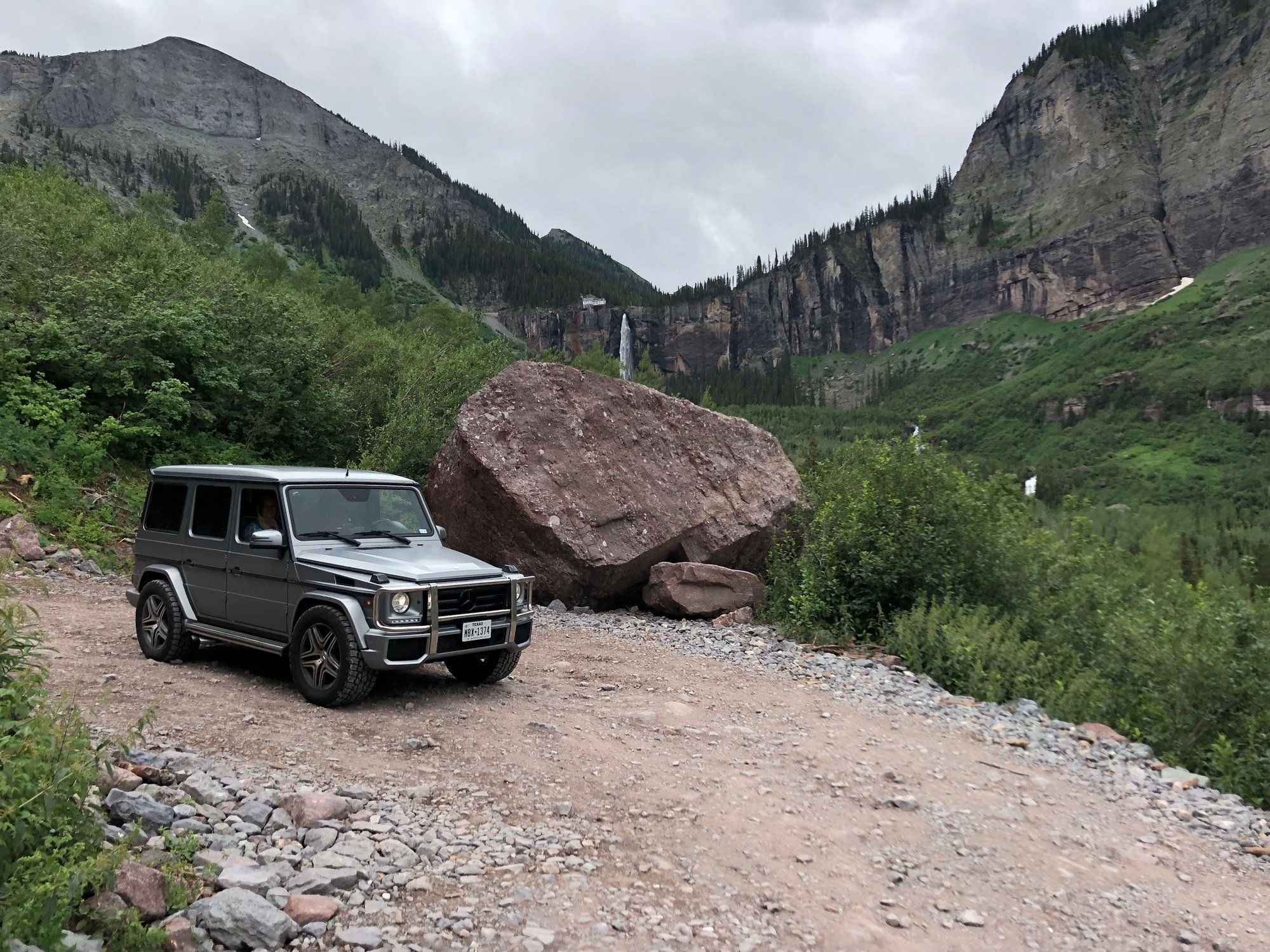

305's or even the narrower 285's will fit on the oem 20's..... if you go 305's you'll likely need to use spacers to get clearance..... either should have them to widen stance imho....
this is with the 305's on OEM rims
w/ 31mm spacers...

WOW they look great!!! Do you see a large decrease in MPG with 305??
Beautiful country is that Texas or Colorado??

I don't really see much change in MPG - but it's miserable to start with ! that was in Telluride on a Xcountry road trip to seattle and back... we also took it out in MOAB on some light trails but had out new puppy with us so couldn't play too hard...
the wider stance, mild lift and wider tires plus the fox shocks make it an utterly different handling vehicle. I tried 35's but didn't like the ride and they just barely rubbed.... and ironically the 305's are much wider ( quirk in Toyo's sizing matrix it seems...)
as it stands now it's maxxed for width without any rubbing on full articulation, and with the 40mm spacers I didn't need to do brake /locker lines or worry about caster etc...
E

I read your post about lift kits and your summary. Is this your truck without the lift? The 305's seem like they are pretty full under the fenders and may not allow for any flex. Just wondering. Nice Telluride photo BTW.
