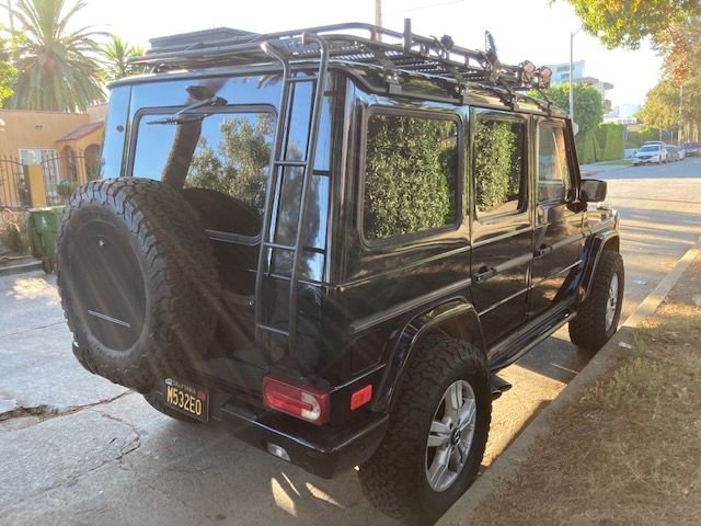

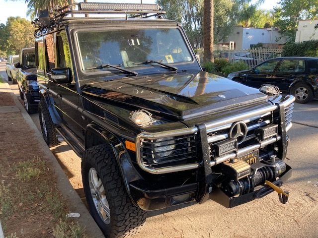

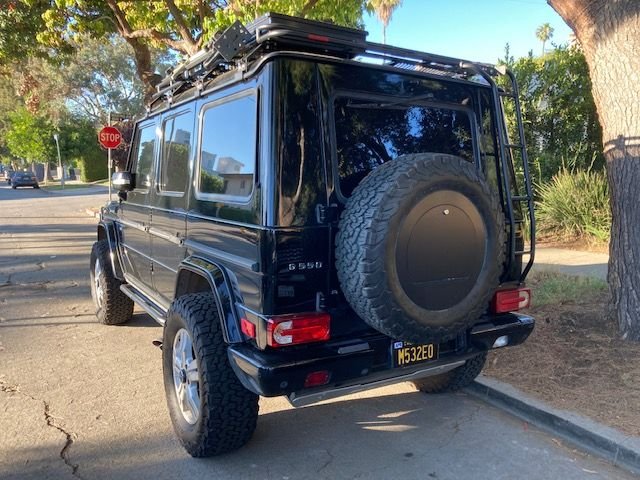

It's been a while since I posted on this thread so I figured I'd post an update. I ended up increasing the tire size to 305s and changing the 30mm spacers to 50mm. In addition, I put on reinforced front and rear panhard rods. The tires feel great although they do rub a bit at full turn. I also added a Gobi Stealth Rack and some Rigid Industries lights. Love the rack and love the lights, but the wind deflector that came with the rack won't fit due to the antenna so I'd like to move it. Anyone have any suggestions for where to put the antenna?

Looks great! How tall are the tires/what kind of lift are you running?
Also, how was the process of mounting those lights up front? I'd like to add a pair of 8 inch lamps to mine. The brush guard strangely doesn't have mount points for them. How hard was it to wire up?

I switched out my ORC coil springs for THOR Motorworks springs (https://vikingoffroad.com/g-wagen-coil-springs/) about 6 months ago. Around the same time I also went from 275 K02s to 305 K02s.
With regards to the lights, there is a place in LA called Dirty Parts who installed them for me. They mounted the brush guard lights with horizontal bar light clamps and I've had no issues with them.

Thanks for that. So the only change you made to the suspension was the springs? Any rubbing? Did you have to use spacers?
