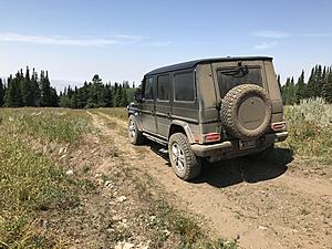

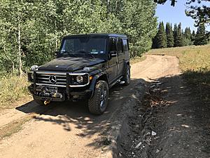

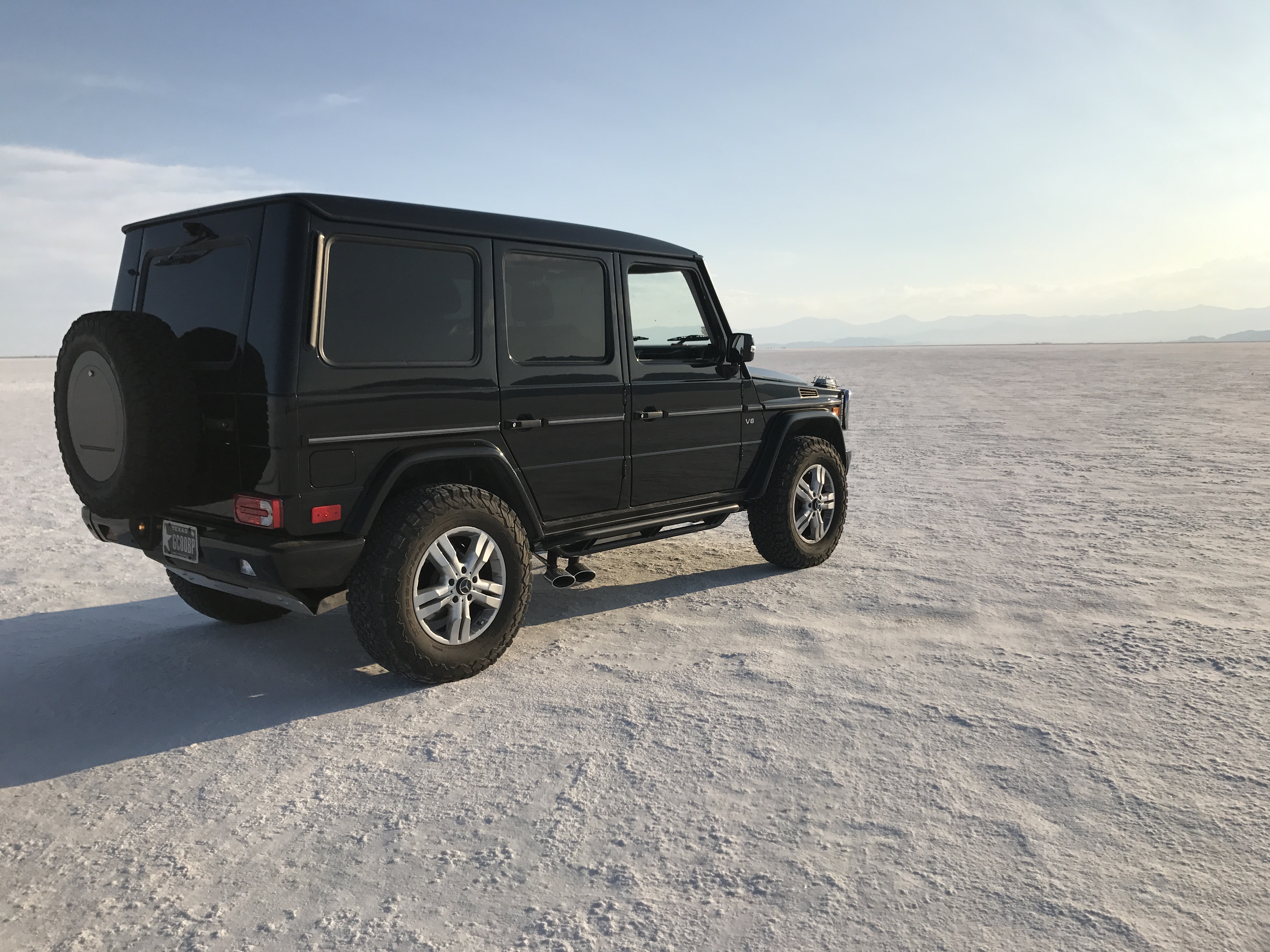

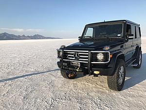

I have BFG K02s on my 2010 G550. I kept the stock rims so the dimensions are 275/70/18 all around. I also have a 40mm lift via an ORC/Bilstein setup and 30mm H&R spacers.
Without the lift, I highly doubt there would be clearance with the larger tires. It's close as is. If you do decide to lift yours, strongly consider a sway bar. The only one I could find is made by ORC but I drove my G for a little bit without it on the freeway and there is an uncomfortable amount of body sway at higher speeds.
Attached Thumbnails 35" Tires on 2009 G-500-img_2867.jpg   35" Tires on 2009 G-500-img_2957.jpg   35" Tires on 2009 G-500-img_2866-1.jpg

Nice, you've done exactly what I want to do to mine. So, you got a thickened sway bar, front and back? End links too? Longer brake lines? No rubbing with the wheel spacers?
I have the same spare tire cover as well, any issues with the increased weight of the spare?

Sway bar only in the back. Longer brake lines in the front and a Brembo Big Brake kit on the back. I have additional rear lines that are supposed to go on the rear but they won’t fit for some reason. And no rubbing with the wheel spacers.

The winch, tray, sway bar, Bilstein/ORC suspension setup, stainless steel brake lines and Kleeman ECU flash came from Viking Offroad (www.vikingoffroad.com)
The VTS wheel cover, differential covers and transfer case cover came from www.g-wagenaccesories.com.
The H&R wheel spacers, brush guard grilles and black wheel center caps came from www.fourbyfourclub.com
The rear Brembo brakes came from www.racetechnologies.com (one of Brembo's US distributors) who sent me to Supreme Power Inc. (www.supremepower.com) for installation
The rock sliders, front & rear underride protection and turn signal guards came from GfG (Gesselschaft für Geländewagen) at www.gfg-shop.de/gb/
I got the tires from www.fourwheelparts.com and a few other random parts from ORC (Off-Road Center) at www.orc-shop.de/en/
In addition, I purchased some OEM items off eBay and other smaller more generic items off Amazon.
Www.gwagenparts.com has a wide selection of items but I never actually purchased anything from them. However, I have met with an employee of the company to look at my G and he was very helpful.
Let me know if you have any other questions!

All great info, thanks. Why go with the rear Brembos again, just because the other brake lines wouldn't fit? Were those the ones supplied by Viking?

The brake lines were from Viking who import them from ORC I believe.
The rear Brembos are strictly to have more stopping power (larger calipers and bigger, two-piece discs). I only got the rears because Brembo doesn't make fronts small enough to fit my 18" rims although that may be changing soon.

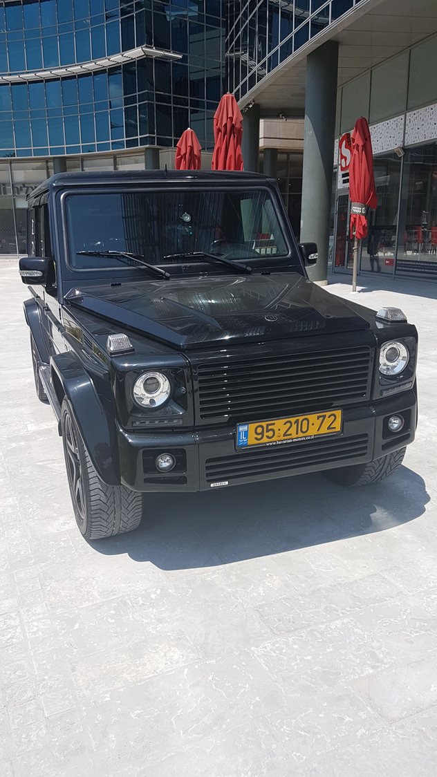

Hi All, Just to update I have installed a 40 m"m lift spacers, and 275X65X20 tires (34.2), got into 2 problems. The original springs just colapsed, and started to rub the bump stom, also the tires started to rub the radius arms when turning. I changed the lift spacers to 50 m"m spring lift from Old Man EMU, and returned the tires back to original. I ordered and waiting now for wheel spacers H&R, and hope for best.

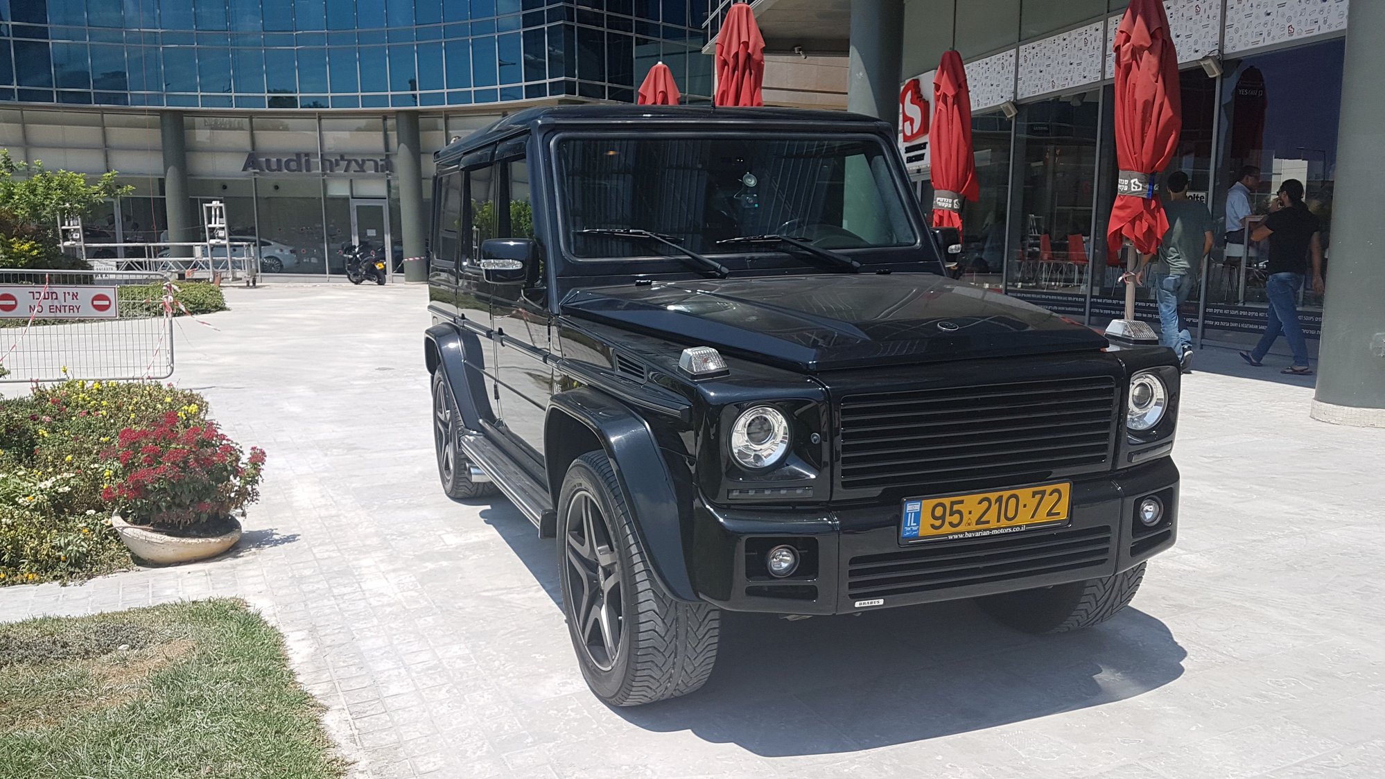

Finally got the H&R wheel spacers, 30 mm, installed the 275X65X20 , 34.4" tires, with the 50 mm lift springs from old man emu. Everything works just great, even tested some offroading today.

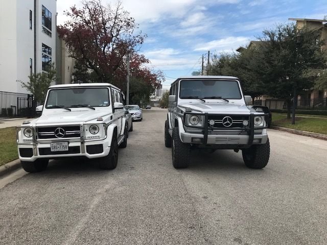

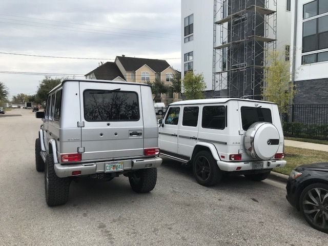

I am running 35x12.5r20s with about 4.5" of lift or so. It was a lot more to go to this level (with King external reservoir shocks, the military trailing arm brackets, king steering stabilizer (which does not exactly bolt on btw), and more, the list goes on) from a 40-50mm lift. It will be going back in January for more tweaks to tie up some things for offroad. That being said, even at this level I had to add Viking Offroad 1.25" bolt on wheel spacers to prevent rubbing on the trailing arm.
Looks the way I like it,
I had to do most of it in my Jeep Wrangler with 5" lift. with the merc I plan only some soft offroading
What year is your car? I lost some engine power changing to the bigger tires

It’s an 02; a eurocharged tune helped a good bit. It’s good 0-50 or so heb it runs out of juice haha

Nice set up, that's a pretty high lift! What kind of offroad lights are those, and where did you get them?

Update...
Just had 365mm Brembos put on the front. Brembo didn't make front brakes to fit the OEM 2010 rims so it took about 6 months for them to engineer it but they finally got it done. Supreme Power in Fullerton, CA installed them.
As for some of the other parts... The dust covers on the front two ORC/Bilstein shocks melted on to the cats. The turn signal guards and the rock sliders purchased from GfG have started to rust a little bit. A screw broke on one of the brush guard grilles but that's about it after many miles of on-road and off-road traveling since my last post.
Old May 10, 2018 | 10:46 AM
Limey Hooligan's Avatar
Joined: May 2017
Posts: 459
Likes: 301
From: Plano, Texas
2012 G550 - Capri Blue Metallic
Thanks for the update on how your mods are doing. That's a little disappointing that you have some rust already...
Nice upgrade on the front brakes! How much of a braking improvement is it? I imagine the braided lines help some as well. So is this a one-off custom build, or does Brembo offer this size brakes that you can buy and adapt for the G?
Receiving some of my parts (shocks, springs, spacers) this week to get ready for my build here pretty soon. I'll probably start a new thread, though I don't think I'm doing anything you haven't done already.
