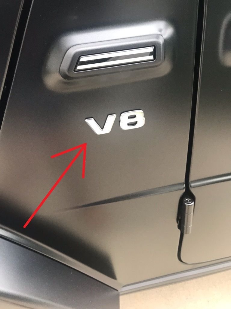

Hi everyone, after loving my wife's white G550, I got a matte black one. I've got all the chrome removed and it's down in CA getting those parts Black Chromed.
Question, has anyone removed the chrome "V8" and the "G550" letters off their 2019 Matte Paint Gwag? I've done it with fishing line and wax in the past but that was on gloss paint.
Any assistance would be appreciated, don't want to f**k up the finish.

You gently heat the letters with a heat gun, stage I, and they will peel of. The remaining glue you remove with citrus spray.

Using the heat gun (stage I), take your time, let the heat slowly build up. Keep a distance of about 8" and move in a circular motion. Use a soft tool, stick it behind the letter and pull softly. You will feel when they are ready to go.
