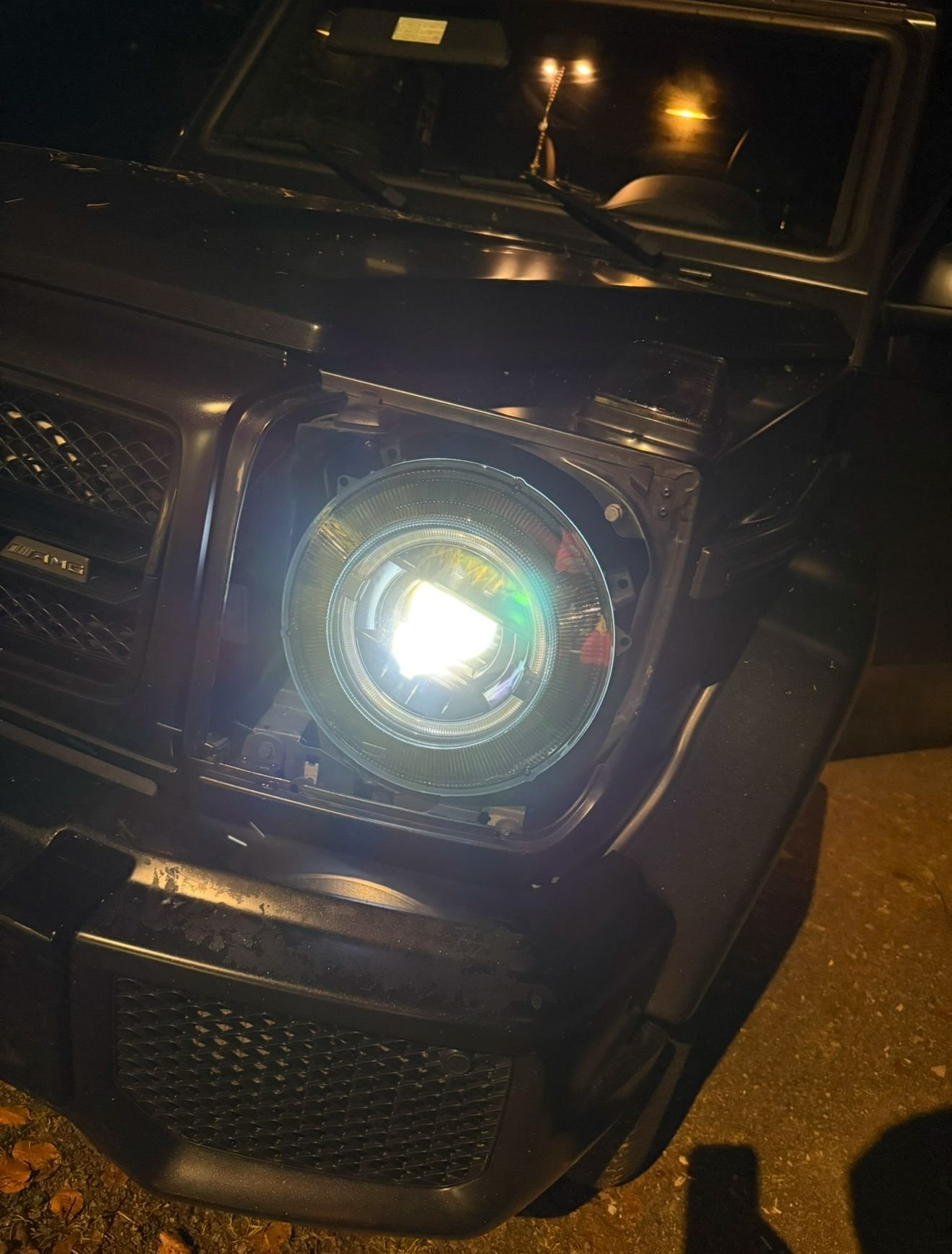

Can you post a pic of the headlight output?
Do you find it better than the stock HID setup?
link where purchased?

I know not directed to me but I bought a set of LED headlights for my 2011 G55 and will share my experience. I got the black housing version. I purchased from the link below and lights came in about 10 business days to Alabama
US $440.00 | W463 head lights with LED. (old to new) fit for G class W463 2008~2018y
https://a.aliexpress.com/_mK3ioIb
Set works really well. The cover is made of plastic so I am getting get mine covered with PPF when I have my 63 conversion done. There was one that during install noticed some condensation at the bottom and is seen in a pic below. It has not spread or come back sick install about 3 weeks ago.
The DRLs work as a plug and play on my car, others could vary. They turn on automatically with the car. I do wish they lit up when unlocking the car like the original 194 bulb. They are very bright and like the new model.
There is a yellow wire you can hook up to the turn signal. This will the allow the DRL to switch to amber and have a dynamic turn signal. I didn’t wire mine that way at first but since have. I will get a video soon and post it. I am thinking to undo as I feel it’s so busy with its dynamic movement and large size coupled with the fender and side mirror turn signals.
The actual LED headlight is very bright and cast a nice wide beam. I feel perhaps a little hot in the middle but still does well. It has a razor sharp cutoff. The high beams do well and are perhaps 50% better than stock. Sorry I didn’t take before and after pics like I typically do. I might do so when or if I undo the turn signals.
Adjusting the lights is a bit of a pain but not that bad. You have to unbolt them, adjust and place back on the car. Just slows you down some.

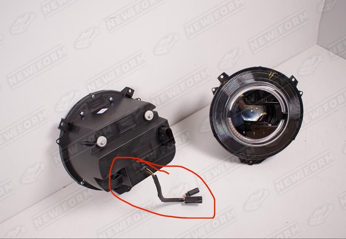

So, I just installed these on my 2011 G55. I had them ceramic clear coated prior so they don't turn yellow/fade
I too found out that I had nowhere to connect this connector and now have Left and Right Parking light warning on my dash.
Anyone know how to take care of that? I was thinking about getting set of resistors to plug in to deal with warning message. I did the same when I deleted fog lights with G63 Bumper upgrade

Yes, that will work but get power resistors that can dissipate the heat, and target the same power draw that the "drl" bulbs draw. You can get connector pigtails for the opposite side of that connector to make it all plug and play.

Perfect. Do you have any suggestions what to get? I think these are H10 connectors, right?

Hi all,
I recently purchased GBT headlights for my 2015 G63, and I’m encountering an issue with the halo ring. I’m unsure where to connect the module that came with the new headlights. My original factory headlights were equipped with xenon and had two sockets. I connected the two cables to the corresponding sockets on the new GBT headlights, but while the xenon light works fine, the halo ring does not light up.
It seems the halo ring isn’t working because the module isn’t connected, but there’s no available connector to hook it up. It appears that an adapter is missing to connect the module that came with the new headlights to the car’s wiring. (I’ve attached photos for reference.) I’ve searched online but haven’t been able to find the correct adapter.
Could someone guide me on how to properly connect the halo ring module or suggest any troubleshooting steps?
Thank you for your help!

Does that need to be connected to the wire for the original 194 bulb, that is the parking lamp?
