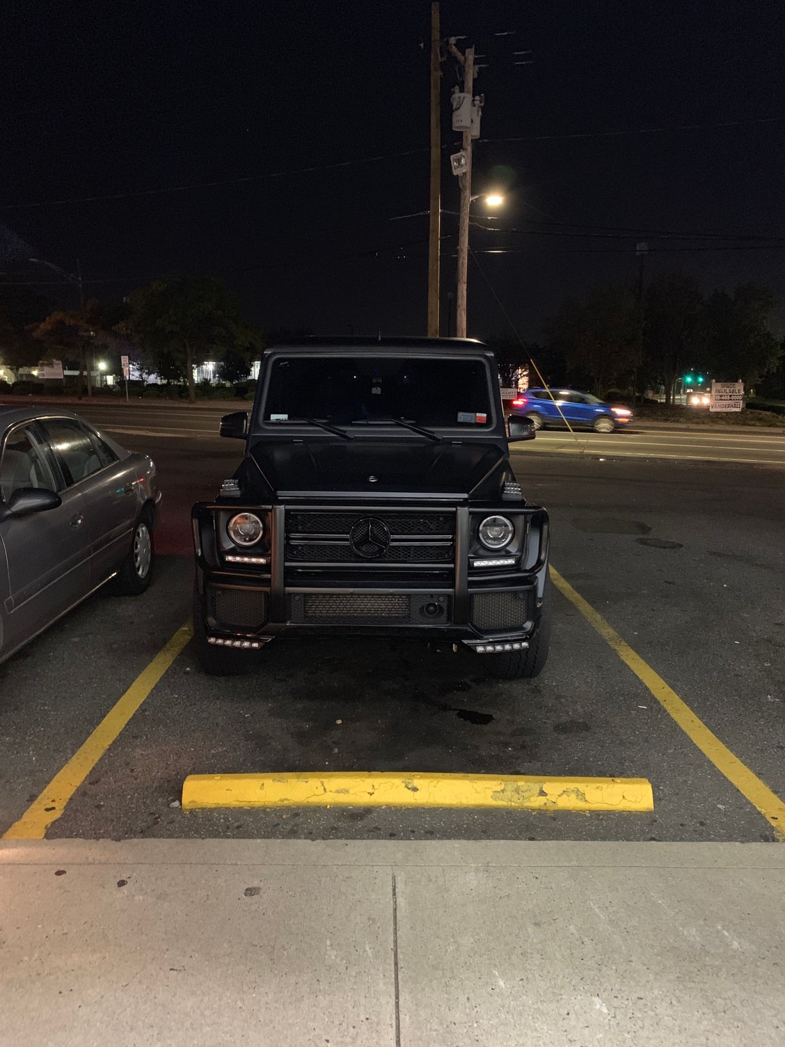

I think i have decided to go with these.
I hope the LEDS last I remember 3 years ago on my at the time new 2016 Highlander they released these cool LED style taillights and within a few months they were destroyed by LEDs that burnt out.

Well managed to get them installed. Tapped into turn signal to make them work as turn signals.
They work great however when the engine turns on the white rings shut off. They only come if I switch the parking mode lights on by setting the headlight switch in the position.
Everything else works

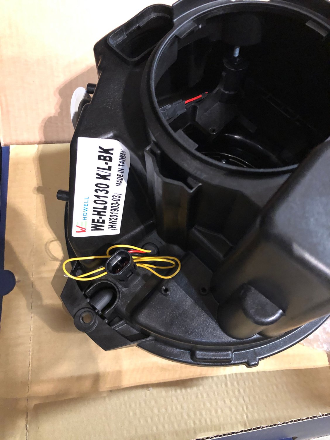

Hi - I’m trying to put these same halo headlights into my 2017 G63 and has a couple questions for folks who did the install themselves.
1) on the new headlights I have, the plug for the halos are where the little city bulb goes on the OEM (the plug at 6 o’clock ). My city bulb never seem to come on with the headlights...so are folks hooking up the new halos with the existing halo drl? Or using the same city bulb harness... I checked with a volt meter and only get 5 volts coming out of that harness

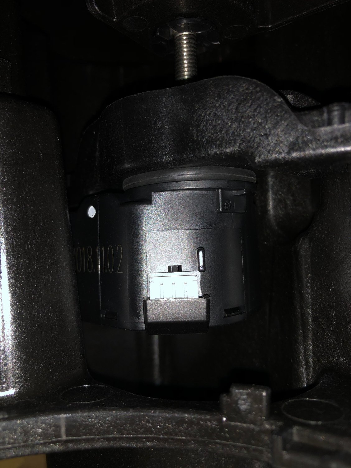

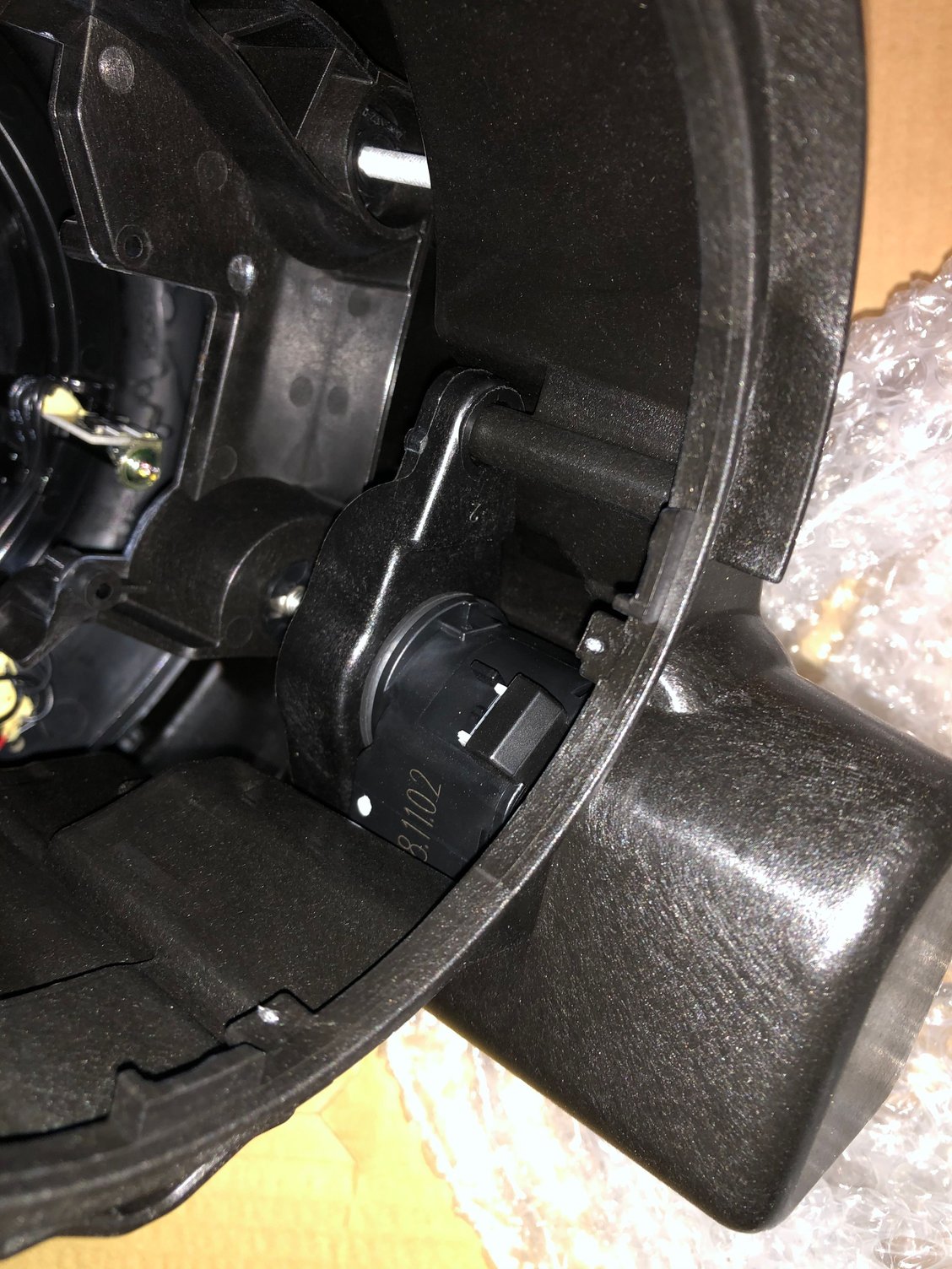

2) while trying the swap out the existing xenon parts from the old headlight into the new, how does one disconnect the self leveling wires ( 3 wires) that seem to go into a cylinder where I cannot see any harness to unplug....while on the new headlight, it looks like there is a three wire harness for the self leveling function...

here are some pics from the new headlight to give folks context of what I’m asking!! I’m pretty familiar with this all as I had converted an older g550 to a g63 bumper ... and now recently have come back with a 2017 G63!!
first pic is the socket that runs the led halo... where if I connect the same attachment from my light it doesn’t work ( only get 5v coming out of the factory harness )
the next 2 pics are what I believe to be the self leveling thing, and it’s connector.... but on my oem headlight the three wires run inside that cylinder and it’s not a plug like in the picture!
