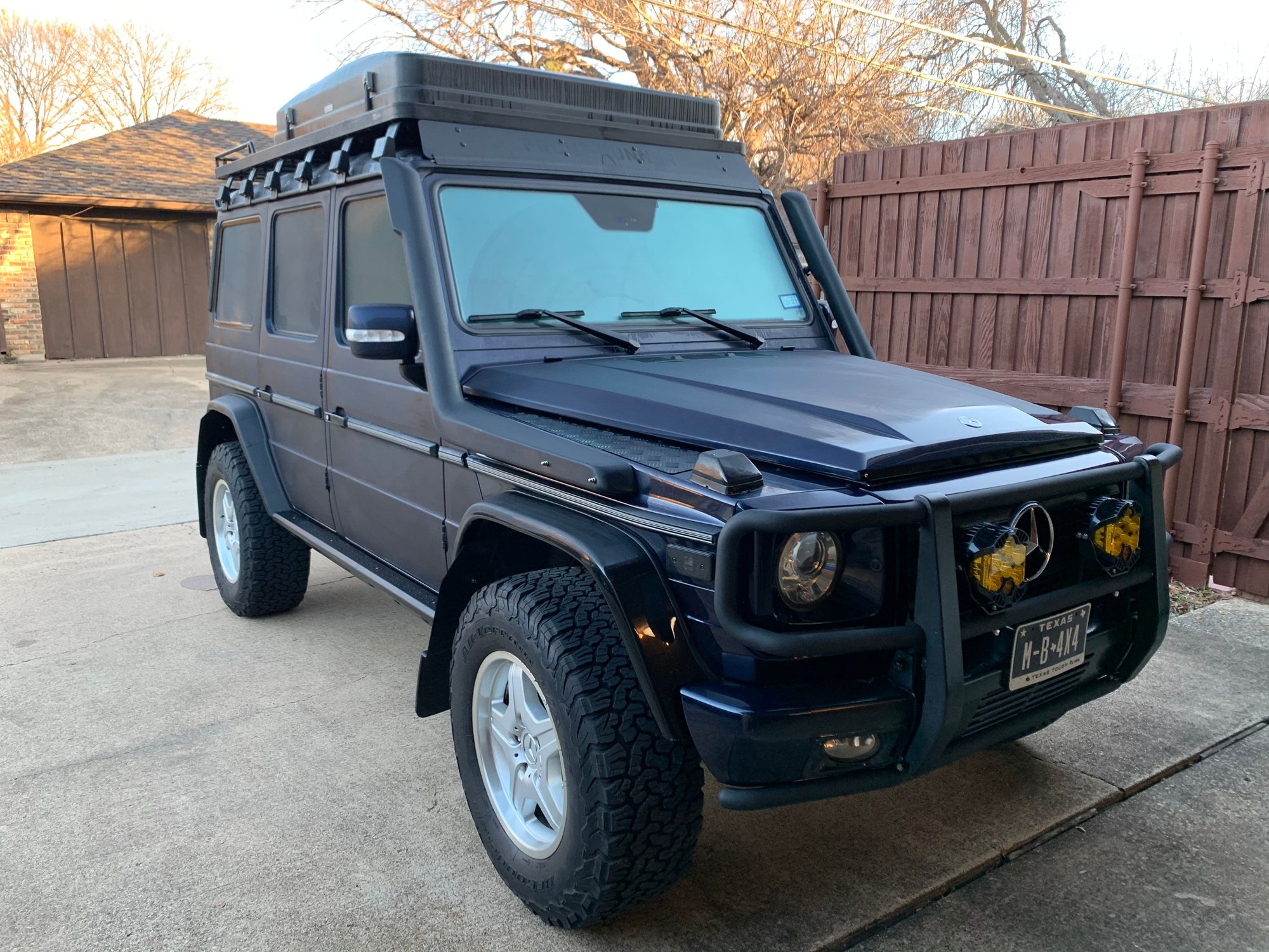

Old Aug 25, 2022 | 12:52 PM
  #54
Limey Hooligan's Avatar
Joined: May 2017
Posts: 459
Likes: 301
From: Plano, Texas
2012 G550 - Capri Blue Metallic
Old Dec 30, 2024 | 05:39 PM
  #55
vandreuc's Avatar
Joined: Dec 2024
What size are these tires? Stock suspension?
Old Dec 31, 2024 | 08:55 AM
  #56
Joined: May 2017
Posts: 459
Likes: 301
From: Plano, Texas
No, it's a 3 inch lift with 305/65 R18 BF Goodrich KO2s and 50mm wheel spacers.
