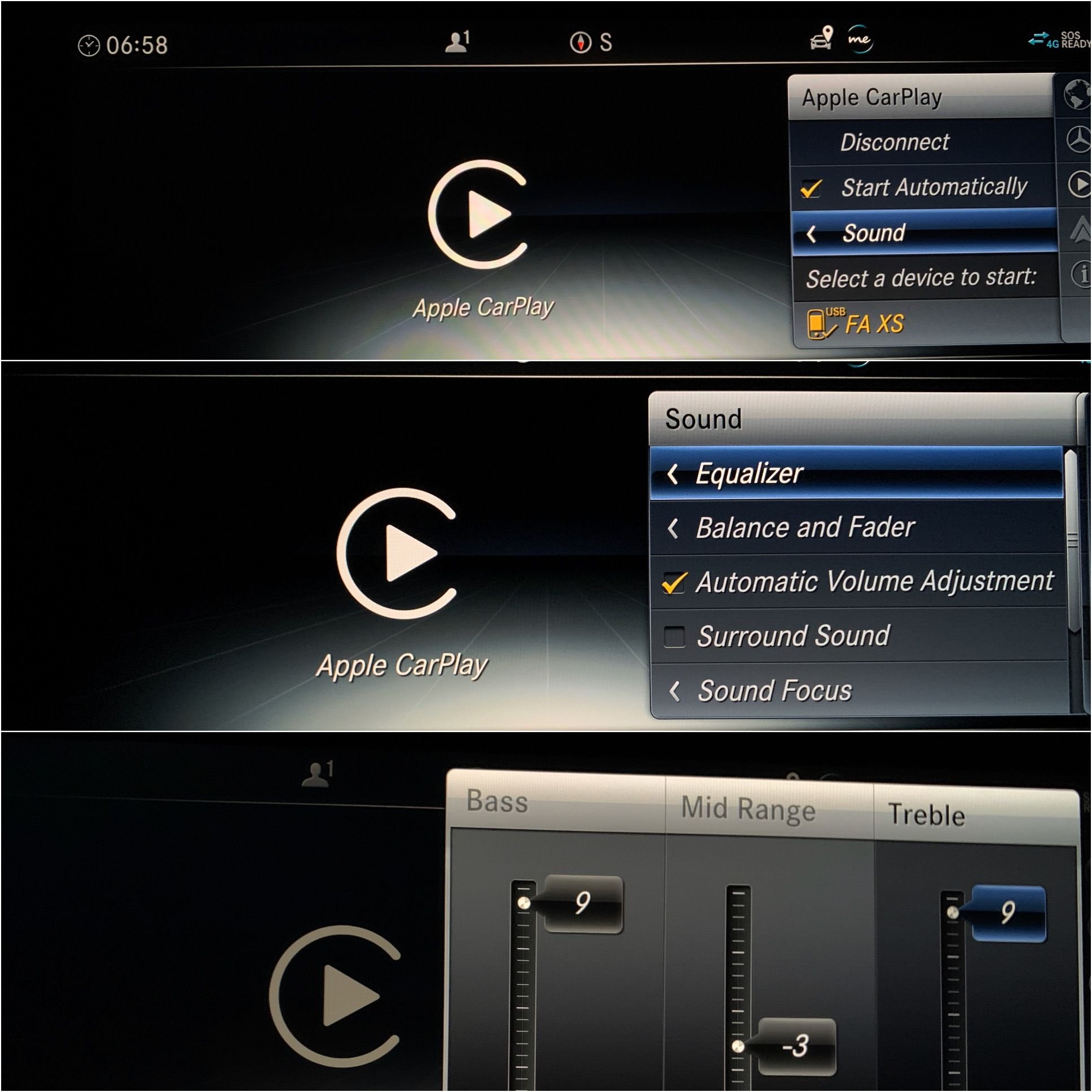

No issues here. I actually experience a sharper and clearer sound while connected through USB apple CarPlay.
make sure your equalizer settings on iPhone under settings isn’t activated as otherwise it might be the factor. Secondly, go in the audio settings for Apple CarPlay and adjust the treble / bass surround etc. I have it setup a way which is fantastic without surround sound on. Surround sound makes it more artificial and spacial that I don’t like. My burmester sound settings in my Porsche 911 are the same without any any surround sound. Burmester audio systems sound better without surround IMO.

first connect your iPhone and make sure CarPlay is on.
Vehicle settings, sound, equalizer (see pic)
Hope this helps!

Thanks this solved my problem. The surround sound being selected seemed to distort the audio. Unselected sounds much better. Thanks again!
