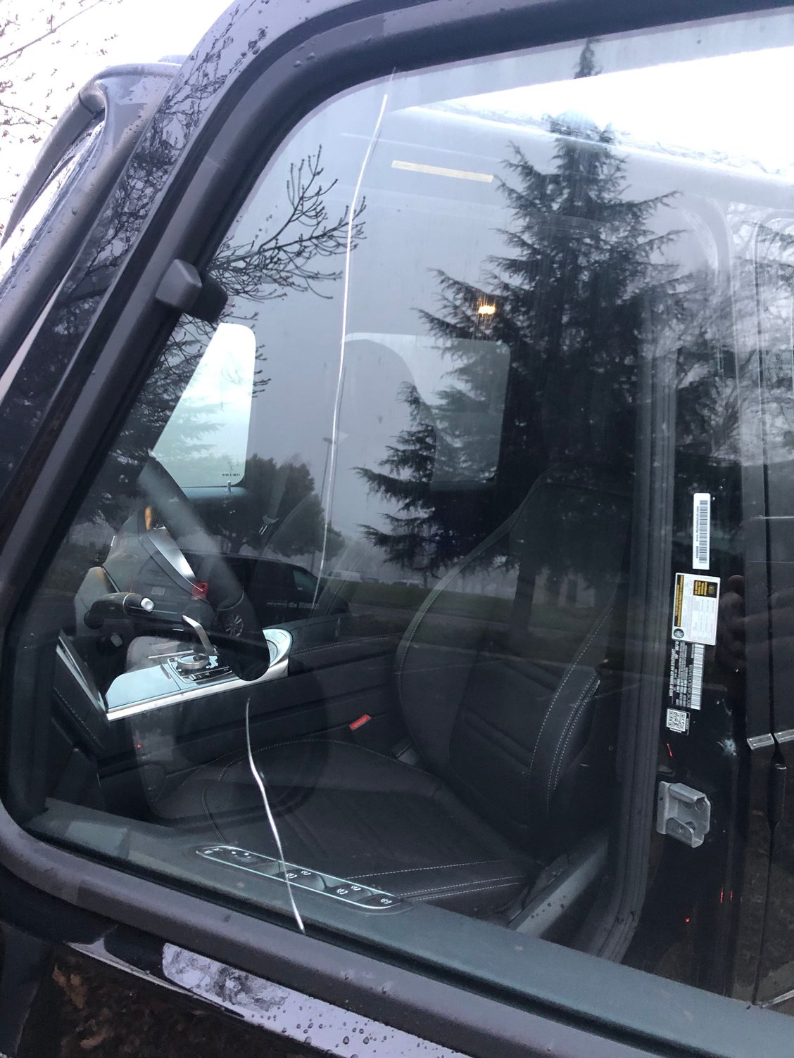

Anyone else experience this? Fine this morning, G parked all day, then boom crack from top to bottom. How much to fix? Easy fix? 2020 G550 brand new.

Picture?

Did it crack while you were watching it without anything hitting it or was it cracked when you came back out to your G (a rock from a lawnmower/break-in attempt/angry Tesla owner could have broken it while you were away)?

I choose to blame angry Tesla owner lol. I didn’t see it crack or hear any debris contact. I’ll keep y’all posted. Just talked to the dealer - they had to order it. $357 for the window and $735 for labor. If it’s a defect they will replace for free.

I can’t see any single point of impact. I’m thinking a defect that started at one of the upper or lower edges of the window.
Without a clear point of impact, I can’t see how the dealership can claim this wasn’t a defect in materials.

You could ask the dealer to keep hold and show you the window post removal; he believes (body shop owner for 34 years) it could be a stress fracture from the window regulator... he says you should be able to see where the window was held by the regulator as long as it’s not cleaned up etc.

Being a double glass. are both inside and outside affected in exactly the same crack or it's only one? ...which one?

Both are affected exactly the same way.

If both sides of a laminated glass are broken, then the damage had to originate from an edge. Most likely the top edge that is exposed. There are trade offs to tempered side glass. Laminated glass provides limited sound insulation, and its remains intact when it breaks. But, the laminated glass is not as strong as tempered glass.
