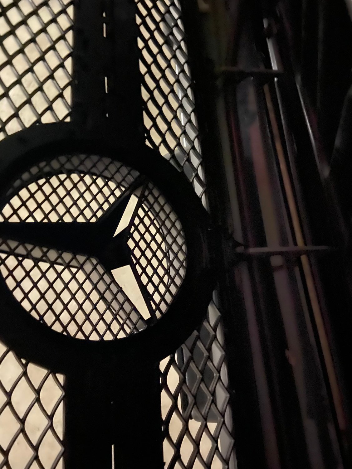

I am looking to remove the front Mercedes star logo on the grill and swap it with a black one. Tried twisting the star but don't seem to work.
Asked a friend he said he heard I need to remove the grill then unclip the star.
Have anyone done this? Is removing the grill hard? I don't want to remove the grill if there are other ways around.
Inputs are greatly appreciated!

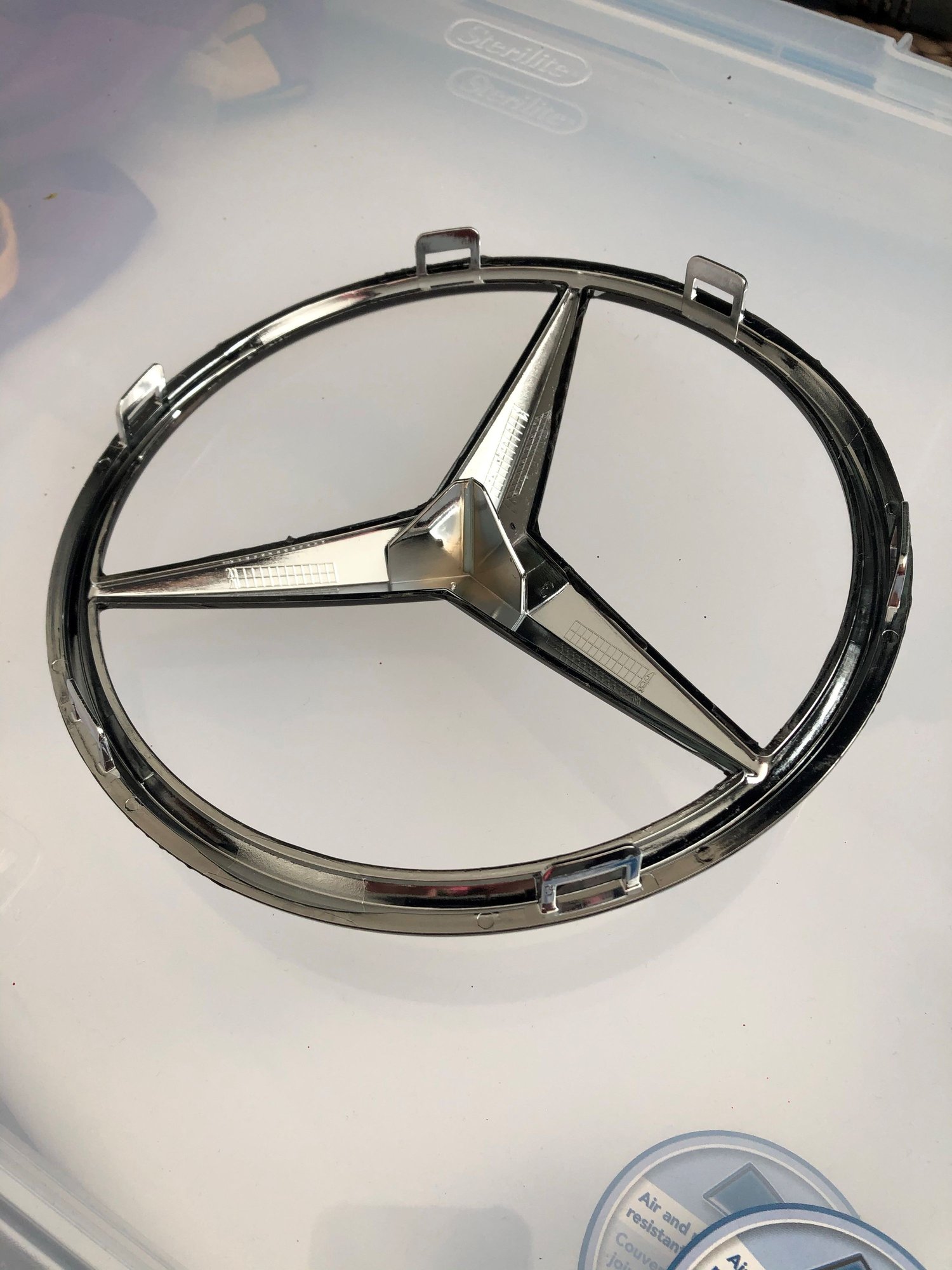

Yes, you need to remove the grille and from behind you'll see the clips that will need to be released to get the star off....while you are at it, you can remove the chrome trim and the cross section pieces and just vinyl wrap all the pieces black. Looks pretty good when you're all done!!!

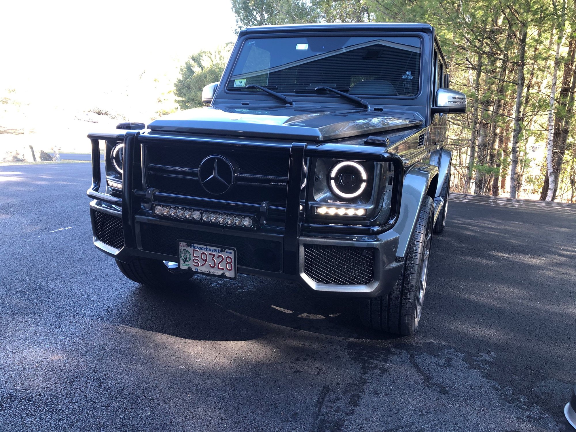

Off subject, but wanted to ask if you can used that light bar as DRL ?
Can it be used for supplemental lighting at night on streets and freeways ?
Or strictly for off roading only ?
Thanks

Way too bright for a DRL, though there is a way to make it 1/2 power ....still think its too bright. I have mine hooked up so it goes on when the high beams go on

So when you turn on your high beams, the LED light bar will overwhelm your original high beam in terms of light output ?
Overall would you say having the light bar on with the high beam on double or triple your total brightness output shining down the road?
I also would think amber color version of this same size and and brand may be less bright compared to white color and can be used as DRL.. more useful in fog and snow perhaps .

You have the take the headlight covers off (2 torx screws at the bottom) first and then just the bolts up on the top of the grille. Whole thing just pulls out from there.... Not hard to do at all....

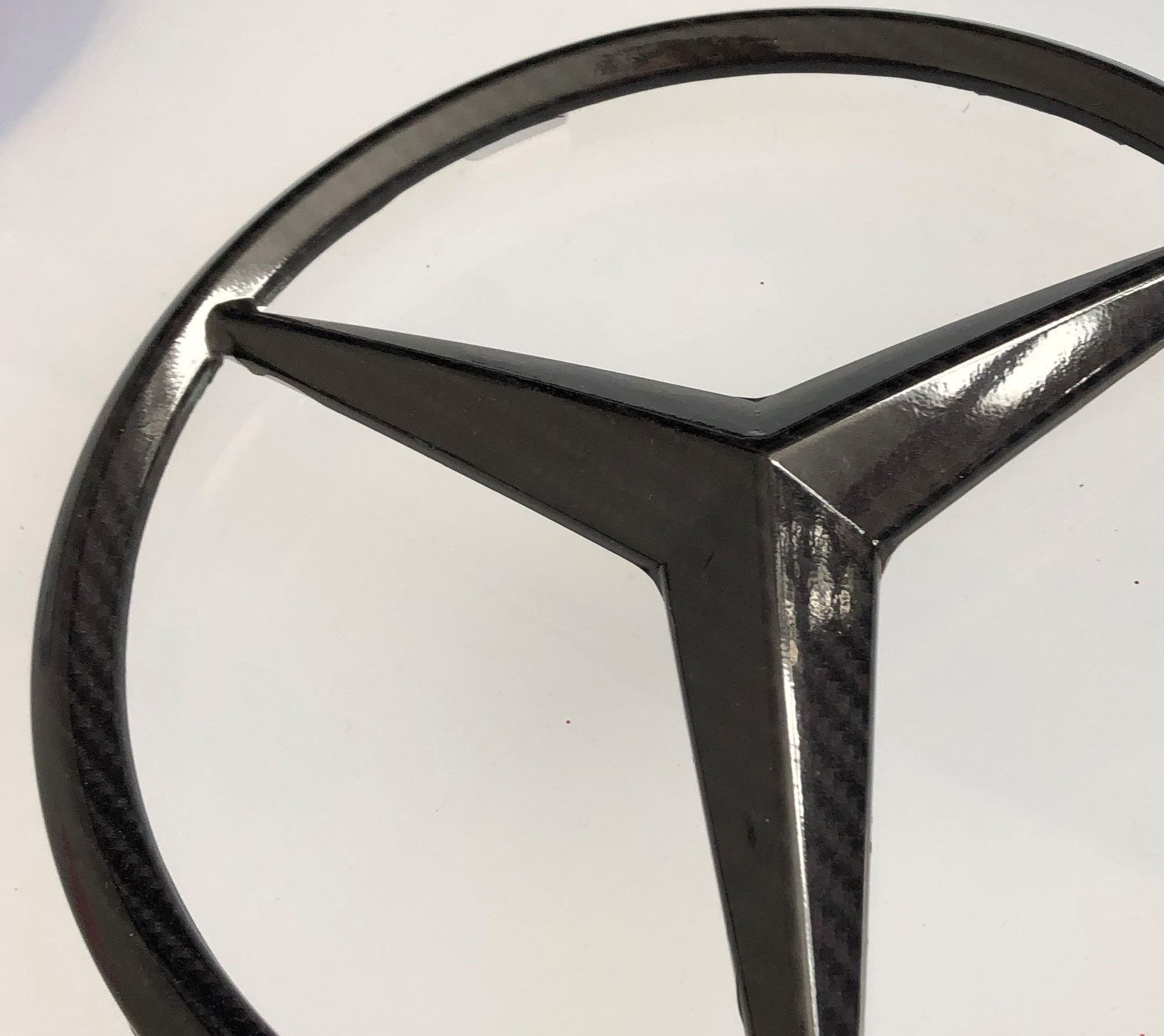

While you have some extra time in your house, you could fool around with wrapping the pieces as well. I've attached a couple pics of the star after wrapping it...also give you an idea of where all the clips are to release it from your grille....

Wow...professional grade wrapping.

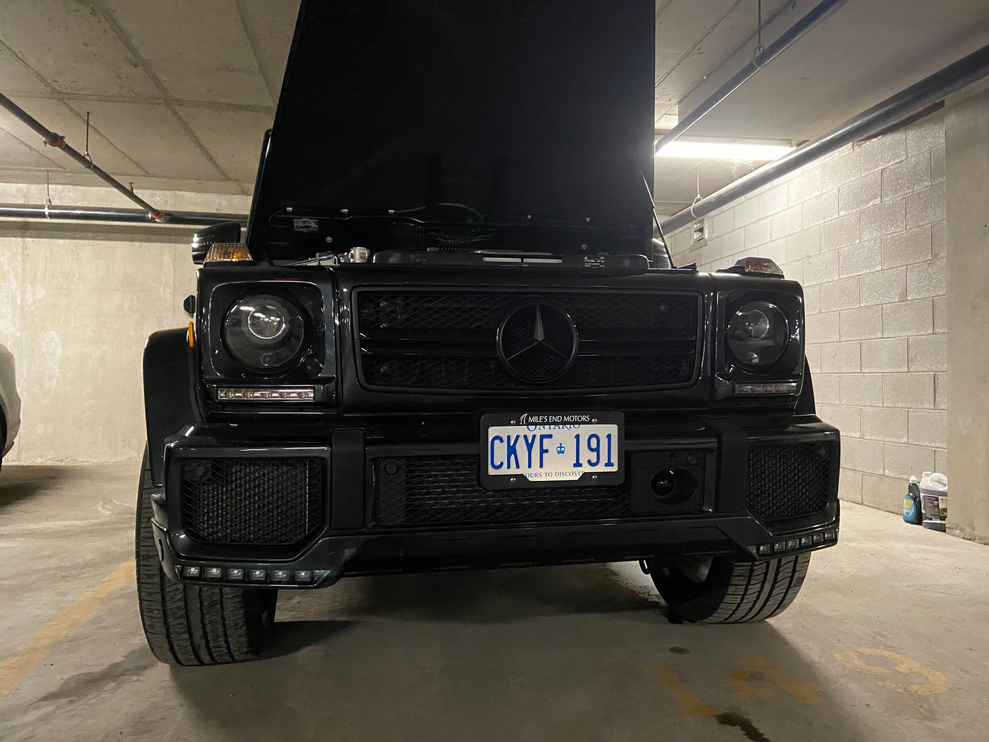

Got it done today. Love it!
I also bought a Brabus badge but it seems like the base of the front grill emblem can not be separated from the grill? Can anyone confirm?
Because the base is a also a Mercedes star form so I can not just put the Brabus on.
