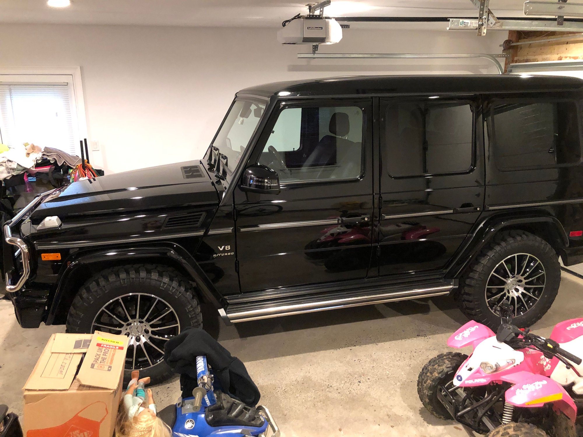

Jim, Do you have any pics of your ride? Do you think a bigger tire would work or is it close as is?

2017 g550 With dick cepek 305/55/20 tires on factory wheels, no lift kit yet. I just installed tires last week, and have not decided what lift kit i want. looking at the 50mm spring spacers.
