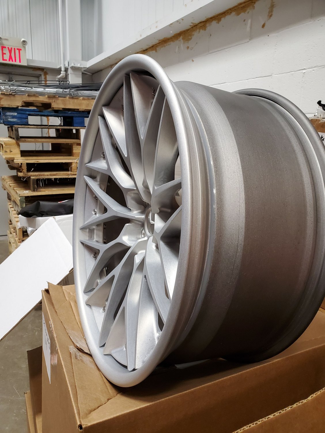

A 305/50/20 will rub during turning/full lock unless you were to use an offset that pushes the wheel well beyond the bodywork of the SUV. We built the ANRKY's below to a perfect flush fitment & it had minor rubbing as mentioned. Some customers live with it and other customers will go with a narrower wheel & tire setup.

We used 305/50/20 on that white G63. With the offsets that we have I don't believe that the 285 will rub. It's not possible to measure how badly it was rubbing since that's subjective but in my opinion it was tolerable. The client found it tolerable as well.
