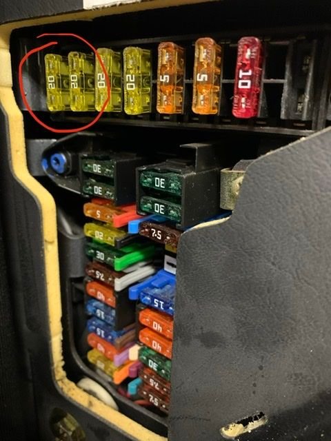

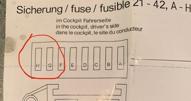

I attached some pics of the fuses I think are associated with it...
I checked those and they were good. Perhaps I am checking the wrong ones....

It was not one of the high current "engine fan" fuses that one might expect from the name. Rather, it was more innocuously labeled with something like "fan" or "blower" or "heater". I wish I could remember that exact one, but I I'm sure it was one of the smaller ones. Try checking fuse 30 and 41.
30 and 41 could definitely be involved...
I visually inspected 30 & 41 as my multi-meter is mia, they appeared fine. However, I better buy (or find) my other one to confirm.
i really appreciate your help.
