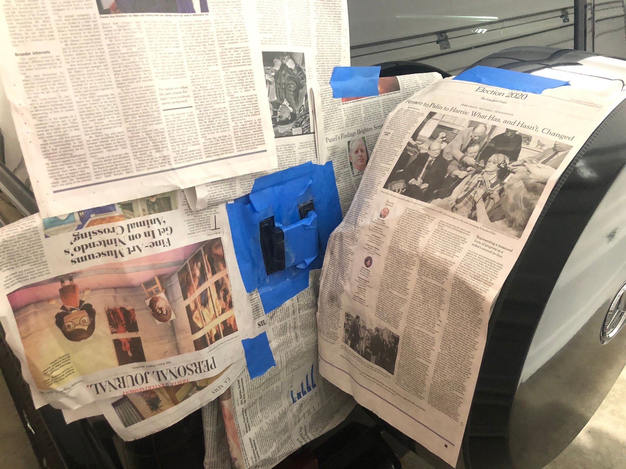

Some shots of a lubrication job I did from a few months ago...
Any kind of aerosolized oil is going to spray, so it's best to tape the area off and work in a well ventilated area. You want to oil the hinge itself and the area around the gaskets. Using a rubber putty knife, gently pry back the gasket just enough to insert the straw under the gasket and oil the entire way around. Also, you can insert the straw further in and spray the underside of the sheetmetal, as rust typically forms around these areas. As I dont have a nozzle that allows for 360 degree diffusion, I have to twist and turn the straw in order to coat the inside of the sheetmetal. If anyone knows where to get a straw that allows for that I would be much obliged. However, I do have a 25 and 50 inch flexible straw made for aerosol cans that allows me some flexibility in terms of snaking the straw in and spraying hard to reach areas. You can find them on Amazon for a few bucks. Also, be sure to check the condition of the gaskets...they become deformed and brittle over time. They only cost a few bucks at your local dealer and can be the difference between water seeping in or staying out.
Ultimately, I think I am going to have a Waxoyl application performed by a professional shop. I was looking under the truck last night and there is a lot of surface corrosion on the chassis. Because I don't have room for proper tools (compressor, air gun, applicators, etc) it will be impossible for me to perform a proper rustproofing job that fully coats/sprays all problem areas including:
-The underside of the door sills. The body shop said the rust there started from the underside and worked its way up. I just can't reach it with the tools I have.
-The backside of the rear sheetmetal. This is where a 360 diffuse spray nozzle is imperative - it sprays oil in a 360 degree, 3D pattern ensuring the entire sheetmetal is completely coated on the inside.
-The entire chassis. Tons of surface rust down there.
-The entire inside of the roof. Rather than just target the moonroof and antenna (front and rear) cutouts, might as well do the entire thing. The seal around the moonroof is subject to degradation and allows moisture inside.
-The seals around ALL windows. As I mentioned, I am going to have take the car to a body shop, remove the front window, and fix all the corrosion around it. The same seal design is also used around the rear windows, so it is safe to assume that they are subject to the same issue of water being trapped behind the seal.
-The inside of the door sheet metal.
