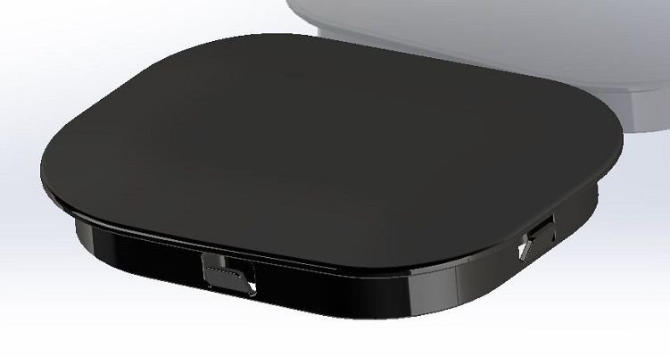

The design looks like this. The plugs for the Driver's and Passenger's side are mirrored and follow the lines and curve of the bumper. There is also foam weather stripping under the front lip that sits against the bumper.

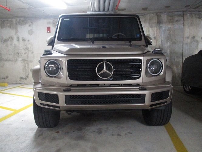

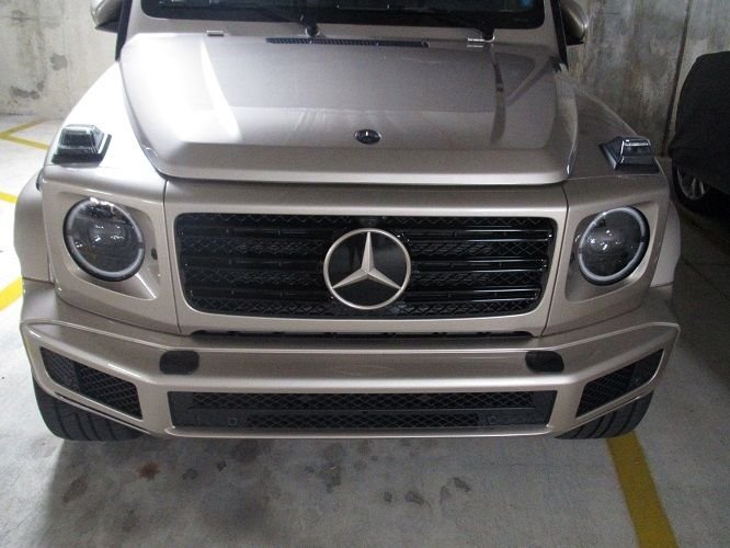

BobZ was awesome enough to take pictures after install with his truck. Below are a few different angles of the plugs installed. As you can see, the plugs are raised slightly from the bumper (with foam gasket) and are slightly domed. They are not flat and do not sit flat to the bumper.

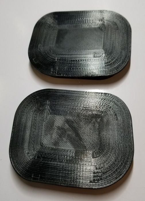

This is what the plugs will look like in their raw 3D printed state (FDM Printer). These pastic parts will finish like any other plastic part. Sanding smooth is the same difficulty as any other plastic and painting will require adhesion promotor or plastic-specific paint.

I really like these and at first I thought about getting them painted to match but after a few weeks I think I will leave them as-is since there is a lot of Black on the truck and they kind of blend in. After several weeks of driving with them on I have checked them periodically to be sure they have not wiggled out, etc. and there has been no movement at all so I am sure they will stay in place, unless one wants to take them out, which is easy using just your fingers. If someone has been thinking about removing the brush bar but was reluctant to do so this is a top notch option!

About 3 weeks ago, I met with a forum member and his W463A G550 with the brush guard removed. Thanks Saif! I was able to test fit the current design of the bumper plugs and although they fit ok overall, I wasn't completely happy with their fit and/or look.
A few issues to note:
1. The bumper has a slight curved shape that I'll need to add into the flanged part of the plug to fit 100%
2. The plug sat too high off the top surface of the bumper. I'll be slightly modifying to make the plug sit lower and also use a thinner foam gasket.
3. The lower attachment clips really don't work all that well. I'll be redesigning a lower bracket to attach the plug from below using screws. This way they will not fall out and be held in securely.
The plan is to finish the design this weekend and 3D print a few parts and assemble. I'll send these parts out to a few members I have been working with and once they verify the overall fit, they will be ready for sale.
