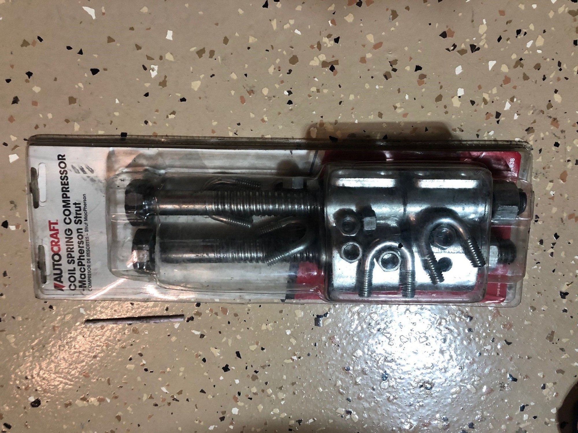

4. When installing the spring compressors, It is helpful to get as many coils when you install it. That means using a jack to jack up the hub so the springs compress. The black compressor tool shown below worked well on the front.

Worked well on the front
Worked well on the rear

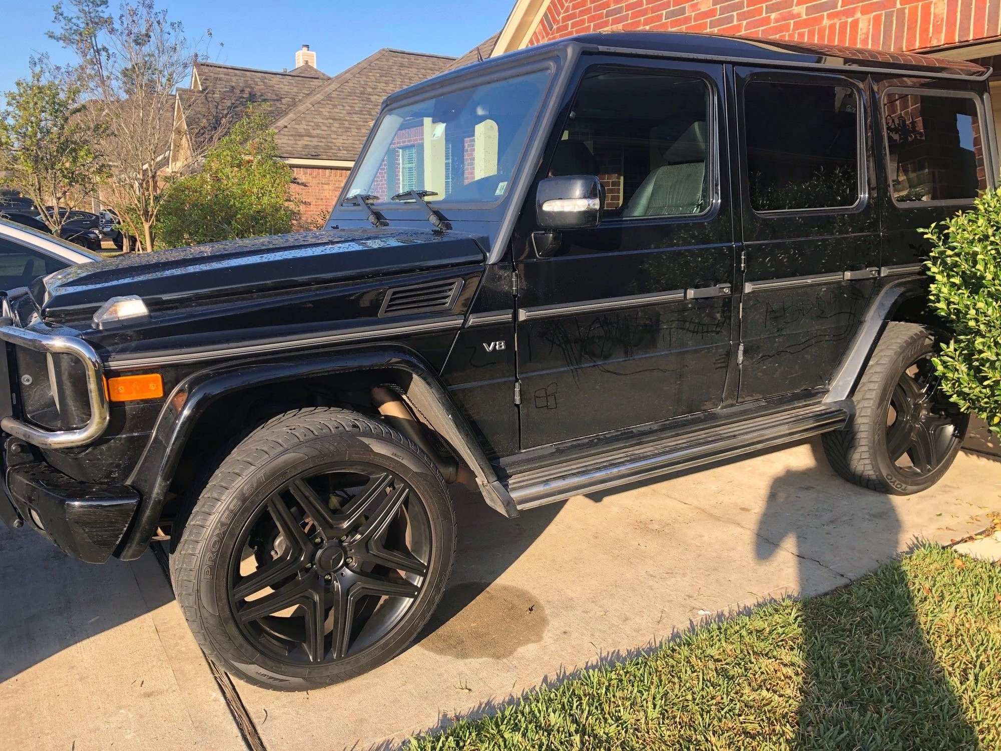

Finished product. 40mm spacers and 22" wheels and 285/45r/22 tires
