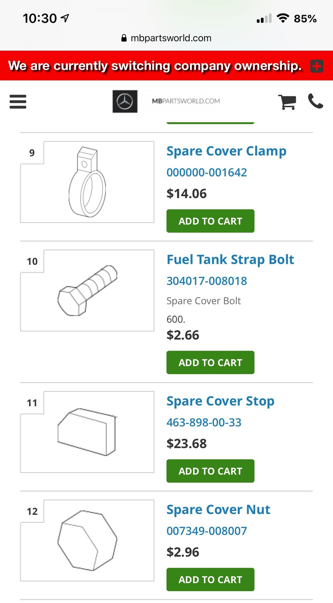

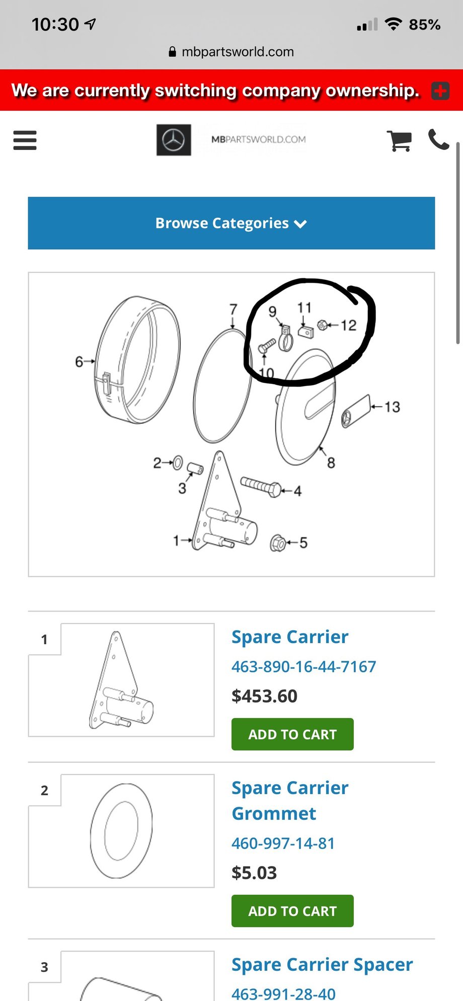

Not sure why I never found the numbers before in my searches typically I only found a diagram with no parts listed. Here is what I was referring to and the parts numbers for any in the future. I always see many being sold with crooked covers.
could someone please post a pic of how it should be setup on the cover?
thanks

I'm guessing that the clamp ring (9) and the stop piece (11) need to be positioned such that the stop (11) meshes with a slot in the carrier tube. With the spare tire removed, put the clamp assembly on the disk's tube and mount it with the stop meshing with the slot (or whatever it's supposed to align with). Rotate the disk and eyeball it level, and then tighten the clamp bolt. Glad you found the right p/n's.
