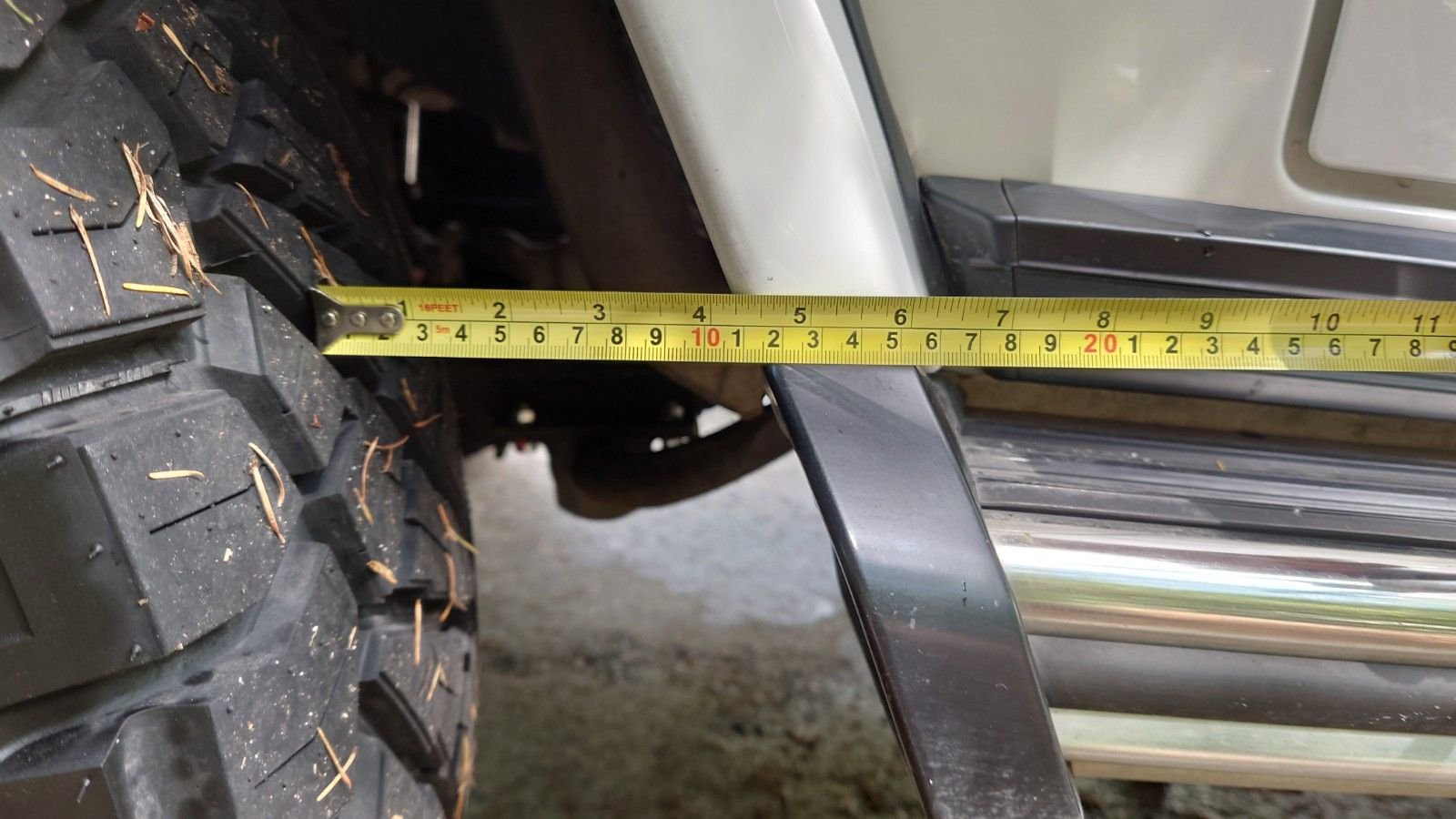

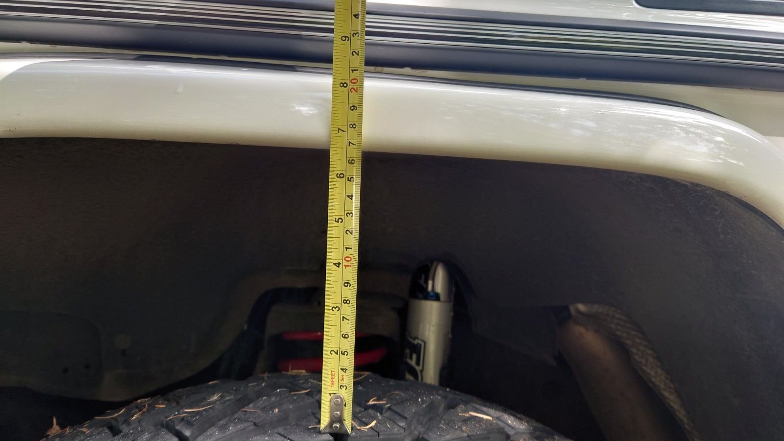

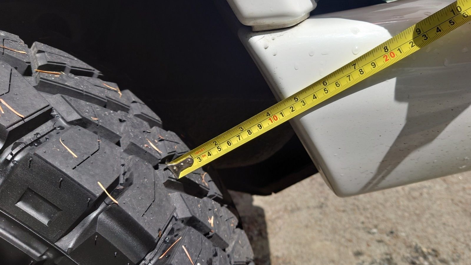

Old Jun 12, 2021 | 02:15 PM
171222f's Avatar
Joined: Jun 2021
Posts: 6
Likes: 14
G550
Front wheel
Rear wheel
MInd that Nitto Ridge Grappler 315 75 16 is more like 34 inch tire when installed.
I could also fit 37 inch tires with no rubbing for street driving but not for off roading.
Not sure if 40~50mm spring spacers (It will be 140~150mm lift in total) can make it work.
Next step is to install Letech winch mount with 2016-2018 G550 front bumper and wide fender flares.
All have been ordered and waiting...
