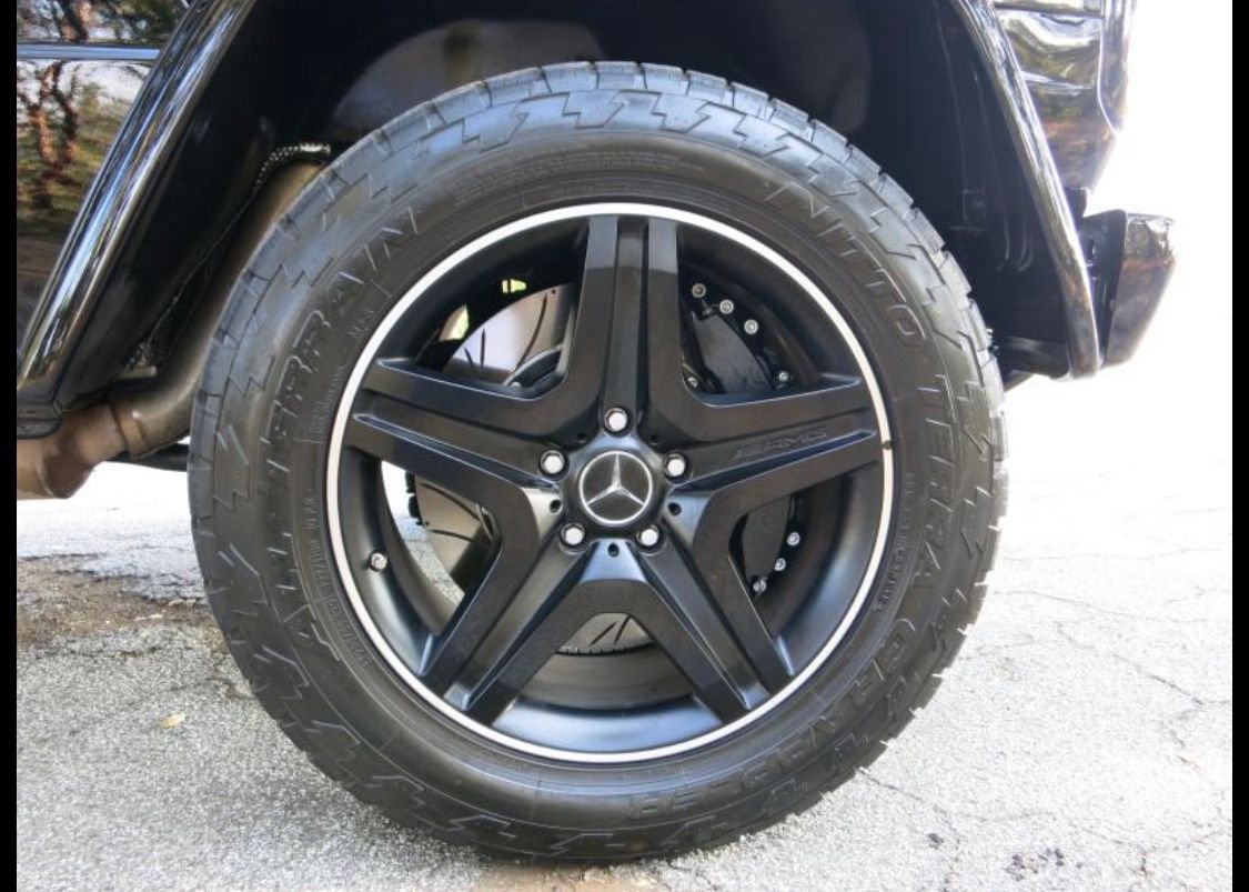

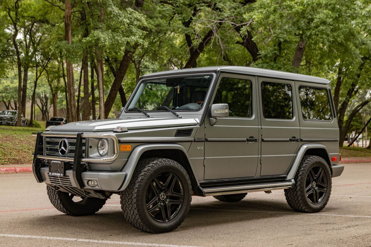

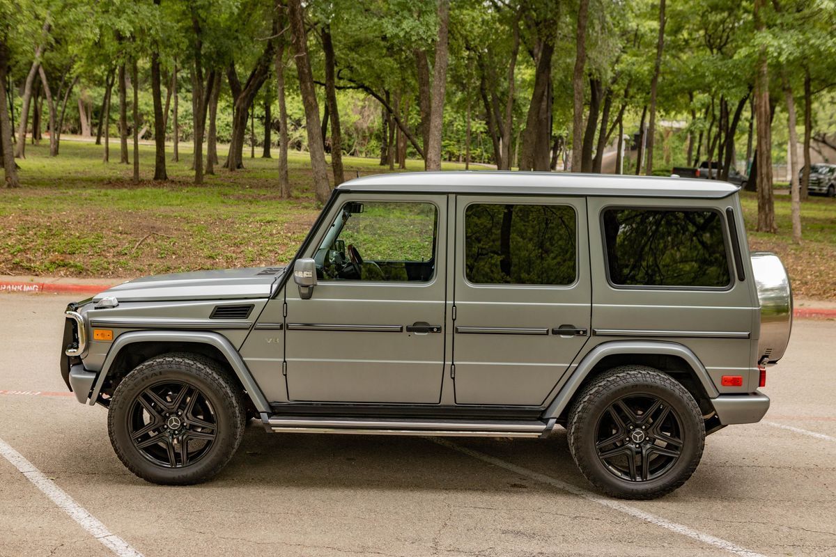

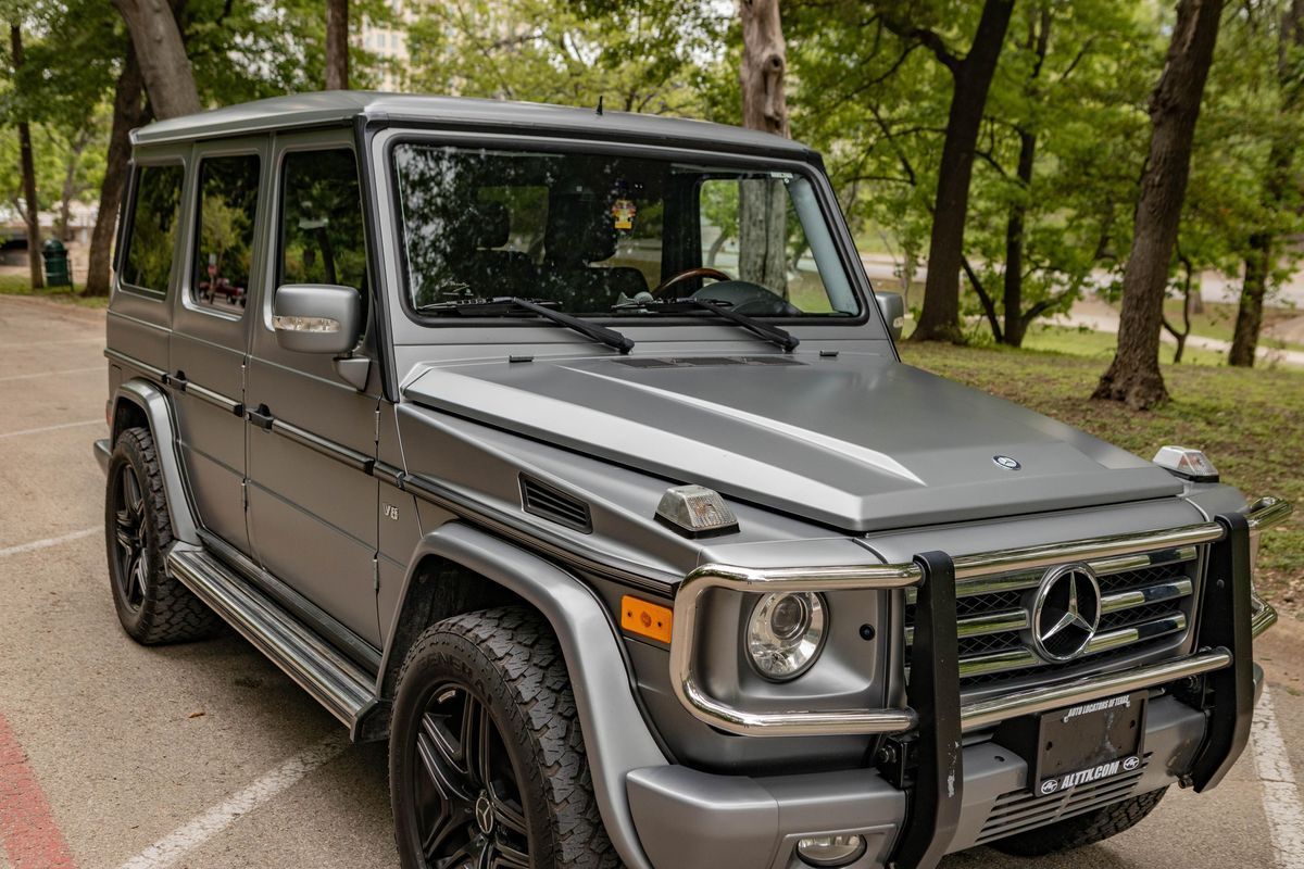

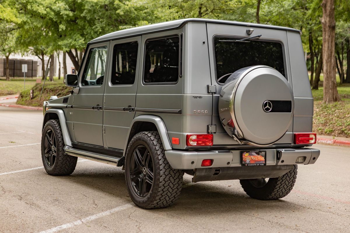

Would a 305/50R20 fit without rubbing (with or without spacer)? Going for lower height but wider tires to stick out from fender (does not need to be much). If it rubs, how badly? Would love to hear personal experiences. Or do you recommend 295/50R20 and run spacers? Ive seen another gwagon run 305 but not sure how much it rubs (if any) and if they are running on spacers and/or lift. See below are images.

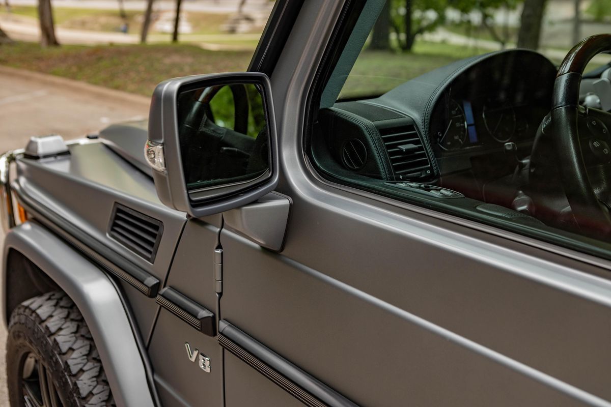

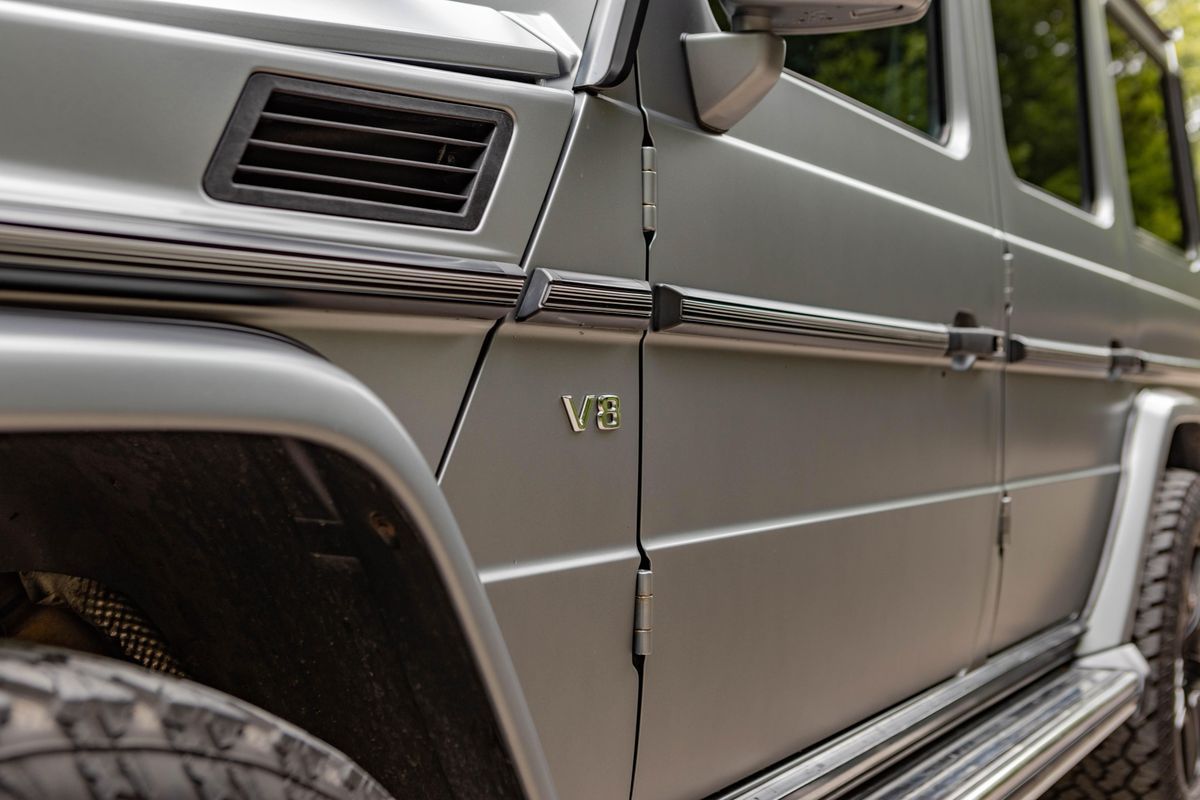

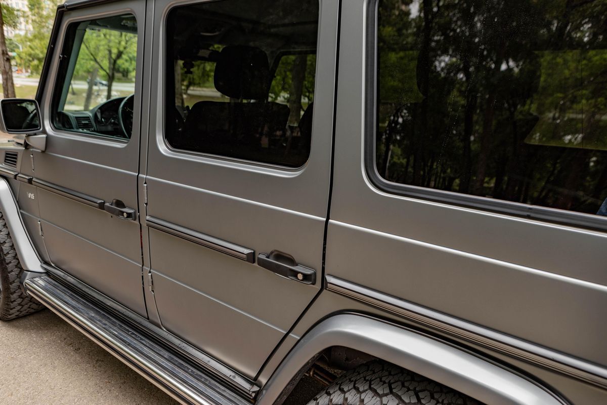

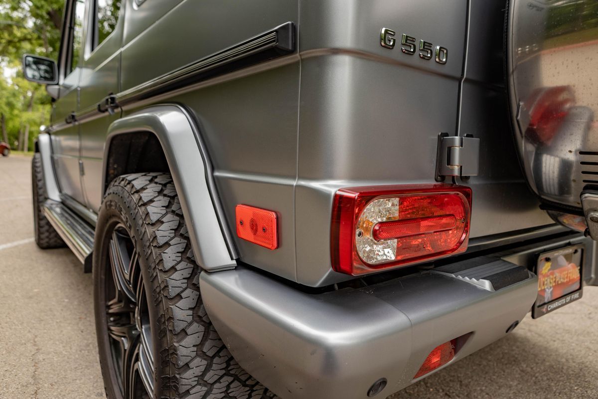

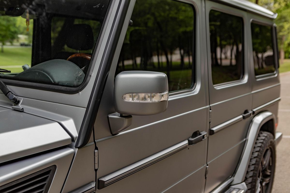

Hey could you take a close up photo of the rear door hinges?
Old Jan 10, 2022 | 01:18 AM
G550noob's Avatar
Joined: Jan 2022
Posts: 8
G550 2012
Here. Again this is not my vehicle. Based on his original description, only tires no lift or wheel spacers. Tire size 305/50R20

I ran 305/55/20's on my G63 with just 31mm spacers to clean the scrub radius on the inner fender.... then did 40mm spring spacers after to allow for full travel.
