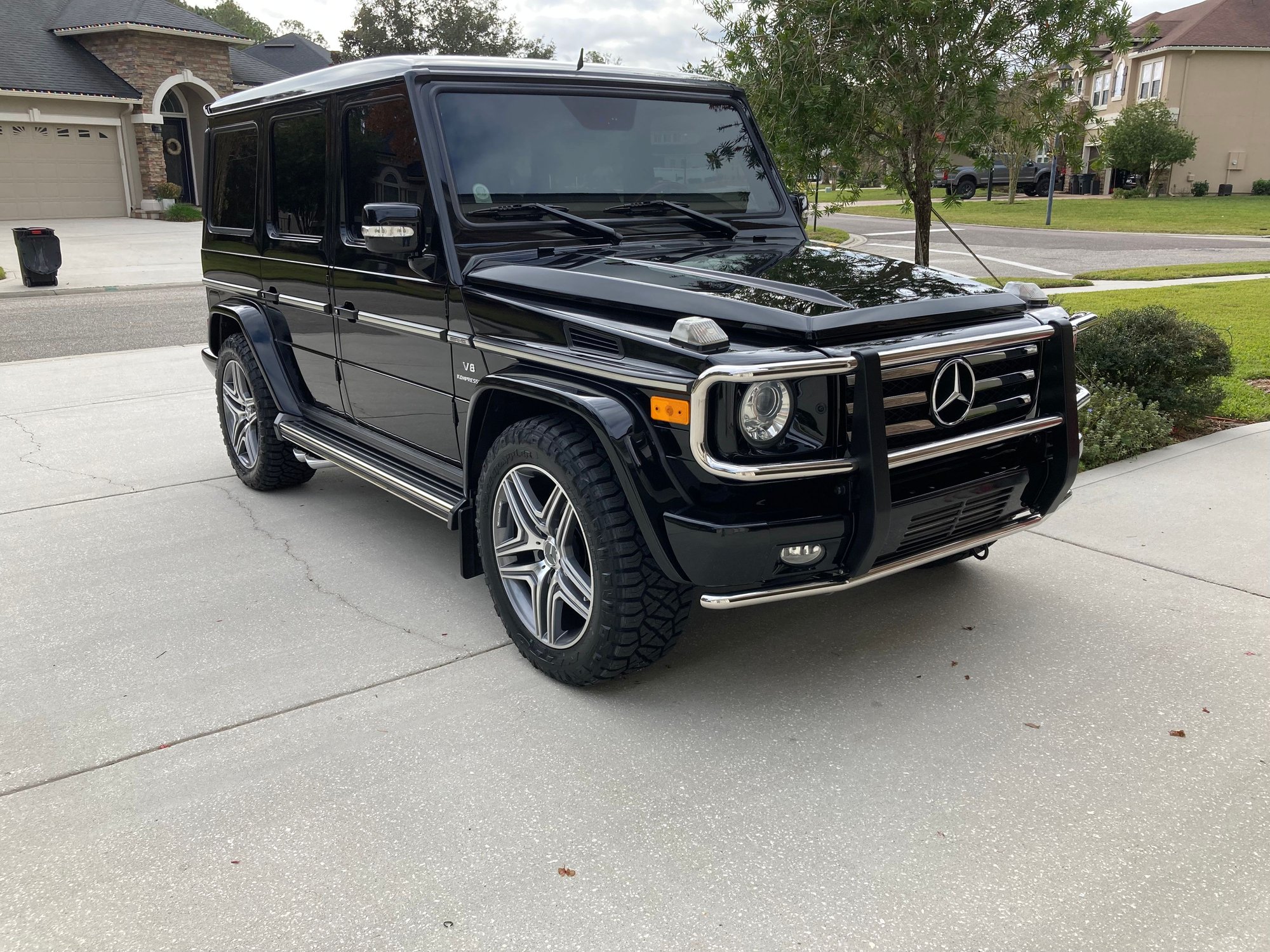

I want to put some 275/55/20 AT tires or other size that will fit on my G55. I will be using 20x9.5 G63 replica wheels. They have a 48mm off set. I have 17mm wheel spacers on the front and 20 mm spacers on the rear. I may put 30 mm spring spacers on the front to level the truck. Looking for recommendations on the size and type of tires. I’m in Florida so I don’t have to drive in snow. I don’t plan on any serious off road trips just some trips to the beach and some forest preserve drives. I like the aggressive look of the AT tires. Thanks for any suggestions.

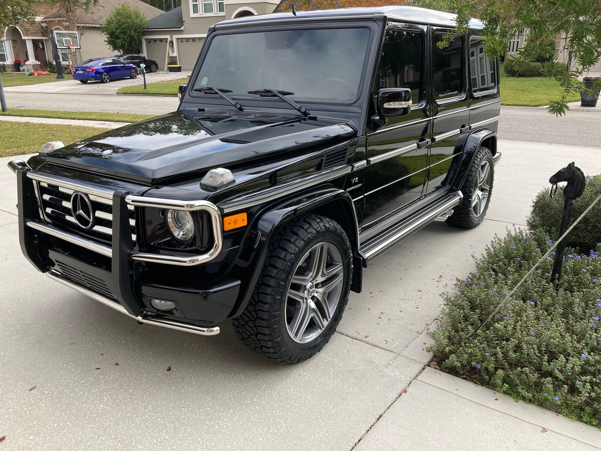

I ended up getting 275/55/20 Ridge Grapplers. Thanks to the forum I was able to make an educated choice.

Have only driven a few miles but the vibration from the old flat spotted tires is gone. It definitely rides much better with the new tires. It looks more aggressive and there are no clearance issues. If anyone wants a set of the 19” wheels I have a flawless set that only were used for just over 5000 miles.
