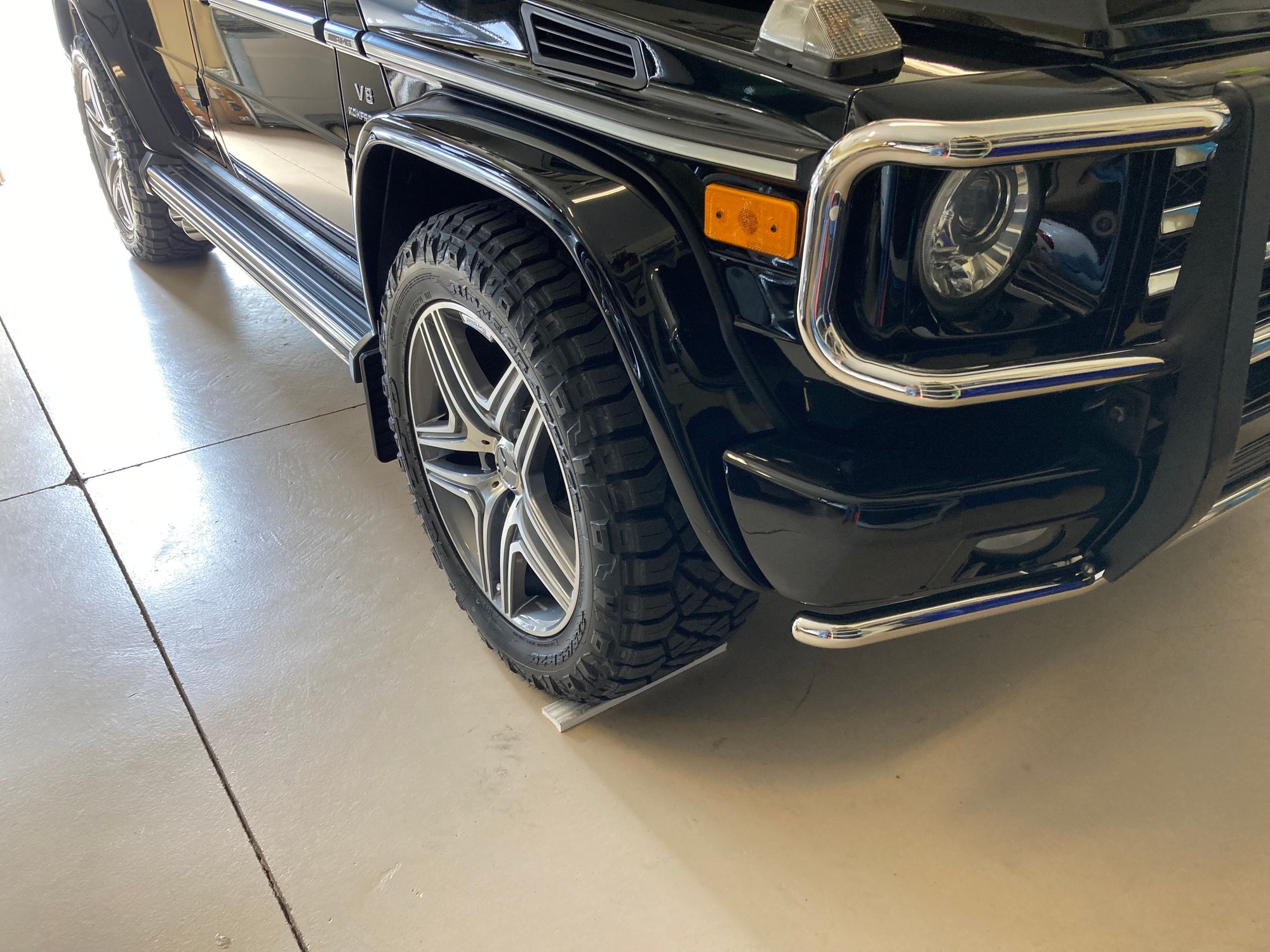

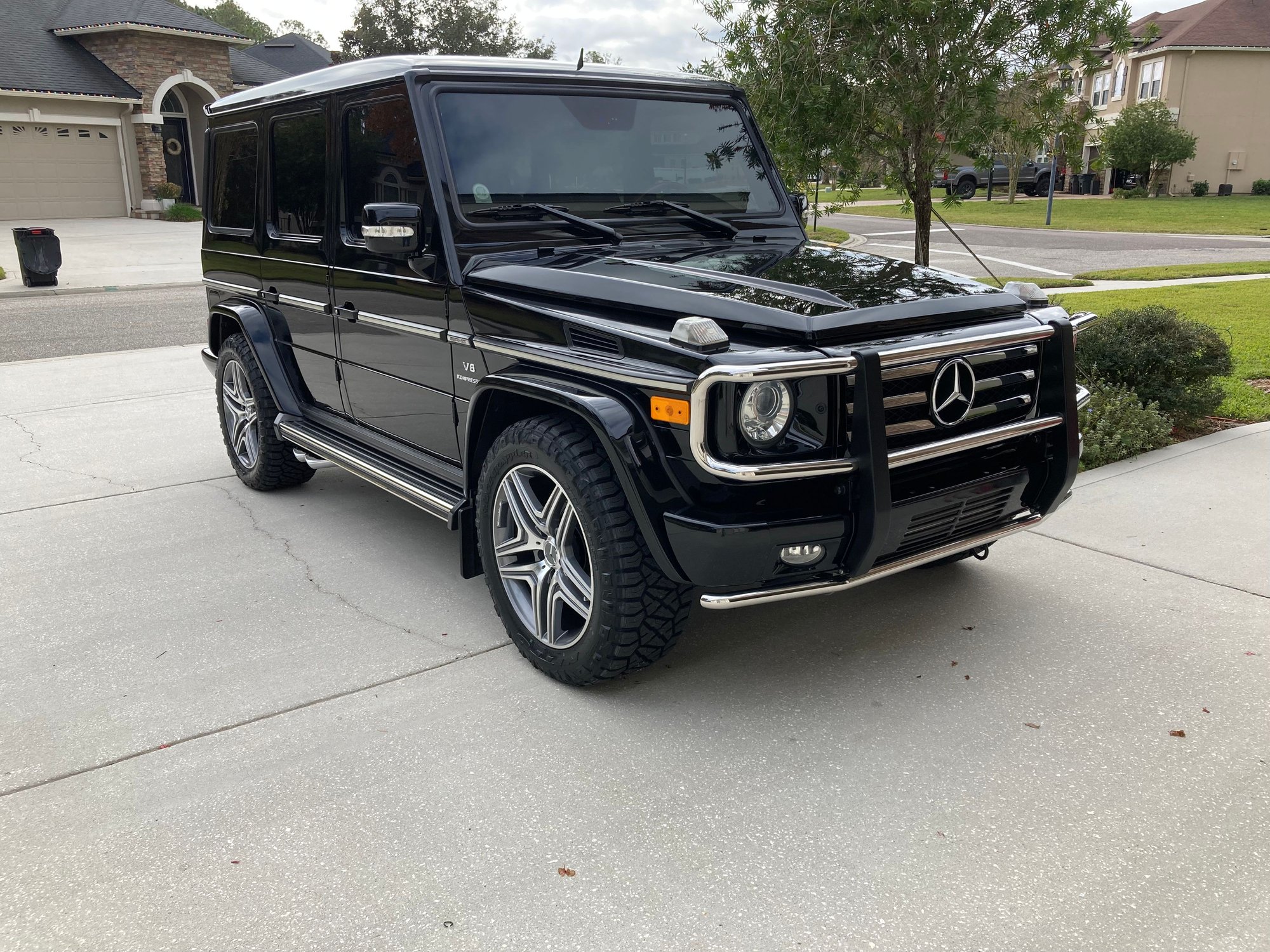

I just put G63 replica wheels on they are 20 by 9.5 and have a 48mm offset. I had Nitto Ridge Grapplers 275/55/20 mounted. I have 17mm spacers in the front and 20mm in the rear.
Have no problems with rubbing on anything.
