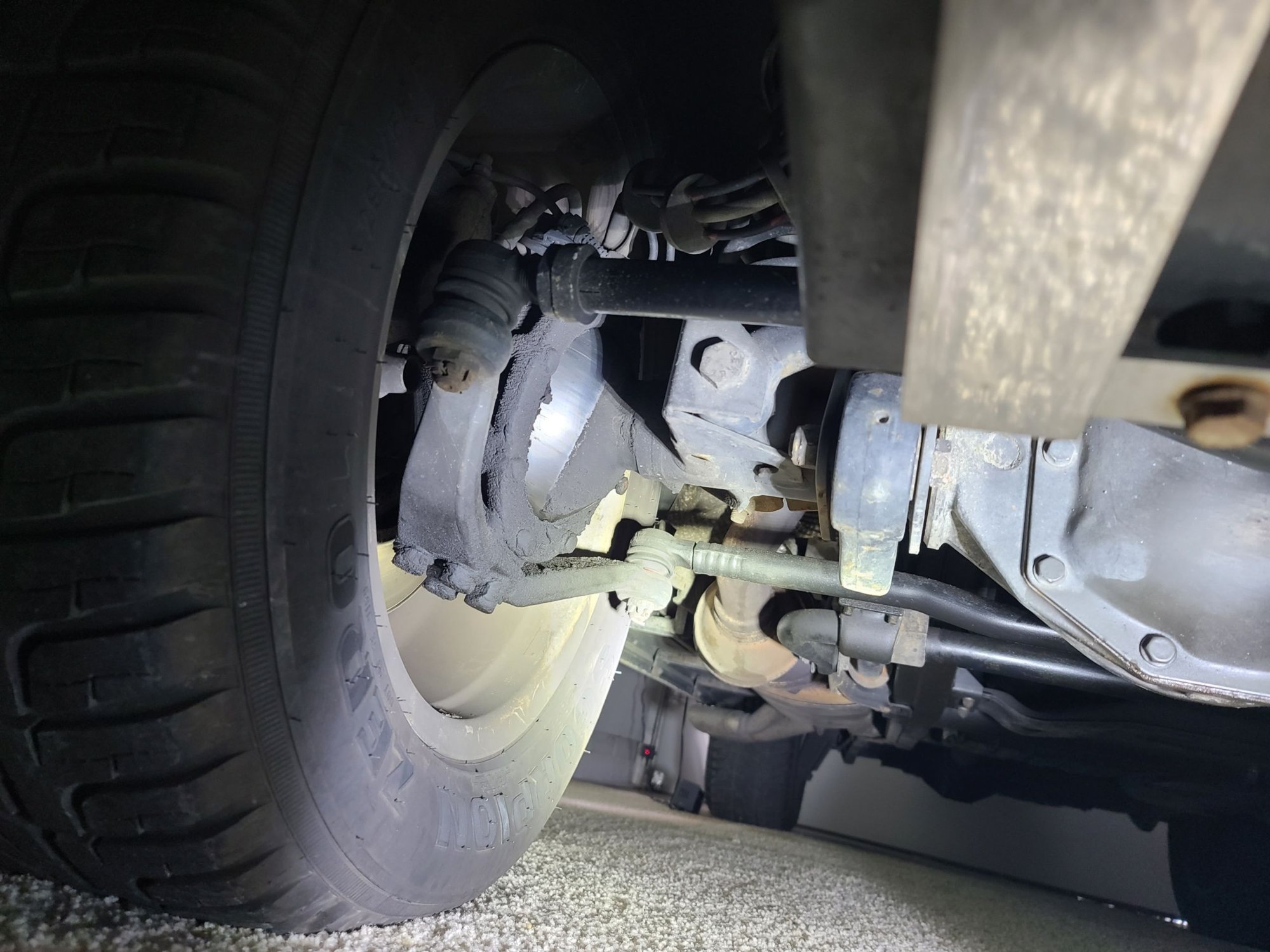

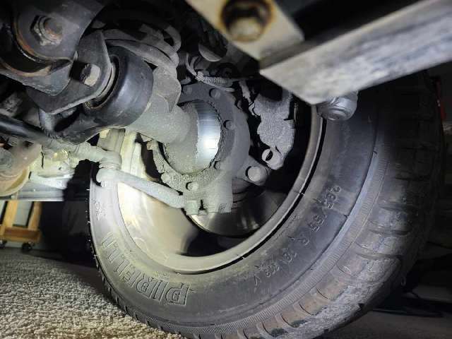

Hi all! New here. I come from the triple locked Toyota world and am possibly making an offer on a 2005 G55 tonight. It has 116k miles on it. It appears to be in great shape. I asked the seller to send me pics of the birfields (at least that is what we call the front CVs in Toyota land solid front axles). See attached pic. They don’t look that bad. They aren’t leaking. I’m use to dealing with failed axle seals that end up mixing dif oil with the CV grease and causing a mess. They seem to be a bit dry though. Is there I grease nipple on the CVs? Let me know your thoughts.

They're a little bit dirty, but overall no signs of leaking.
That being said, they do look a little bit dry, so that may be why they're not leaking. There is no grease nipple, but there is a large plug on the side of the swivel ***** to fill the grease from. They are on the rear side of the swivel *****.
Replacing the swivel ball seals correctly is a real pain since you have to remove the axle/hub assembly. They make a split seal that you can use (I did when fixing my leak in a pinch) that is pretty simple to do from the inside, but obviously there are drawback to a split type vs a continuous round type.
Looks pretty clean underneath with minimal surface rusting (at least in these pictures).
A few things to ask about:
Check the date code on those Scorpion Zero tires as they are probably pretty old.
Check for rust spots on the body in all the usual places (under the doors, on top of the doors, around the windshield, on the lower rockers, around the tail lights.
Engine has normal leaks around the rear main seal and from the valve cover gaskets and breathers. Check for leaks on the front/rear diffs, TC, and trans.
When test driving, make sure the trans shifts smoothly, with slow partial throttle application, and pedal to the floor mode.
Check all the door locks and handles work well, as well as the windows and sunroof.
The 2005 G55k's are a ton of fun. Mine has about the same number of miles and I've had to replace the shocks, steering damper, all bushings, and all the other seals and things that fail around the 100k age mark.
Hang on when you floor it from a dig as it's a smile educing experience!
