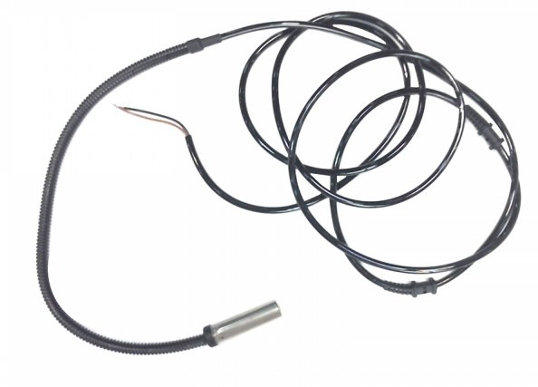

Looking into picture of ABS sensor for G550, I can see it's spliced and doesn't have a connector (odd)
So I would say go ahead and splice it in place close to the actual sensor, however you first need to check condition of wires. In my experience, I've seen bad sensor send up rust/turn wires black for 2+ feet into the actual wire. Check for that first
