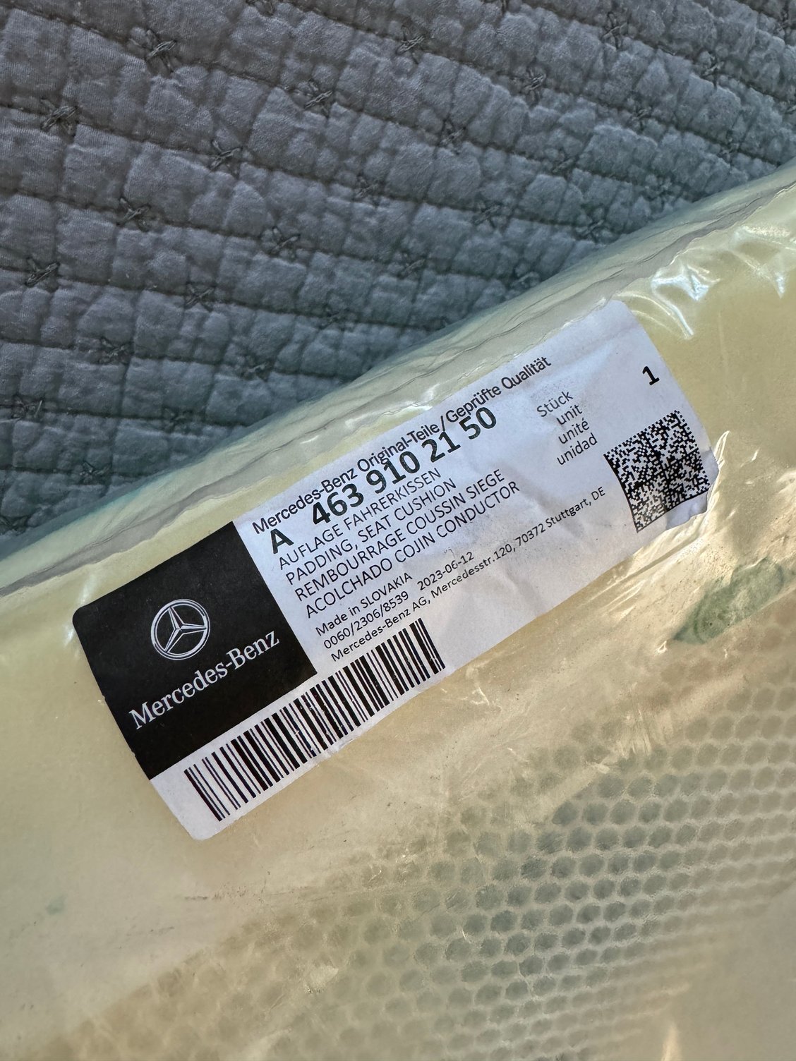

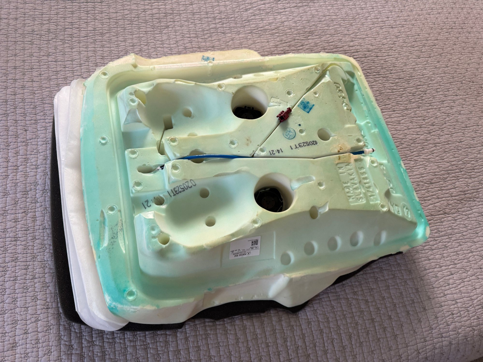

Shiann, I just ordered the seat bottom cushion from Mercedes ($330). Arrives next week. I will be taking a bunch of pictures from this process and posting here. My upholster says it’s common with 463’s from 2013-2018. The foam in the centers get worn out and the sides start to widen and flatten. You notice it especially when looking at the seat bottoms. My driver side seat bottom looks flat and sad. Whereas my passenger side, which has seen minimal use is looking factory fresh. Each cushion part is defined and firm and my driver side is not. Also, depending on how the foam looks, I maybe adding foam padding where it’s needed. Anyway, i will be posting pictures of this next week.

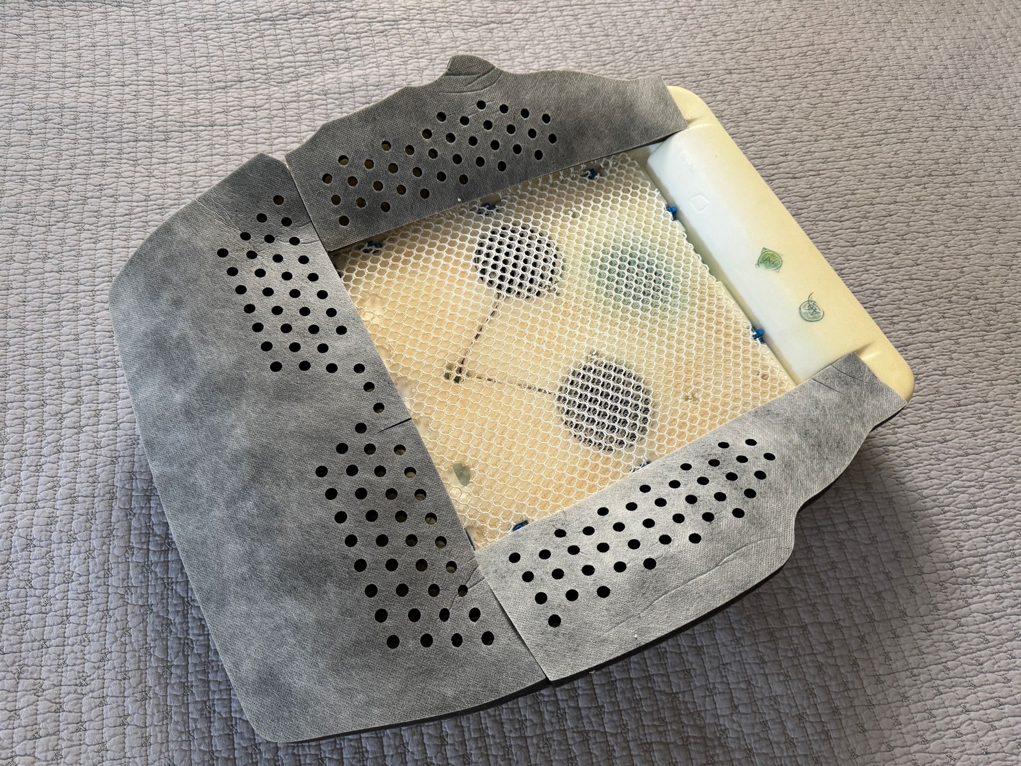

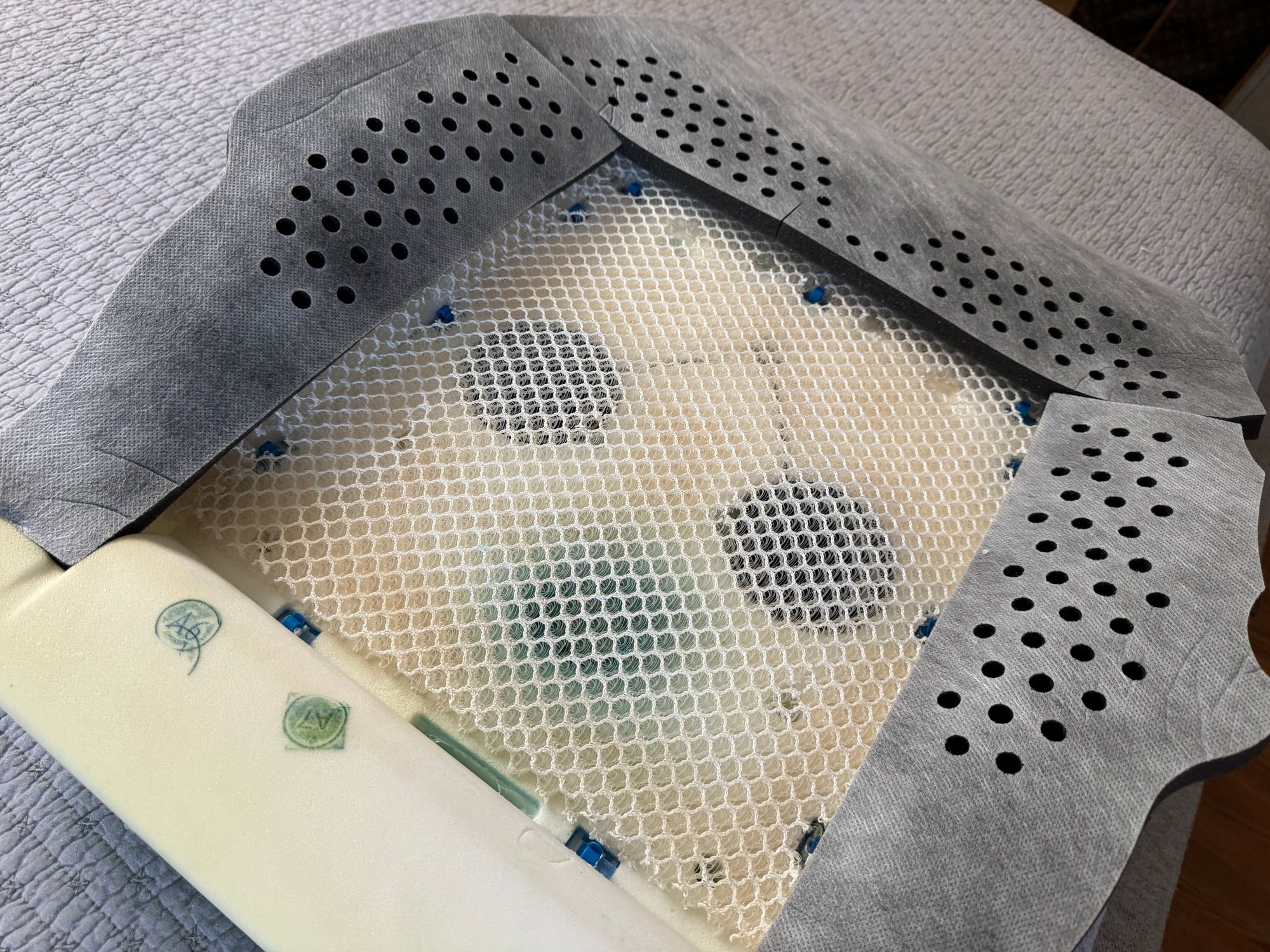

The new seat padding came in. Looks very different from the video link I posted. This new pad I ordered has a honey comb type cushion. Seems very sturdy. Feels like my passenger side seat thats seen very little use. Will post the completed project and if it worked.

Got it installed and have to say it is night and day different installing the new cushion pad. However, it’s going back to the upholsterer. The bottom cushion air bag function is not inflating and the ventilator is not working because there are two seat pads installed that are blocking air flow. Also my upholsterer’s seat padding is not the same as the OEM stuff. So it’s going back to fix those items and then change the padding out for OEM stuff. Keep you posted.
