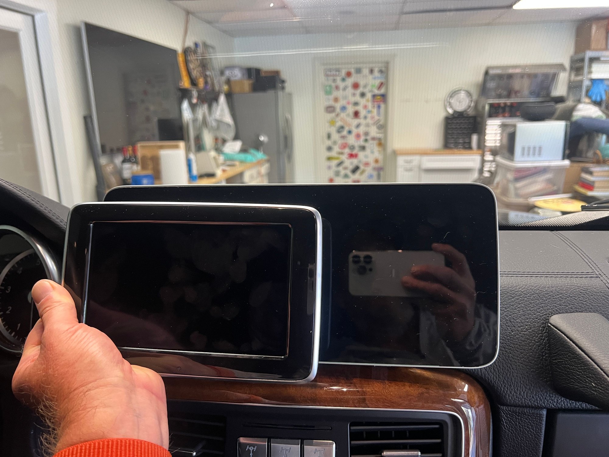

Originally Posted by skymast
if I were doing this again, I would probably get the 10.25 screen. The 12" screen is massive.
Can you provide a pic? I've wondered how much bigger it actually "is", in cab.

Old Oct 12, 2024 | 01:17 PM
skymast's Avatar
Joined: Sep 2002
Posts: 392
Likes: 18
From: Nashville, TN
2013 G550
12" vs OEM.
