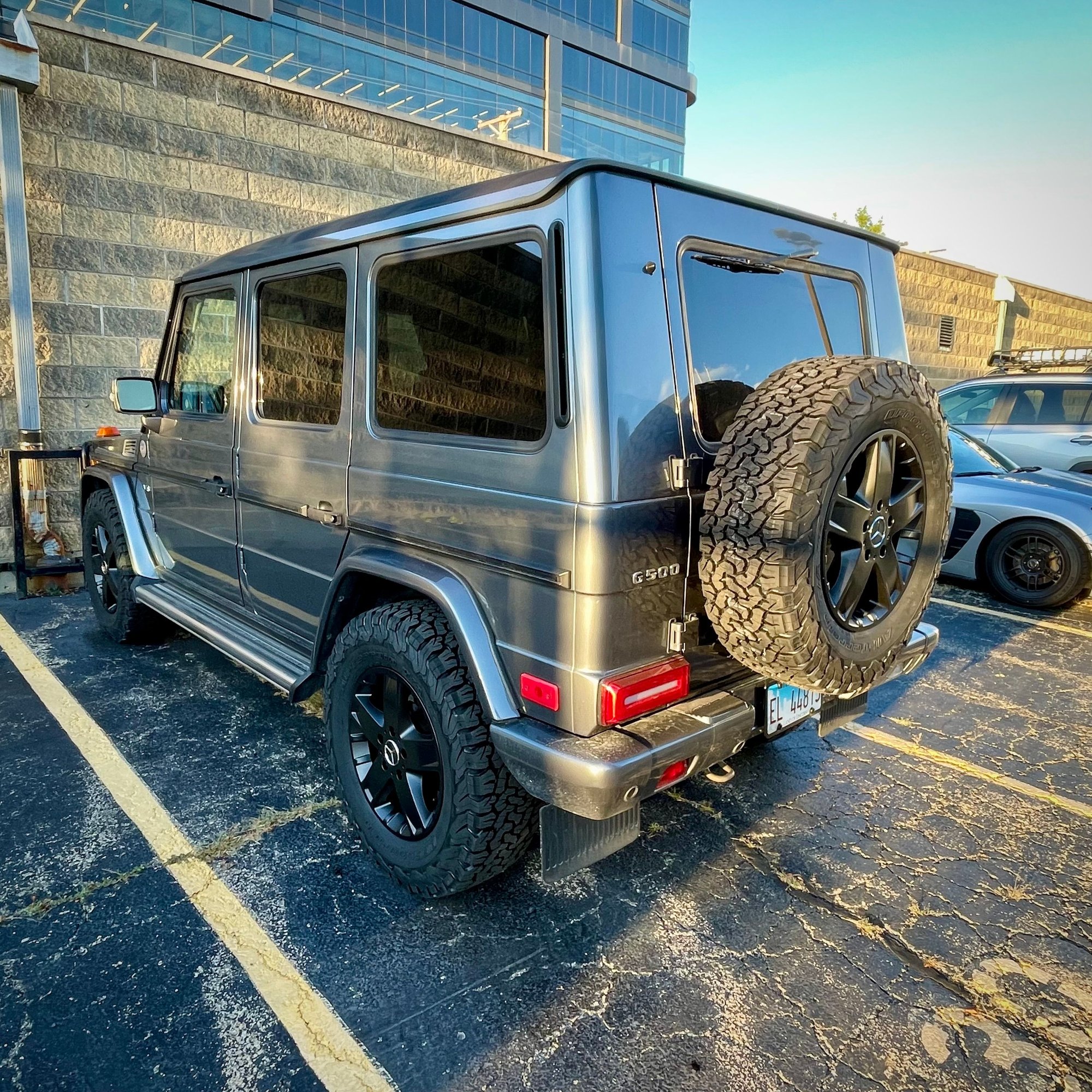

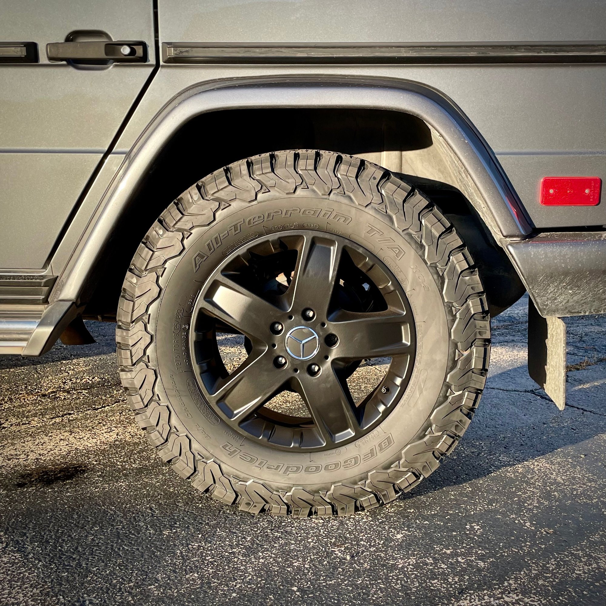

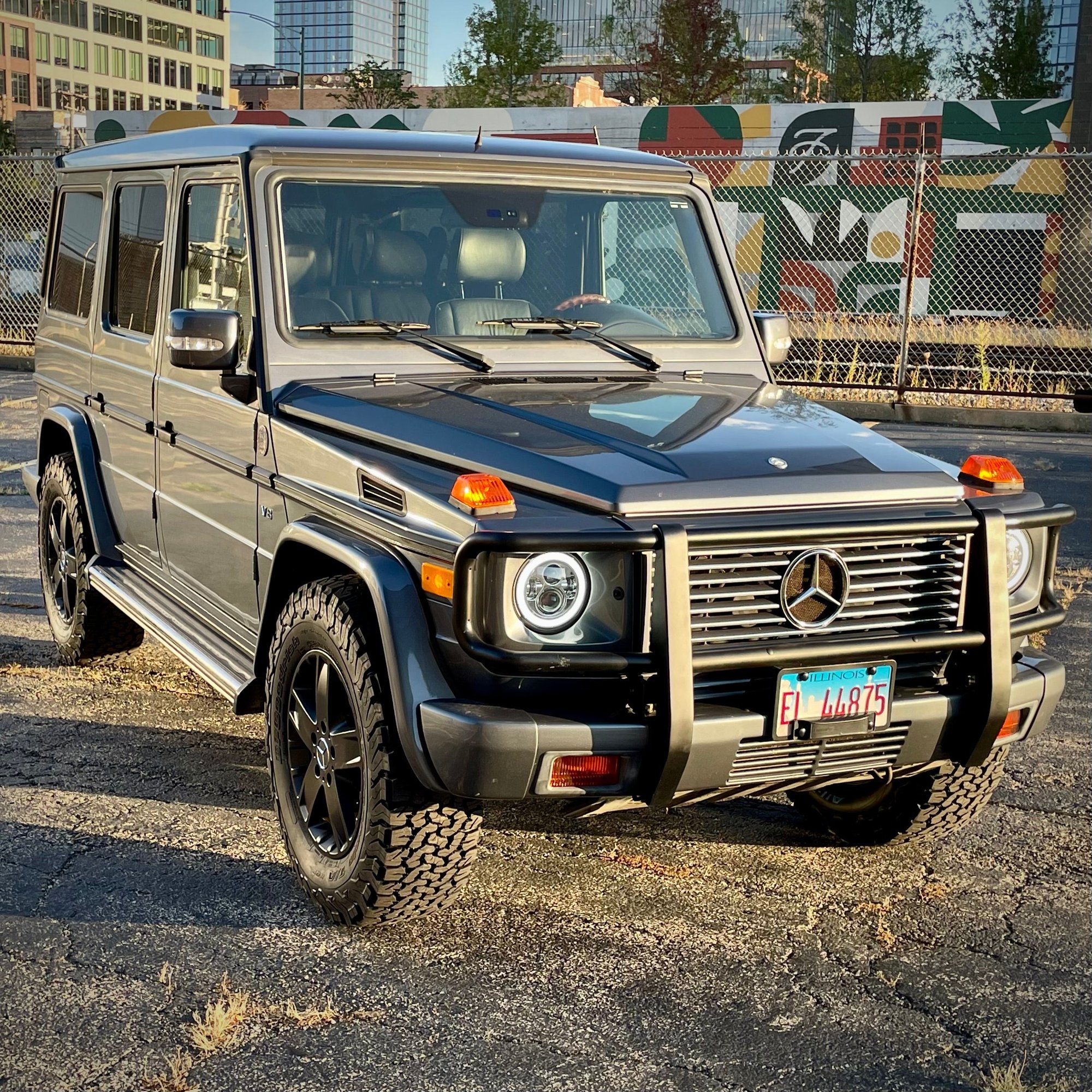

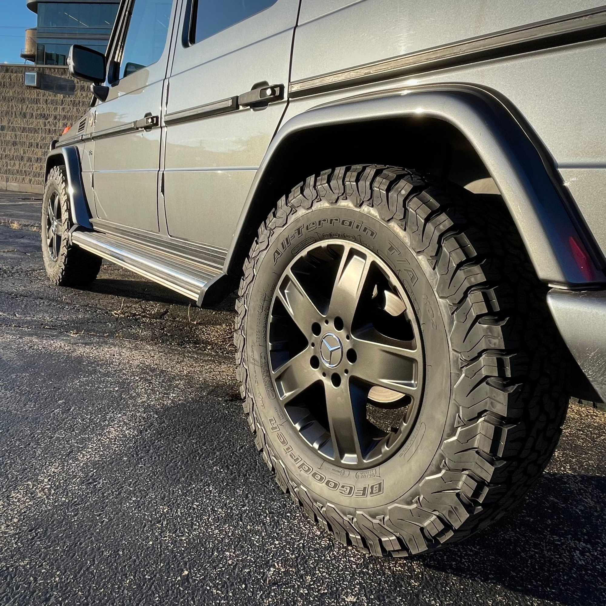

I picked up and mounted my new 275/70R18 BFG KO2s on fresh black powder coated OEM wheels. These fit perfectly with the stock suspension and 50mm H+R spacers. We'll see if I need a spacer lift later this fall when I start hitting trails, but for now, I think she's sitting nicely as is. Cheers

Great color G and the rims /tires look excellent on it...... should you want a bit of lift I'd highly suggest skipping to the JWO 2" springs t get a bit more compliant ride and better handling then the old OEM's that may have some settling... the cost delta isn't that much, and you'll likley want/ wish to do shocks at the same time. with 30k on mine, I'm still amazed at the Koni raid's for the money....

I have those tires on my 2013. No spacers on my model year. I like them well enough but they are noticeably larger than stock. Wheels look great.

The slightly skinnier and taller tire really fills out the fender well nicely with just a bit of poke with the wheel spacers. Fills out the narrow fenders perfectly. What are the size/offset specs on those wheels?

Thanks and I agree... they fit just right with the fenders. As for wheels, these are the OEM wheels that came with the non-AMG G500s in 2004 and 2005.
(18" 5 Spoke - Part# A4634011402, 7.5Jx18 ET63) [Source: https://www.wheel-size.com/size/merc.../#region-usdm]
I don't see too many of these wheels out in the wild so I decided to use them and have these power coated instead of the 18" Ashtaroth wheels (same specs) I also have.
