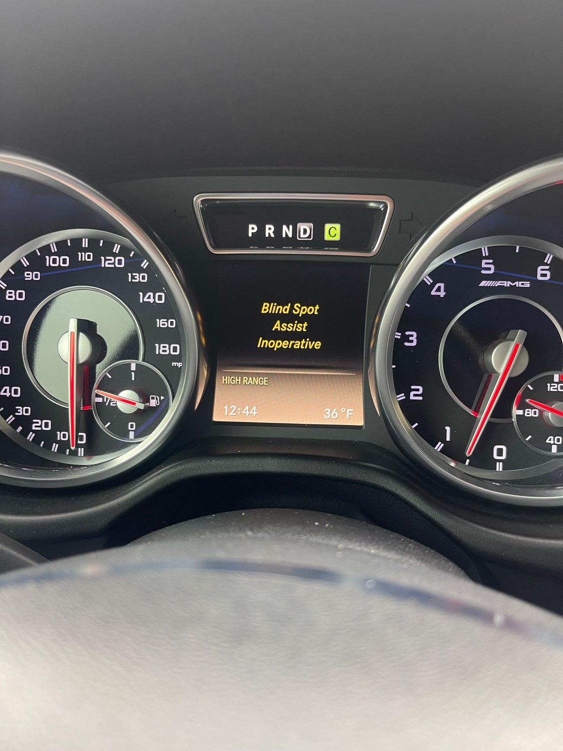

Blind Spot Assist Inoperative
I get this warning light appear in the dash from time to time and usually it will clear on it's own in 60 seconds or less. Triangle shaped lights also appear in the side view mirrors and then go out when the warning message clears. Has anyone else experienced this? Loose wire or sensor?
