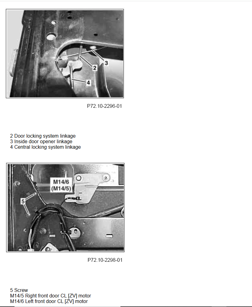

I would open up the door and take a look at what is going on. It could be as simple as the central lock linkage from the motor to the lock came off.
I only have earlier year manuals, heres from a 2010 manual.
Looks like Part 2 goes to the manual lock pull, Part 4 goes down to the motor/actuator.
i just ended up ordering a actuator so that i dont have to remove the door card twice. will post update once i get in there.
