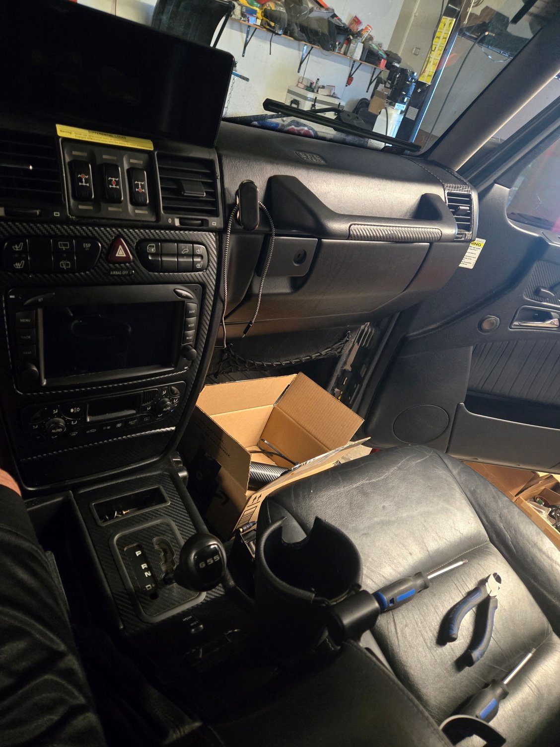

Hello, I am looking to have some dash pieces for my 2004 G55 wrapped to change up the interior look. I have everything out except for the automatic gate section. To remove this I need to get the shift knob off of the truck and for the life of me I cannot get it off. I checked in WIS and online videos and everywhere seems to say to twist the black collar at the bottom of the knob counter clockwise and it will release. I have tried over and over and even marred the collar up using a set of pliers to twist and the black section will not turn. I can rotate the whole shifter 360 degrees with some force but the black collar will not rotate by itself.
Am I missing something?? I tried pulling straight up as well but that didn't come off (although I didn't put all my force into it as it doesn't seem this is the proper way to remove the shift knob.
Anyone know the correct way to remove the stock shifter?
Thank you
EDIT: Finally got it out. It did rotate I just needed a better grip on everything.

You do have to rotate the lower collar. It was very difficult. I wrapped mine in several layers of electrical tape and use pliers on it. It unlocks, I believe a quarter turn, and then the knob slides right off.
Not sure if you can see it, but the bottom collar is a little bit lower (larger gap) because it is unlocked.
Be careful removing the shift pattern piece. Mine cracked in several places, including the tabs, and I had to glue it back together. I originally wrapped mine in a CF vinyl, but removed it and went with a matte black color. There was too much CF vinyl weave going on (with the opposite direction I wrapped mine)

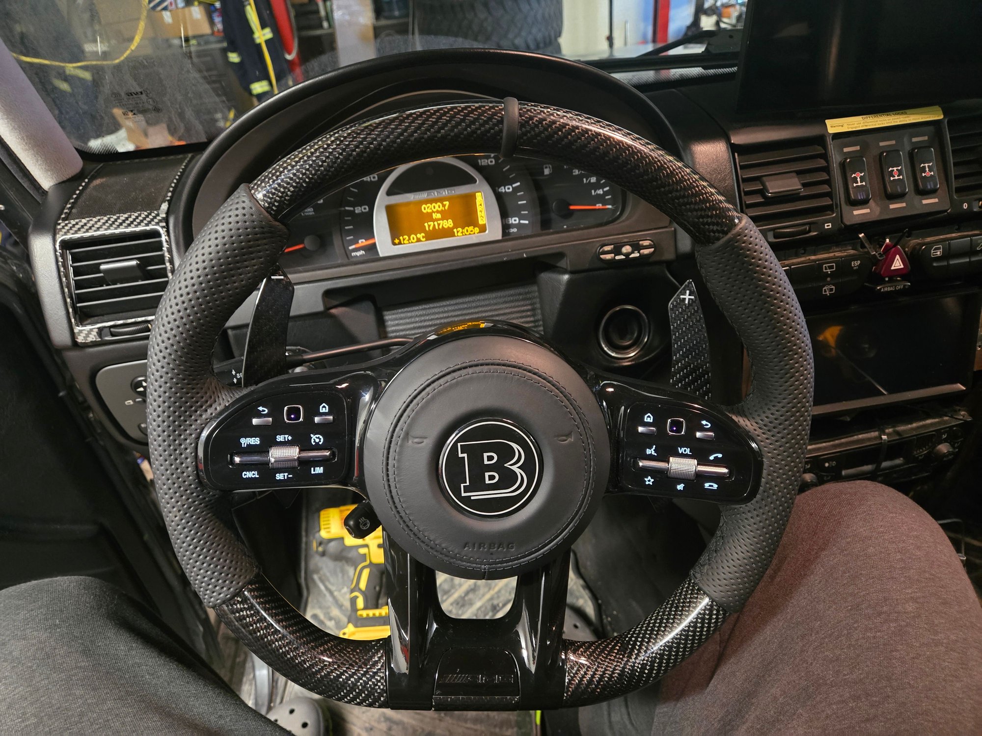

I'll post some pics when I get it done but here's a teaser with my new wheel

Can you link where you got the wheel? Do the wheel controls work? Looks great
I purchased off this site
https://www.pathaftercarbon.com/
I don't see the wheel I bought on there either but I would reach out through the site and make sure you clarify exactly what you want. Took about a month and a half for me to get it but that was during Christmas as well..
The buttons on the wheel do work (although I can't confirm the volume works as I have an aftermarket stereo and po of truck hacked the harness). But the buttons do control the cluster (it's a bit awkward at first but you get the hang of it). The wheel also sits further back then the stock wheel and is a bit tight to the signal and wiper stalks. I had to remove the paddles as they would contact the stalks when turning (I would suggest requesting a wheel without paddles.. I know the paddles definely didn't shift the transmission when in manual mode as I tested this before I ripped them off to make sure I wasn't missing anything).
