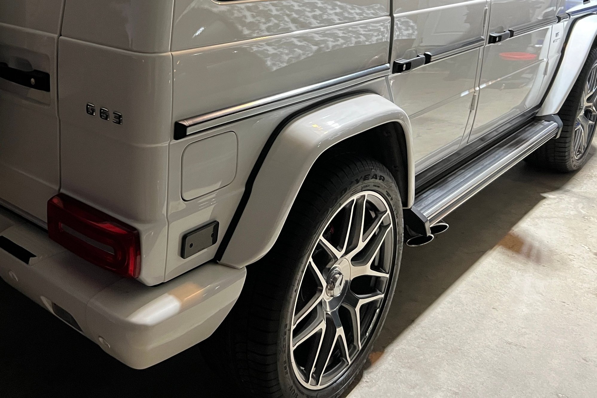

Here’s what stock ‘25 on 295 F1s look on a 2017; no spacers, no rub on full lock and I personally think these are the best looking forged wheels for the G.
I would of went 305s however the tires were near new condition so I’ll hold off until these wear out.

Yeah, those polished aluminum rims are sharp asf and the best fit. An angle pic doesn't do them justice.
