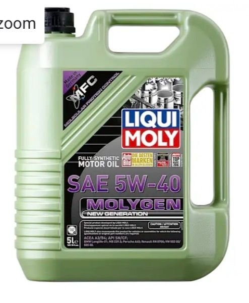

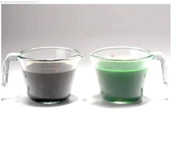

Anyone using Liquid Moly's new green oil?
I'm about to do an oil and filter change, as well as most of the 120k mile B service and was collecting the parts...saw Liquid Moly's has a green oil that they tout as "new generation" and describe it as a Molecular Friction Control. Has anyone used this? Is it even authorized by MB? I know they can be strict with stuff like that. Any thoughts will be appreciated!
I forgot to mention, that it's for my 2013 G-550!

I’d personally still stick with Liqui Moly Leichtlauf High Tech and Ceratec. Molygen has been around for years, but I tend to prefer the more proven Euro-spec formulations for these engines rather than the “MFC/new generation” marketing angle.

Read my posts with pictures on how ceratec will destroy this engine. This is terrible advice. TERRIBLE. As a NEWB, welcome, but, you might want to hold back on commenting until you know the proper specs to advise. (original GDI oil spec is outdated and dangerous and DIRTY)
LM is a marketing gimmick. Use ONLY SP rated oils and NO additives. Ceratec will clog rings, increase blow-by and deposits on valves in this gdi engine.
OP, this oil is not SP rated...PASS
Find a 5/40 or 5/50 such as Motul, Amsoil, Castrol, Pennzoil, or Mobil1. Make sure to buy new stock and make sure the API seal on the bottle you receive says SP.

is the Liqui Moly that says "Leichtlauf" a ceratec oil? I can't find that term on the bottle nor the product description. I see that both the blue and green bottles of LM are MB 229.5 approved.

Both Liqui Moly options I'm looking at are MB 229.5 approved. So I'm confused as to why you say to avoid them. As a newb myself, I'm not familiar with "SP", "API", and "GDI"...I'll be looking that up soon with Gemini 😁

I used molygen on my G63 and even used it on my C63 when I had it. I like that you don't have to use ceretec with it. Never had an issue with it.

The Molygen New generation SAE 5W-40 pictured above appears to meet the MB 229.5 spec so I see no reason not to use it if thats what your engine uses. Try it out and see if you notice any difference.
