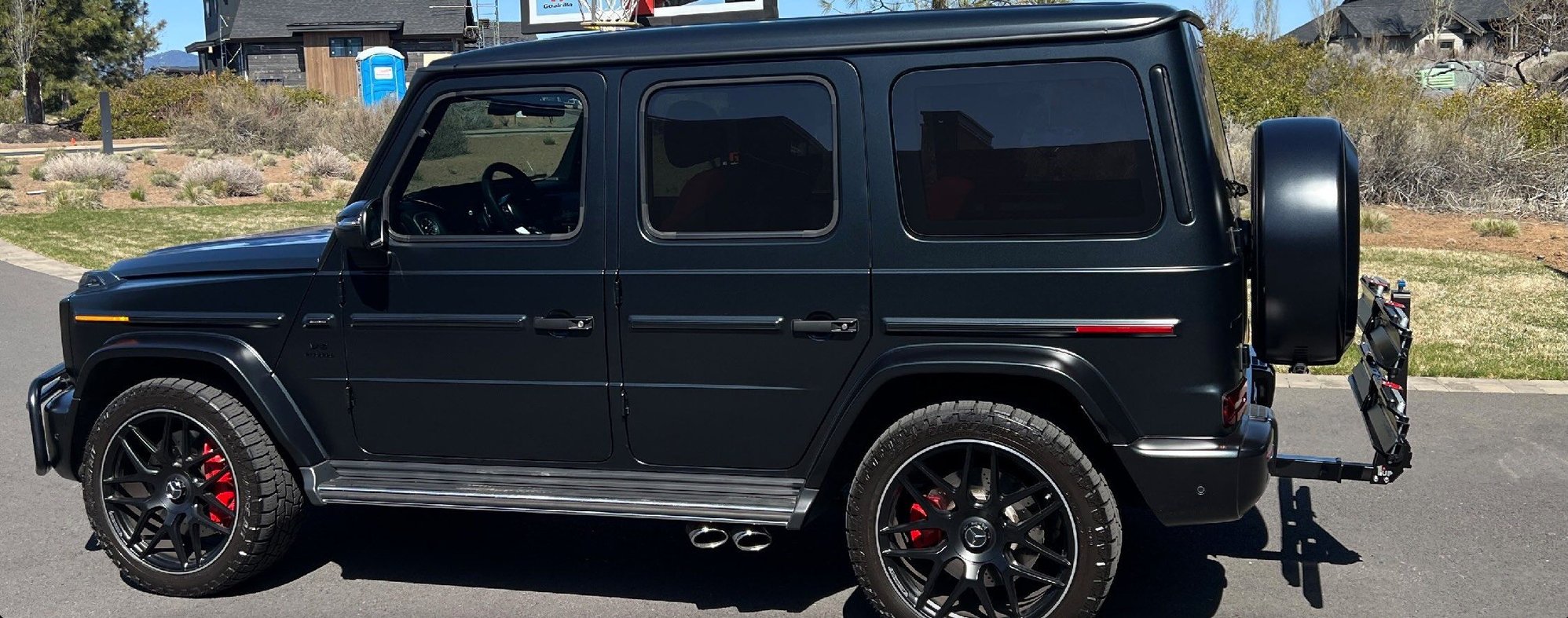

Thanks for the options! I'm leaning towards hitch mount because of ease of access on the G. Looks like the Yakima full swing mount is a great option for the G. I will post once I install

I installed a 12" extender from Harbor Freight this weekend to help my 1Up 3-bike rack clear the rear wheel. The 1Up 9" extender had the rack just BARELY making contact with the wheel cover. My question is has anyone found an hitch extender that fits snugly into the G-Class hitch? The 1Up was really nice, snug with a screw bolt to make it more secure. The Harbor Freight one was super cheap but is also fully loose in the hitch. Any suggestions on a solid fitting one?

The 1Up 9" extension unfortunately did not work. Optimally we need like another 1 or 2 inches. The issues isn't with the rack in use (see photo) as the spacing with the bikes mounted is probably 3-4" but with the rack closed in the 90 degree setting it touched the rear tire cover. Now, if you wanted to run the rack empty at the 45 degree angled setting sticking further out you could probably get away with it from my memory. I had to use it quickly so I grabbed the 12" hitch extension from Harbor Freight, I may look for a 10-11" extension online for this Spring just to tighten it up a bit. Here are a couple photos of the fit.
