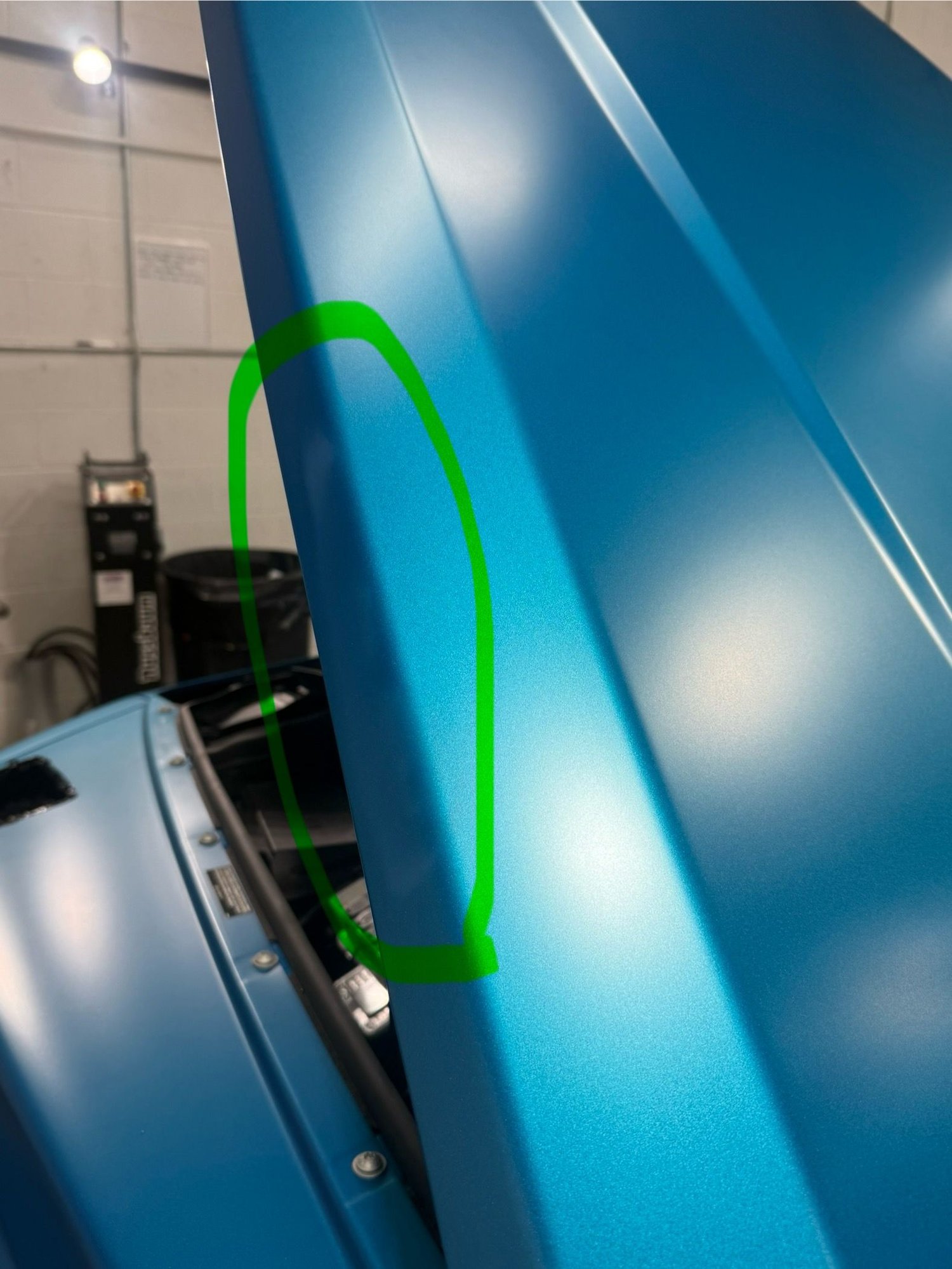

picked up our 2026 G63 last week. Detailer that is doing full PPf called us today to let us know there is a blemish on the drivers side hood. Thought I did a good walk through at pick up but I guess I didn’t catch it. Not sure what to do? The detailer already has all the trim pulled off.
Great news. I had the PPF removed on the hood and the dealer used the heat gun that was mentioned and the spots came completely out. If you pick up a Magno color make sure you check it out really good before you have it PPF

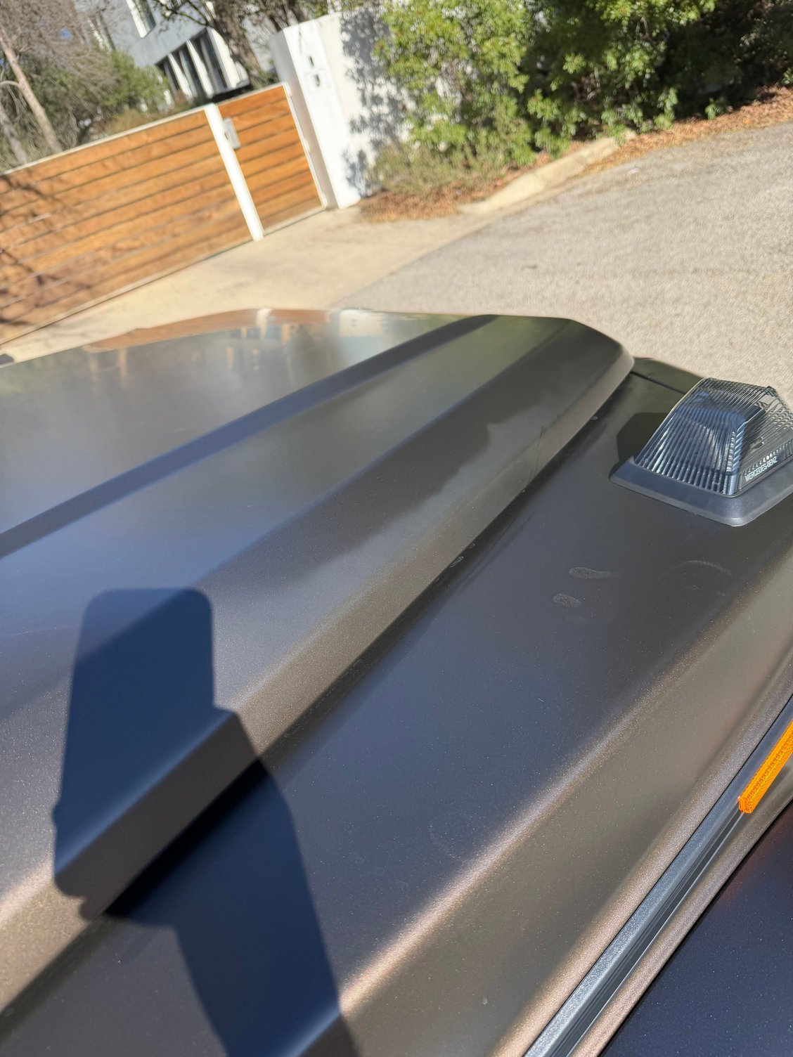

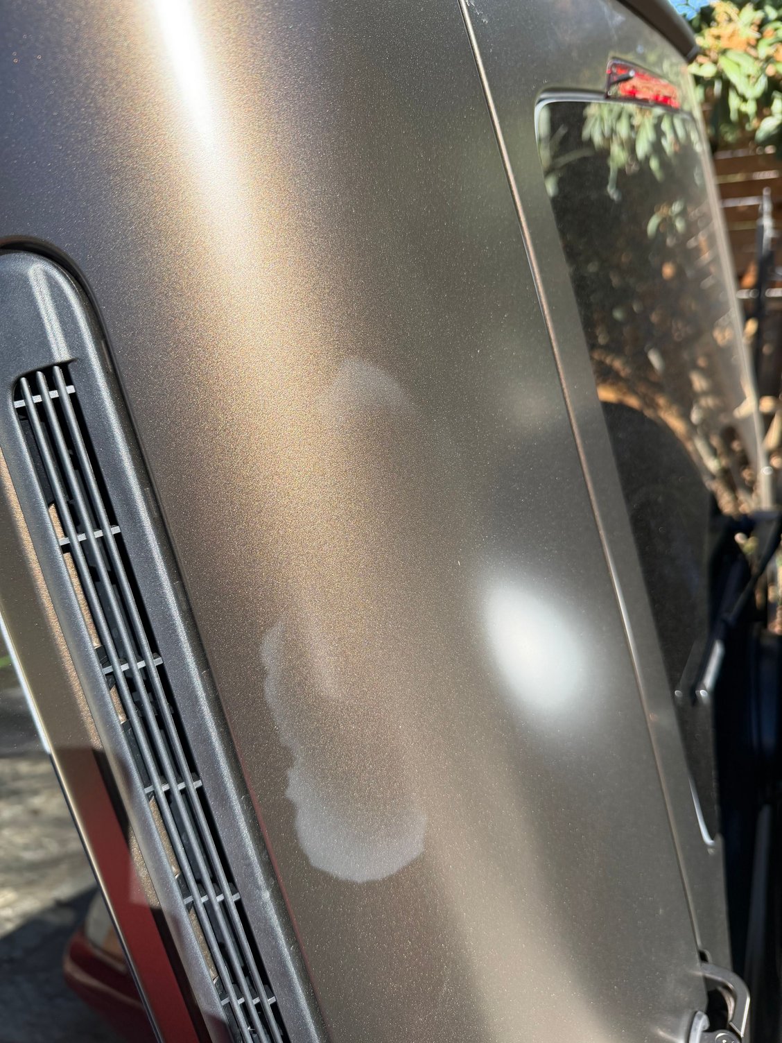

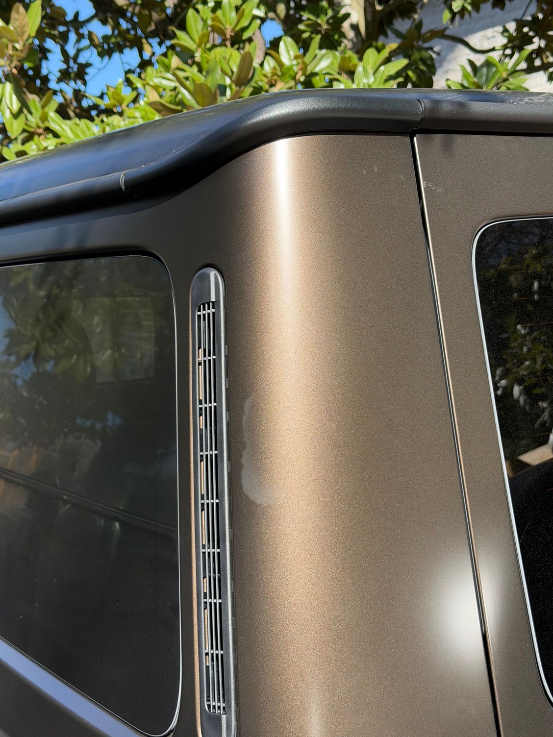

I took delivery of my 2026 G63 black magno last month and have almost identical spots. Was wondering if you got a resolution yet? My sales guy escalated it through corporate last month, nothing yet. I just made my own claim yesterday to hopefully expedite the process. Unfortunately the defect on mine appears to be on nearly every panel/roof/hood. I'm pretty disappointed and not super confident they are going to make it right.
Originally Posted by factoryKITTED
whatever happened with this?
I took delivery of my 2026 G63 yesterday and have the exact same issue on my Dakota Brown Magno. I noticed a few small blemishes on the hood at the time that I picked it up from the showroom but I thought maybe it was hard water spots or something. I mentioned it to my sales rep… documented it and reported it. The sun was shining this morning and of the blemishes are very obvious. I will be calling the sales manager tomorrow…unacceptable for $250k vehicle.
