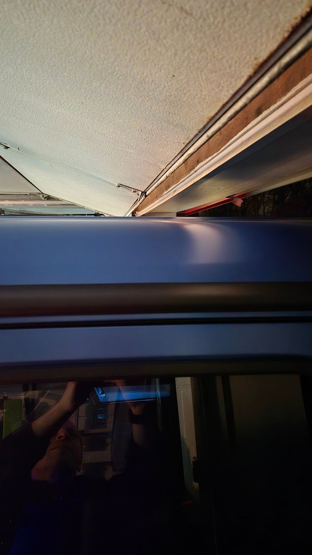

I never thought this would be an issue since the garage in my house is pretty big. I'm expecting delivery of the G580 tomorrow so I went to measure - the garage opening is exactly 80". With the way the garage door hangs, I have just a hair under 79". It's going to be close.

80 inch (standard) garage door opening. 79 inch clearance with the door. It fits but with virtually no clearance. I can fit a piece of paper between the car and the garage door but not a magazine.
