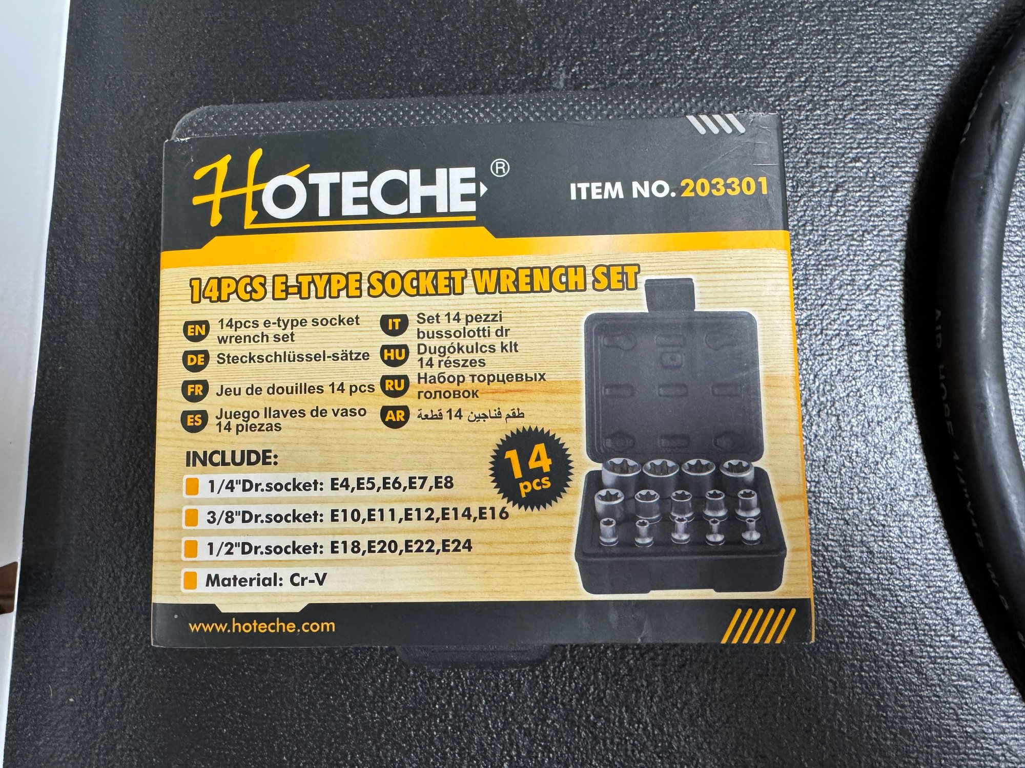

Originally Posted by 2023G63
Hello,
I have a Fi exhaust on the way for my g63. I was wondering if anybody has installed it themselves rather than taking it to a shop. I have heard it is pretty straight forward but there aren't any instructions included so wanted to see if anybody has any guidance. 50/50 right now on if I want to install it or just let a shop do it.
Thanks for the help!
It's easy. One clamp at the front to release it from the secondary downpipes (that clamp requires a large star socket like the one pictured here), drop it down enough to unclip the wire from the actuator (might need a pick to get it to release), then slide the whole thing forward to get the rear hangers out of the rubber bushings on the frame side. Unbolt and swap the actuator over to the Fi system (I think it has to be clocked 90*, but there should be instructions in there that state that), and then reassemble. It helps to have a moving blanket to set the exhaust on when you lower it and when you are putting the new one on. Having another to person to help isn't 100% necessary, but will likely save you some frustration when you need a 3rd hand.
