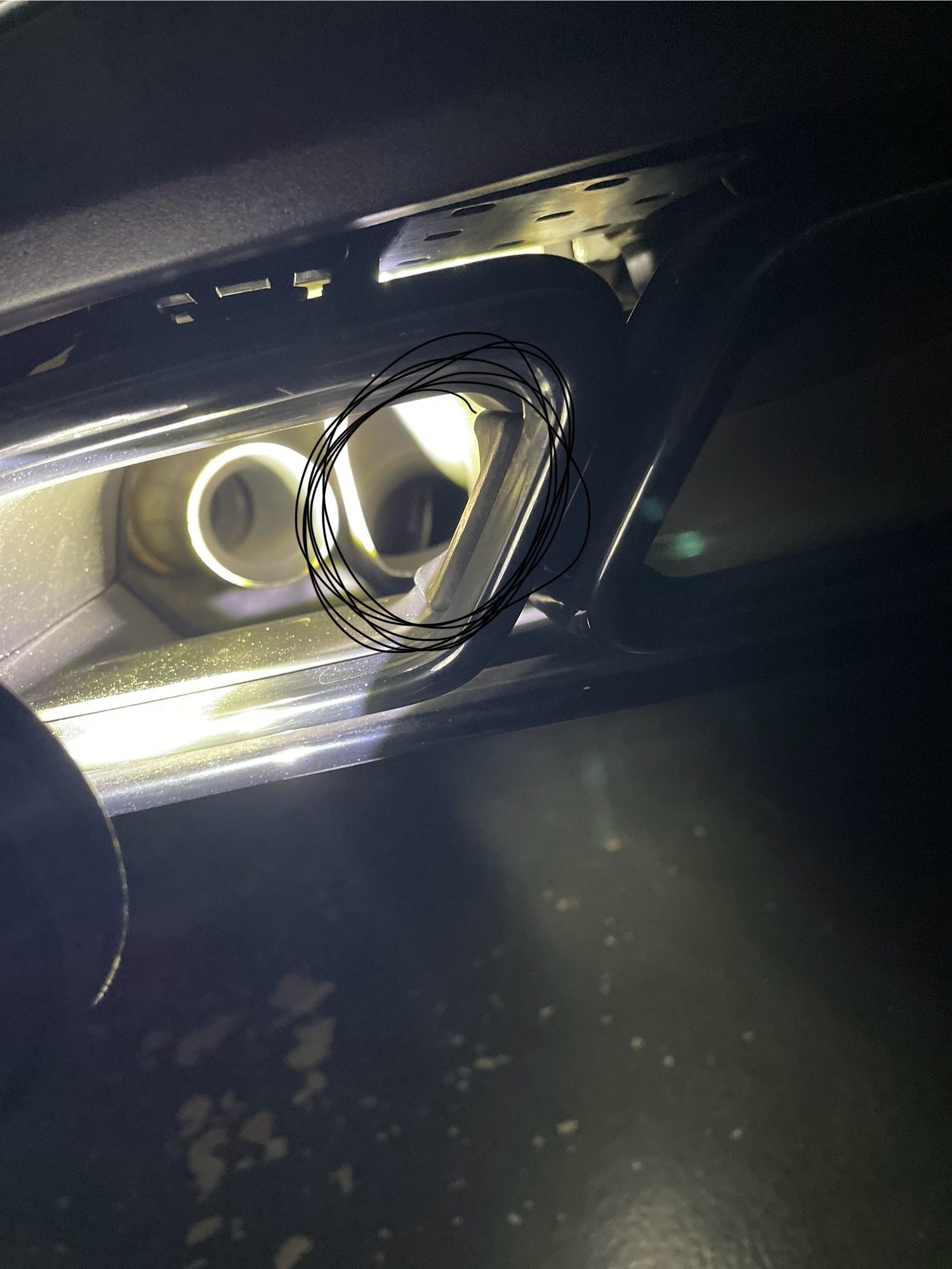

I'm at bit confused when you say that in sports+ mode that the exhaust flaps open fully only if the rpm's are high enough.
I drive my car all the time in sports+ mode with the stock exhaust button on and when turning my car off in the garage, the car is at idle and i believe with the pic i've provided below shows the exhaust flaps are fully open.

Thanks for the image, I appreciate it. They might had changed the behaviour during the facelift or just later model years of the G-wagen hence why Akrapovic did what they did. In the past, idle is noticeably louder on idle with an EVM outside in sport+. Is this an OPF equipped exhaust? Thanks again for the insight, glad to be corrected and that no more EVM is necessary.
I forgot to ask, is the engine warm or this is cold start?

Sorry as i just realised that this thread is regarding a G63 as i have a pre facelift 2016 c63s coupe.
Anyway, to answer your question if this was a warm or cold start, pic was taken 4 days after my car was driven in sports + mode and car yet to be re-started.
My point here is that pre face lift cars in sports+ mode open their valves fully all of the time as well as at idle as that was how my car was last operated at before taken the pic.
