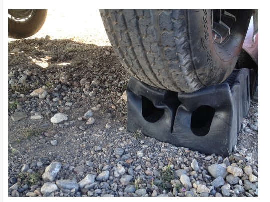

Harbor Freight's 3 ton trolley jack works well on my G and other cars. I also have a set of post and pin jack stands -- safer than the lever release type. When I need to be under a car, I use 2 or 4 Rhino Ramps, because IMO trolley jacks and jack stands are not trustworthy, even when used in tandem.
Buying cheap tools I'd probably be worried too. But to trust plastic ramps over a quality metal jackstand, can't comprehend.
Rhino Ramps are rated 4,000 lbs each -- 4 of them support 3x+ the weight of the car on the car's tires. Heavy duty versions support twice as much. Jack stands require placement somewhere on the vehicle's chassis or frame that's stable and compatible with the jack stand's cradle, and they can shift as you sequentially place them. I use jack stands to do brake fluid flushes when I need to pull wheels, but prefer the ramps when I'm underneath.

The plastic ramps scare me also. Just go get some 2x12's and make ramps from solid wood. Lowes and Home Depot will even cut the boards for you, just bring them home and nail them down together. I used old scaffold planks I found being thrown away.

Car ramps aren't made from recycled coke bottles. Read some reviews before dissing them.

No dissing, just personal preference. Being hollow is what scares me. I feel much safer using solid wood planks stacked on top of each other. I even use large scrap pieces of timber instead of jack stands most of the time since it seems much sturdier on my gravel parking area. Even on pavement i've had the feet of jack stands sink in on a hot summer day.
I was just pointing out how easy wood ramps are to make yourself. Can make them any size and length you want. My wood ramps are only two planks high though I cut longer pieces that I can simply nail on the bottom to make them higher if needed then when done just take it apart.
Harbor freight tests their jackstands too. Did you get the recall for them? j/k To each their own. Plastic is cheap, weak and doesn't hold up long-term especially in the sun. One benefit of steel ramps is as you mentioned there is more clearance moving around underneath. But they are heavy and the price is more than the rhino ramps. I've had the plastic rhino for my Corvette and yeah sketchy and to your credit they did work. Still alive to talk about it. My 5,800 lbs empty land rover, no thanks. The Corvette was ~3,150 lbs.

Plastics comprise a broad collection of polymers, some of which are stronger than steel. Characterizing all plastics as weak, cheap and non-durable is inaccurate. Plastics are alloys and are formulated to suit target applications just as metals are. The quantity, variety and uses of plastics in your automobiles are greater than you might suspect.

Plastic vehicle supports are stronger than steel, yeah I doubt that. If you needed to stand under a Prevost bus on jack stands, would you pick plastic stands made with a broad collection of polymers or or stands made of steel?
