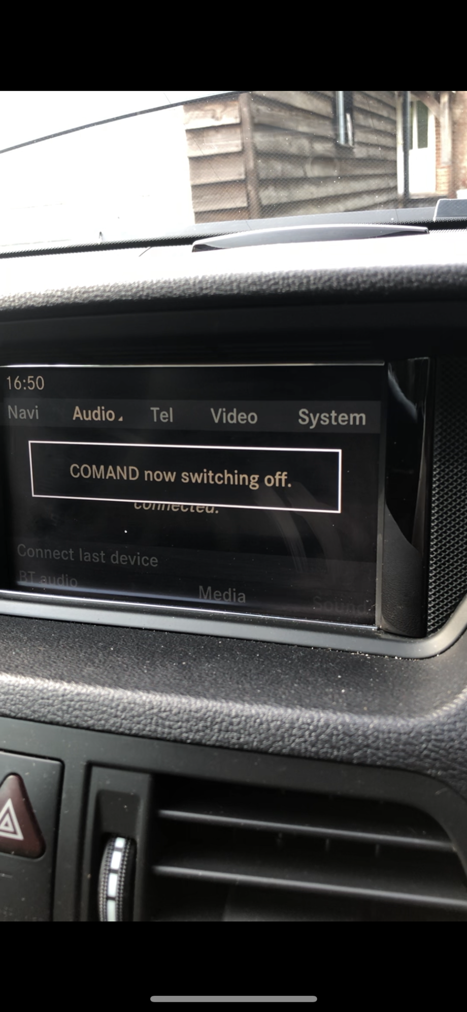

My E-Class 350 but I believe would be similar in other models started to shutdown my radio and then proceed to do 80% of all other systems.
The issue only starts once the ignition is fully on
The car also runs with no issues so I believe the Fuel Pump short is likely to be an old uncleared fault. But this might not be true.
The SRS alert came on and was permanent on my dash. (Think this is the case till it clears)
Normally its always the Comand system that shuts off first. Then the Presafe warning comes up on the dash and the rest of the systems fail to work.

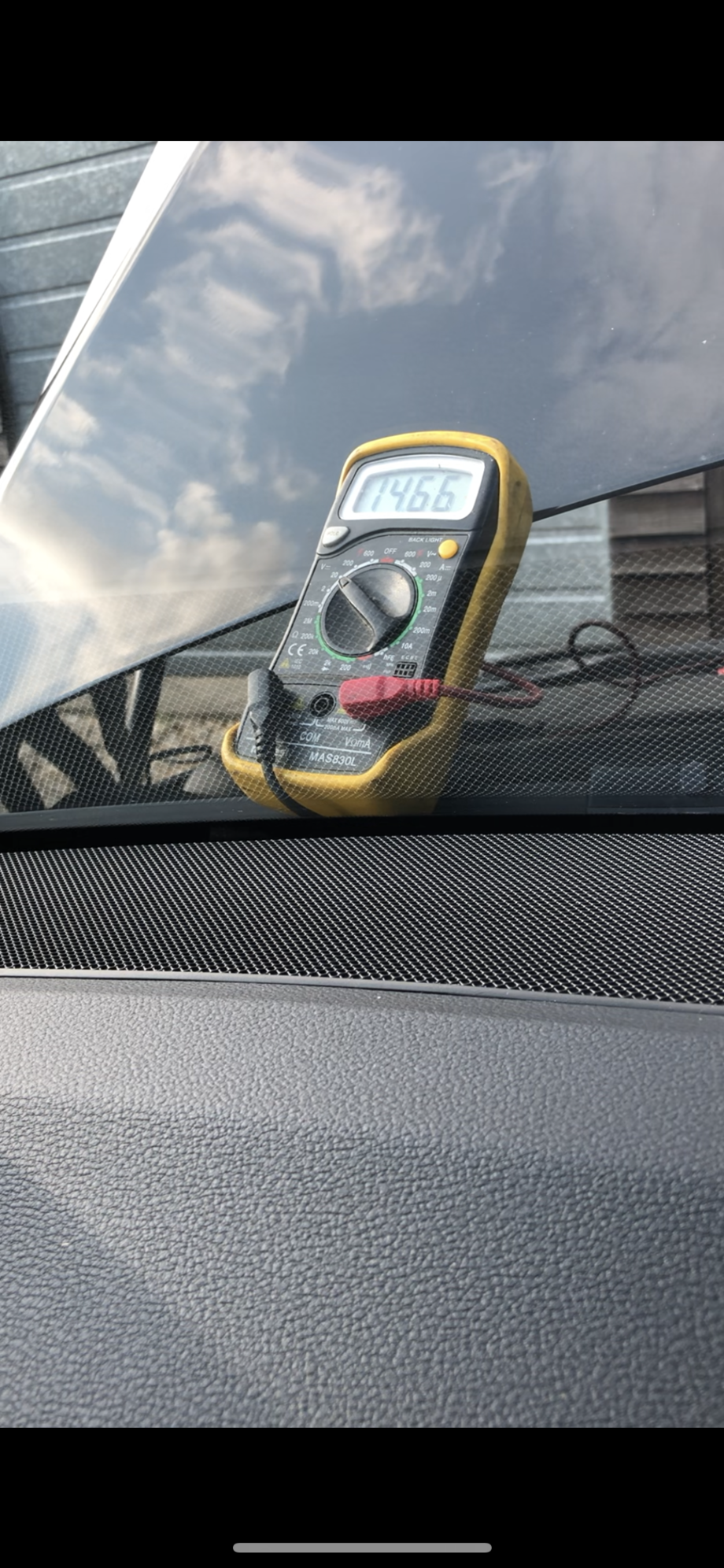

The Dash showed incorrect voltages 15v and as low as 7.5 and the car was charging fine at 14.66

This put it to either the Rear Sam or the Negative battery lead. Due to cost and ease and assuming the rear sam was working as it should as it was telling equipment to shut down and thinking it was low on voltage I bought a Negative cable (with sensor) and replaced it. (10 mins max. Mostly finding your spanners!)
Once replaced instantly the Voltage read 14.7 on the dash not 15 and varied correctly on start up to the volt meter. I have driven it now for about 8-10 hours with not one failure. I hope this article helps some people if they get this fault.
