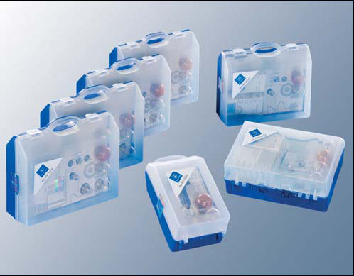

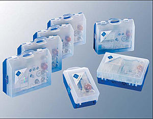

Here's an even better place.
p/n for GL is B6 681 0022 and you have to source from Europe.
Any leads on where to source the kit?

'10 CL550, '12 GL550
http://www.speedautoteile.com
