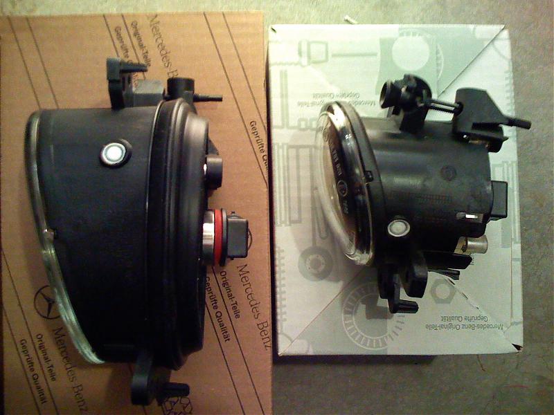

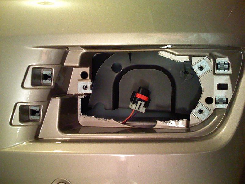

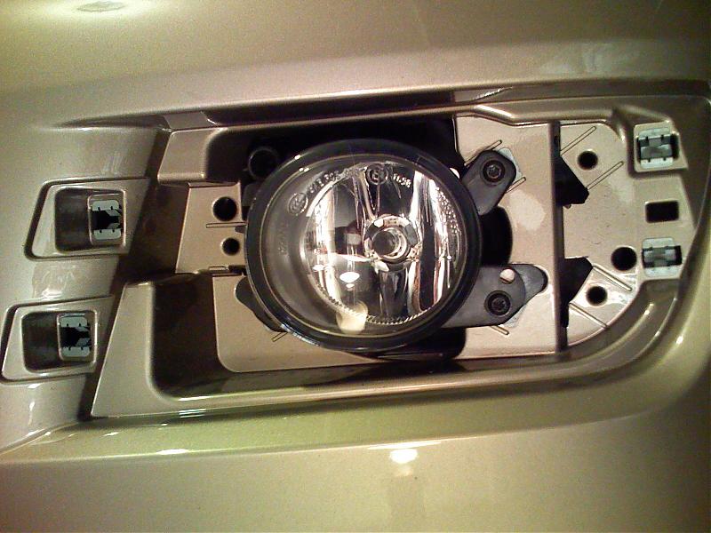

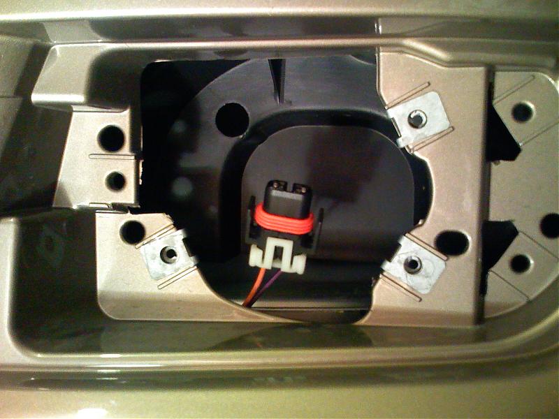

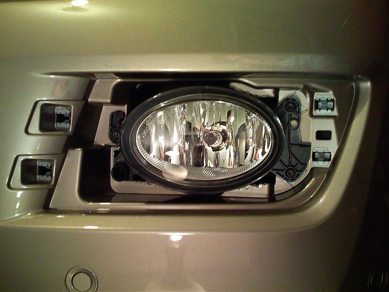

Chrome Fog Lights Installed - PICS #1-5
The operation of replacing the all-black fog lights with the chrome ones is pretty simple. First two pictures are a side by side comparison of the fog lamps and fog lamp covers (sorry for the pics quality, but I could not find the camera charger quickly so I used the iPhone). Here are the main six steps:
1. Remove the all-black fog lamp cover by pulling with your hand (no tool is needed for this step) from the side closer to the front wheel. The cover has a somewhat tight pressed fit, but is a non-destructive removal so pull until is released and it will look similar to pic #3 (after removal it can be re-installed by pressing its tabs in the bumper latches if you change your mind).
2. Get your TORX screwdiver set and take #25 to remove the three screws that secure the fog lamp. After removing the screws disconnect the connector attached to the fog lamp bulb by releasing the two side clamps (if the fog lamp body mass is pulling on the wires and makes it difficult, you can try detaching the bulb from the fog lamp by twisting its base counter-clockwise, after which it will be easier to disconnect the connector). See pic. #4.
3. Remove the three metalic clips that act as screw taps.
4. Trim the bumper around the fog light to make room for the new larger cornering fog light. The wall is very thin so you can use some cutting pliers (that is what I used), or a Dremel or small jigsaw if you want a cleaner look (watch for the small debris and fine residu particles) and attach the three metalic clips in the outer holes. See pic #5. This is the POINT OF NO RETURN, because after the trimming operation the old round fog light cannot be attached to the bumper anymore due to the original holes removal.
5. Attach the connector to the fog lamp bulb and secure it to the bumper using the original three TORX screws. See pic #6.
6. Attach the new chrome cover by pressing it in the same latches as the all-black one. Pic #7.
While they are called cornering fog lamps, the installation and part numbers described here DO NOT provide the cornering function. This is a cosmetic only upgrade.
The longest operation is triming the bumper and overall it is a 1-2 hours job for both sides.
There is a fog lamp adjustment screw, but I could not see too much difference after playing with it for a few minutes.
Here are the part numbers:
L & R Chrome Fog Lamp Covers 164-880-07-24 & 164-880-08-24
L & R Fog Lamps 169-820-15-56 & 169-820-16-56
Please let me know if you have any questions.

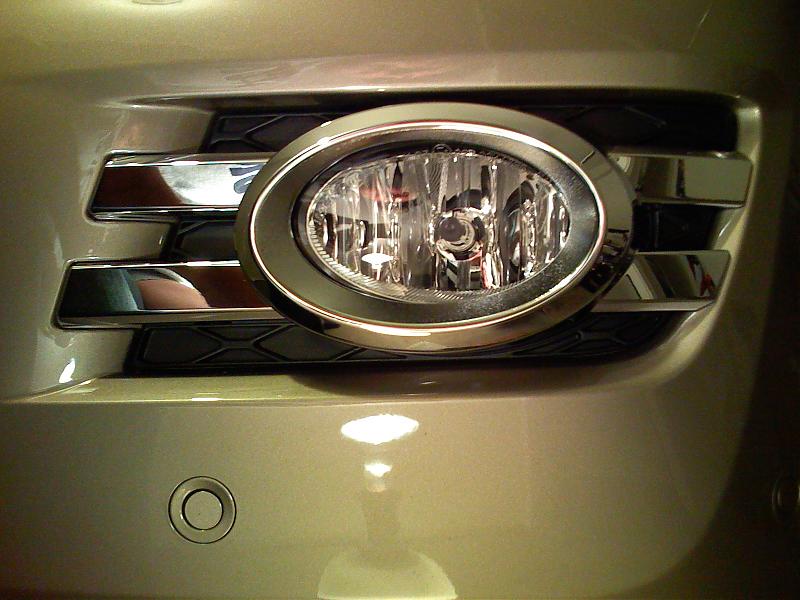

Chrome Fog Lights Installed - PICS #6-7
Here are pics #6 & 7 for the posting above.
