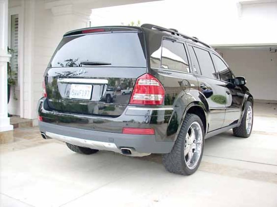

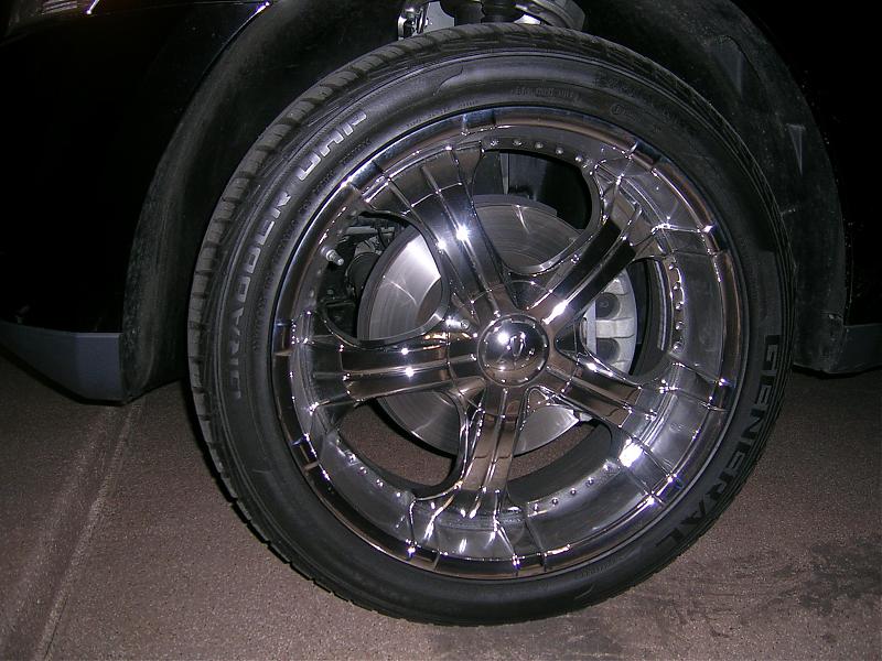

I bought my '07 GL 450 and the dealer had installed the Zinik Z1 Shogun Wheels 295x40x22..they look sweet but are you guys saying there's a problem? See pic. Here's a link to the rims..
http://www.1010tires.com/wheel.asp?w...odel=Z1+Shogun
Thoughts? Thanks,
Jeremy

BlownV8, should we try another one? Speedometer will be reading approx 3% under the actual speed you are traveling. The good thing, if you don't get a ticket, is your waranty will last 3% longer. 660 revs per mile with 22 inch tires versus 680 -685 revs per mile with standard oem tires.

According to the Tire rack, his OEM tires were 275/55/19 Continental 4x4 Contact that do 721 revs per mile. The General UHP do 660 revs per mile. That's a wee bit more than 3%. Ouch!
Leo taught me not to rely on the manufacturers sizes, aspect ratio and rim size, to determine the actual size of the tire.
I compared against oem 18's. How did you know he had 19's, just curious. Anyway I agree with the Ouch!

He has the front and rear stainless skid plates. Those come with the 19" wheel package.

My wife is typically at or under the speed limit...lol Interesting to know about the 3-4% for when we drive to CA and I set the cruise to 84mph (when we are really going 87). Thanks for the heads up---I would've thought the speedometer would be set with tire inputs in this day and age....but what do I know.
