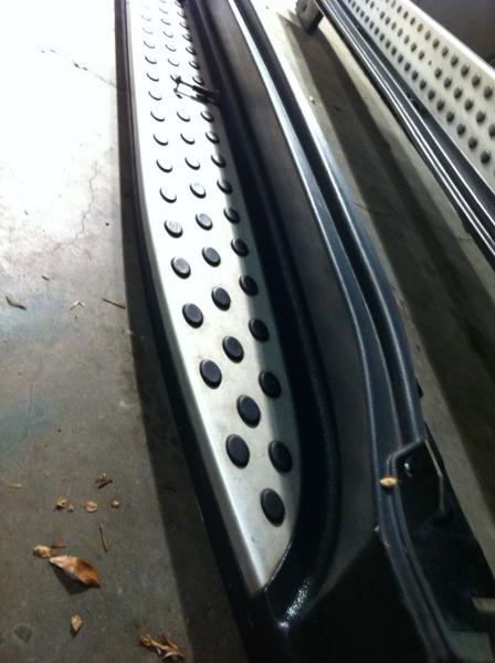

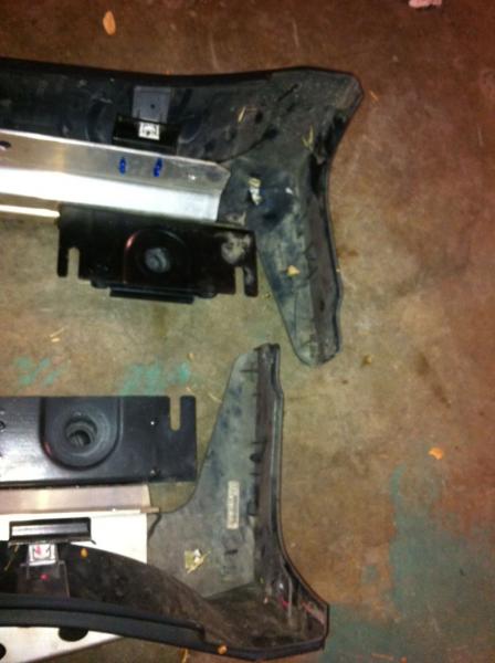

Pics so you can determine their worth to you.
To keep this somewhat of a writeup, the aluminum rails on the first picture are the underlying structure that hang from the side of the door sill on protruding studs. The plastic strips cover up the underside previously covered by the plastic rocker panel.
Picture five shows the rear jack pad extenders, as seen from above. The slots in them allow the whole rail/jack pad assembly to slide onto the door sill studs from the side. The slots match up with downward pointing studs on the rocker panel. Simply remove your jack mount center plastic knob with a screwdriver, then pop the mount from the car. Put the jack pad onto the extender facing same way it was facing on the car, and cover up the hole left on your car with the supplied grommets. The plastic rivets and double plate clamps both sides of the rear fabric wheel well lining.
My passenger side took a rock hit, and has a foot long scuff on it but the metal is still in place. About a 4" rip in the plastic at that location. MB will sell you just the plastic piece for around $250 or a body guy can buff/plastic weld it for less.
