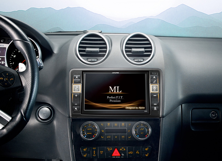

If you go aftermarket, this is the unit: Alpine X-800D. The rest is cheap Chinese crap.
On the market in EU only, and pricey. around $1800-

That's very cool! Do they have the GL, or maybe some day?
