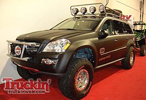

Thanks for looking. This will be my first winter with the GL550 - last winter I used my ML55. I know the OEM rims/tires are garbage in the snow - I wanted to find something more beefy - similar to this picture (not as aggressive). I'm having a hell of a time finding smaller RIMS - any suggestions?

Thanks. I'm looking for smaller rims, bigger tires. 20" + snow is not good.
Erik
