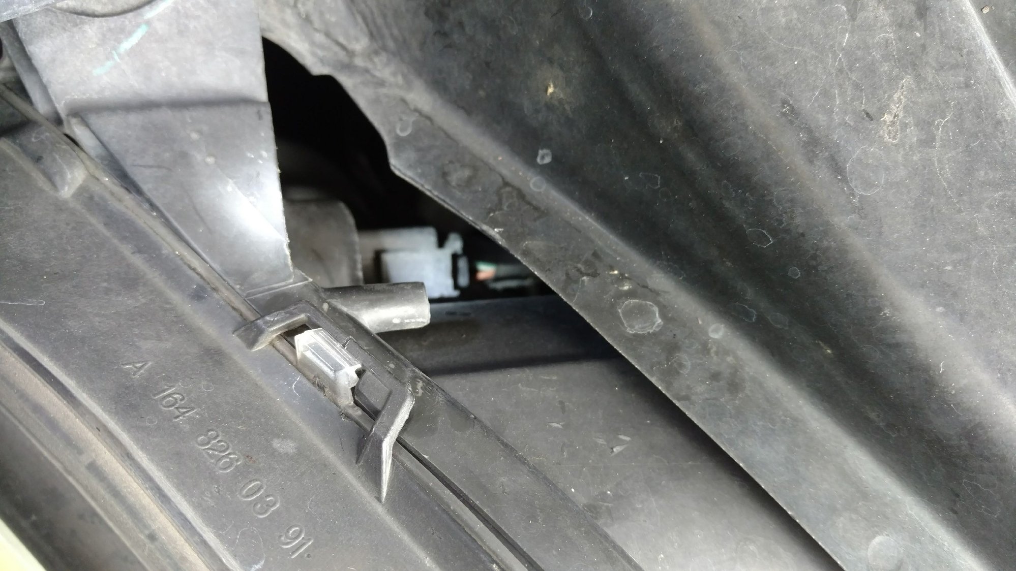

That is the bulb I can not get loose.
I am trying to replace the marker lights on the outer edges and the running light in the middle. I can grab the wiring and I got the clip out but I can not figure out how to pull the bulb out of it. Is there a simple way to just remove the entire assembly?

There is already a thread on this; the answer is long needle nose pliers.

I tried that unless I am not pulling hard enough with the needle nose do they need to be turned then pulled like the low beams? I searched I am hoping I do not need to pull the entire assembly out but how else do I get to the marker lights?

Yes, I believe you need to twist it as you pull. It's certainly not the easiest thing. I did it a year or so ago, and went to do it again, and it was just as much of a pain the second time around. Next time I'll install LED so I don't ever have to change them again.

Yes, owners manual says counterclockwise turn, just like the others. Should not need to disconnect wiring

I did not even think to look at the manual I will make sure I do that next time before wasting your times guys! It was tough to get my hand back there but I was able to turn it a quarter turn counterclockwise and it pulls out of the shaft.

Back on thread topic: The little clips that hold the bulbs in are insanely finicky. I found the high beams pretty easy to deal with, but the low beams are awful. If I recall correctly, the wires need to end up emerging from the lower part of the plug; you start with the wires about 1/8 turn counter clockwise from the bottom and twist in.
