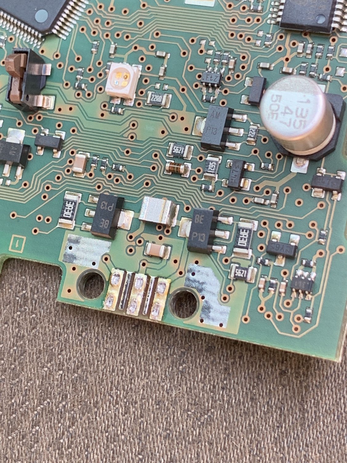

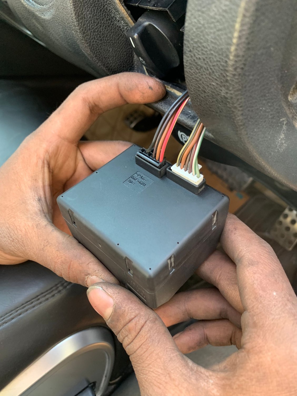

Old Feb 19, 2023 | 05:51 AM
Mansoorat007's Avatar
Joined: Feb 2023
Mercede Benz GL350
Works fine with this solder…

just open the ELECTRONIC IGNITION SWITCH
SOLDER WHITE socket to the board
and issue is fixed

I’ve been traveling a lot lately and just saw your post; the symptoms you described is exactly what I had due to failed connector solder joints. You can thank the lead-free solder that the PCB industry has moved to. It’s good for the environment but frequent poor quality and workmanship issues.
It’s great that you found the problem and saved yourself more hassle and at least $1k.
