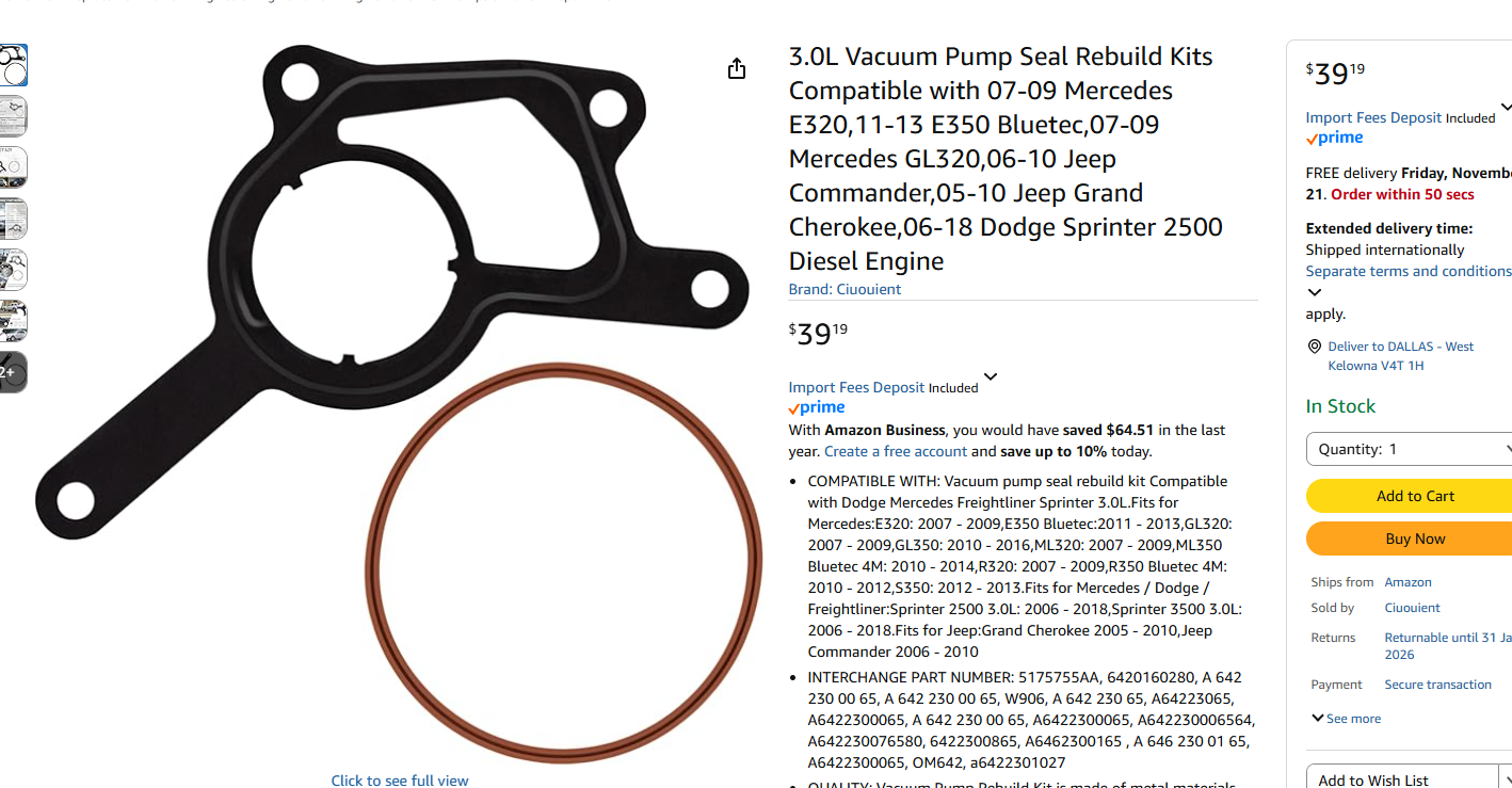

Oft overlooked
Don’t neglect the vacuum pump, can leak profusely. Pump to head gasket readily available but rarely the issue, the front cover on the pump is more likely to leak and no seal is available so you’ll need to improvise with some gasket in a tube.
happy leak hunting

The reseal kits are available online everywhere. It comes with both seals.
